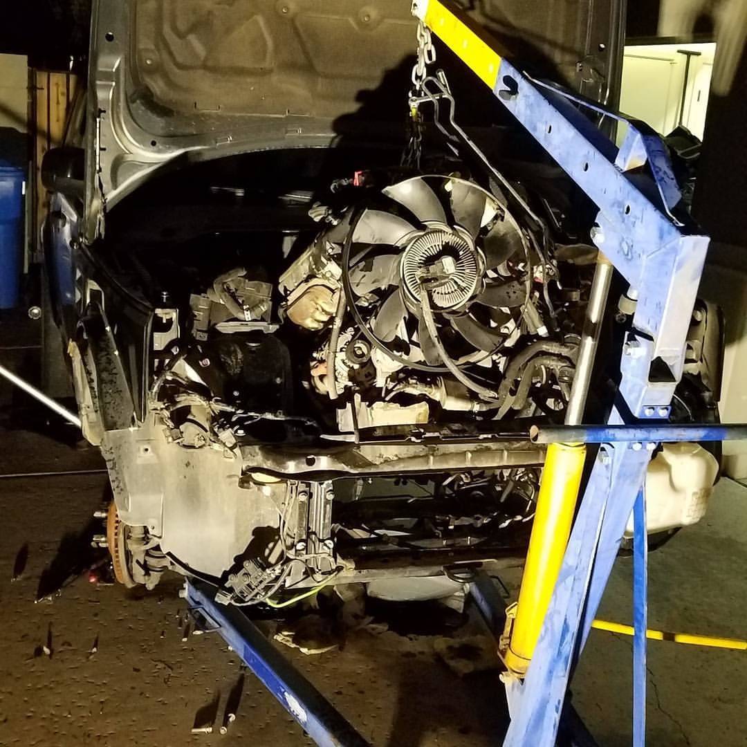

I got the LR3 engine/trans/transfer-case all pulled at once with enough effort. It's possible without taking the cab off but definitely takes some patience since it's a tight fit. Tips are to remove engine mounts and steering column to make it easier.
With that out of the way I ended up selling the transmission for $700 which brought the price of the LR3 down to $1300 at this point.
Next up was pulling the LS out. No pics of my actually pulling it but it was straightforward.
After both engines were out I took some measurements to see how similar they are.
The AJ sits at about 26" wide while the LS sits at just over 19". Good news for me. All of the other dimensions are nearly identical as is the OIL PAN location! Which means the LS truck oil pan is perfect for the swap.

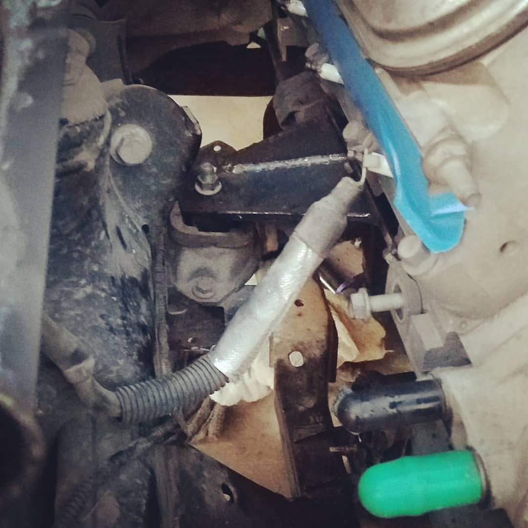

I made some simple flat steel engine brackets and re-used the OEM LR3 rubber mounts. This made it super simple to install as well as kept the custom parts to a minimum.
And if you're wondering about the front diff clearing? It JUST clears.....again blown away since the LS truck oil pan has a casting cutout to almost looks like it was made for this swap. Lucky again.
