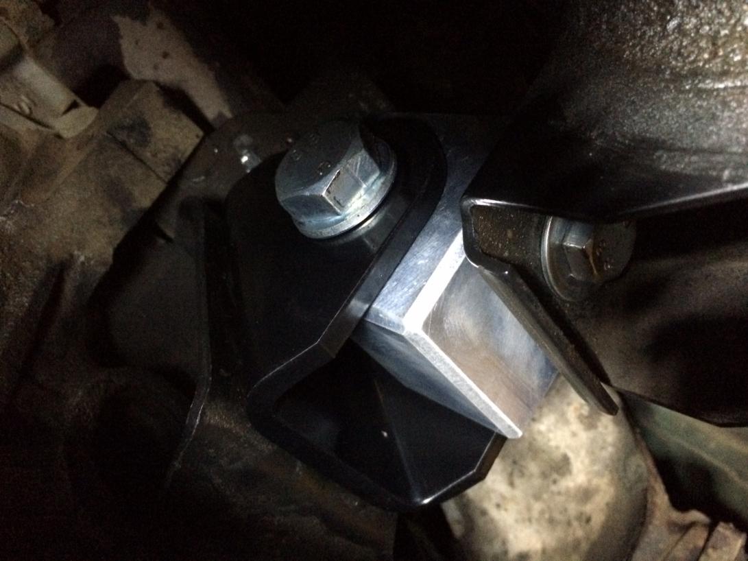

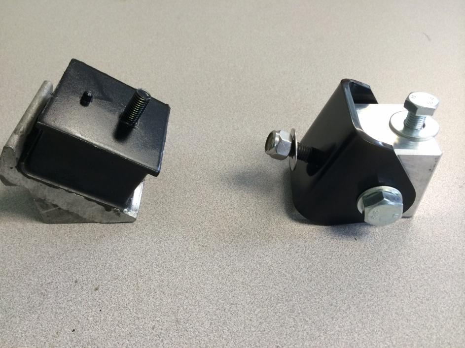

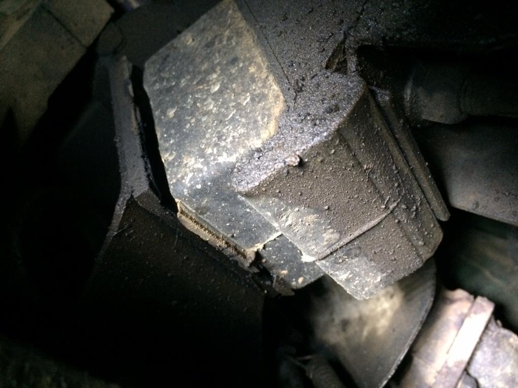

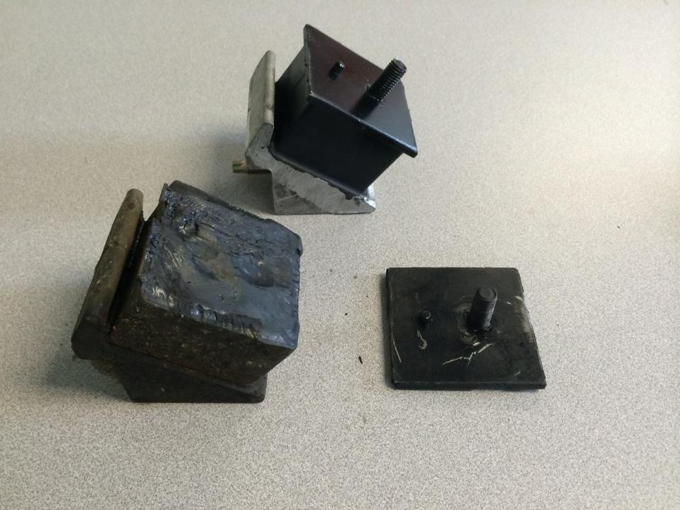

It is time for an update.
As everyone knows, the stock motor mounts on these trucks are garbage. As if these trucks didn't have enough problems, the geniuses @ Land Rover decided to use garbage motor mounts as well. The stock ones on my truck were not yet broken, but considering the terrain we encounter, I wanted to change them out with a set of the new Proud Rhino in an attempt to save myself from doing it on a trail somewhere.
Being that this is a project truck, and I was on a tight schedule and with having to basically swap trucks mid-build, I wasn't left with enough time to swap both motor mounts before I left for Spring URE this past April. If you've ever done a motor mount on your D2, you know that the passenger side is a 10 minute job. So, naturally I did the passenger side with hopes the driver would hold until I returned.
It did not.
Half way up the trail Daniel @ URE, my motor felt a bit rough. Upon further inspection, the mount had failed. Just my luck. Not having an immediate solution, I gently finished the trail, retreated back to camp. The one new Proud Rhino mount was so strong that it held the motor itself. Not having the replacement handy, we used a ratchet strap to hold it down, and it worked all weekend long. Special thanks to Matt Hines and Tobias Fricke for their help with that.
With both new mounts installed on the truck, it runs like a dream and has already tackled some terrain here locally at a new location we've been scouting.
Thanks for reading,
Erik

Pro tip. With an inverted torx socket you can remove the stud from the motor mount and do both in 10 mins.
