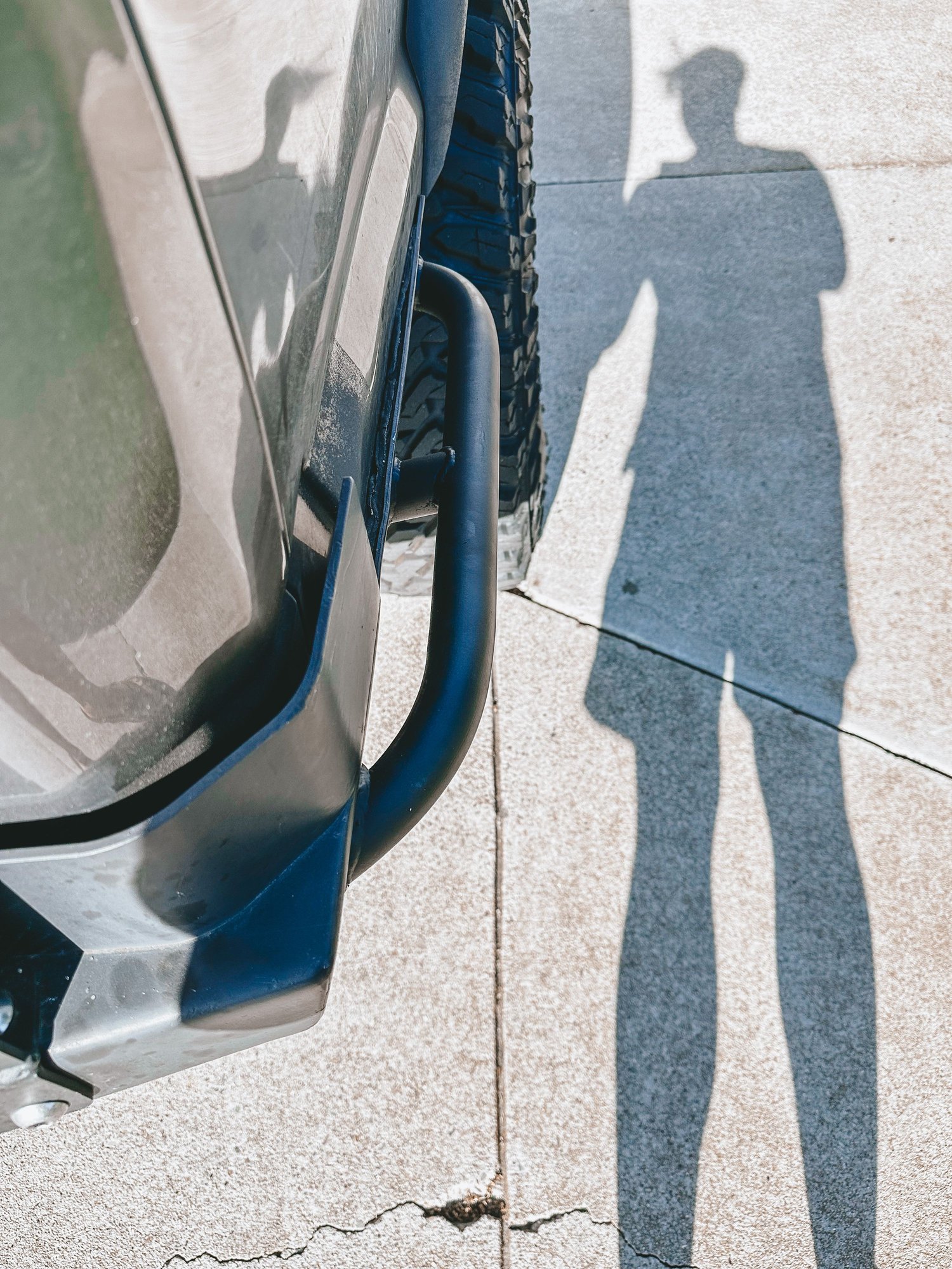

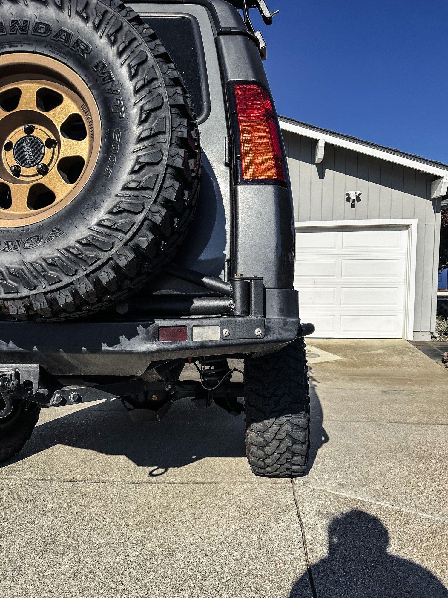

Likes: 111

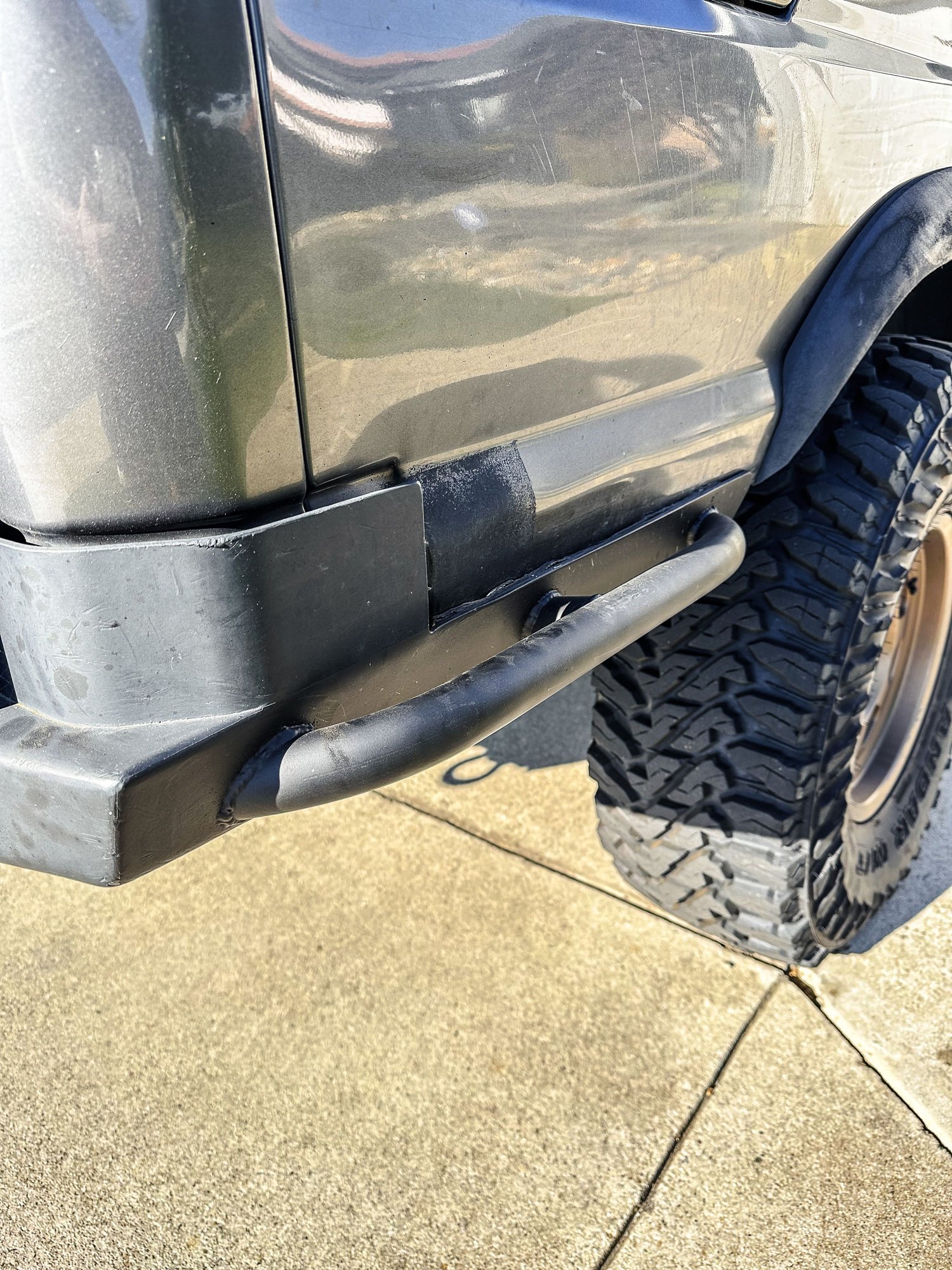

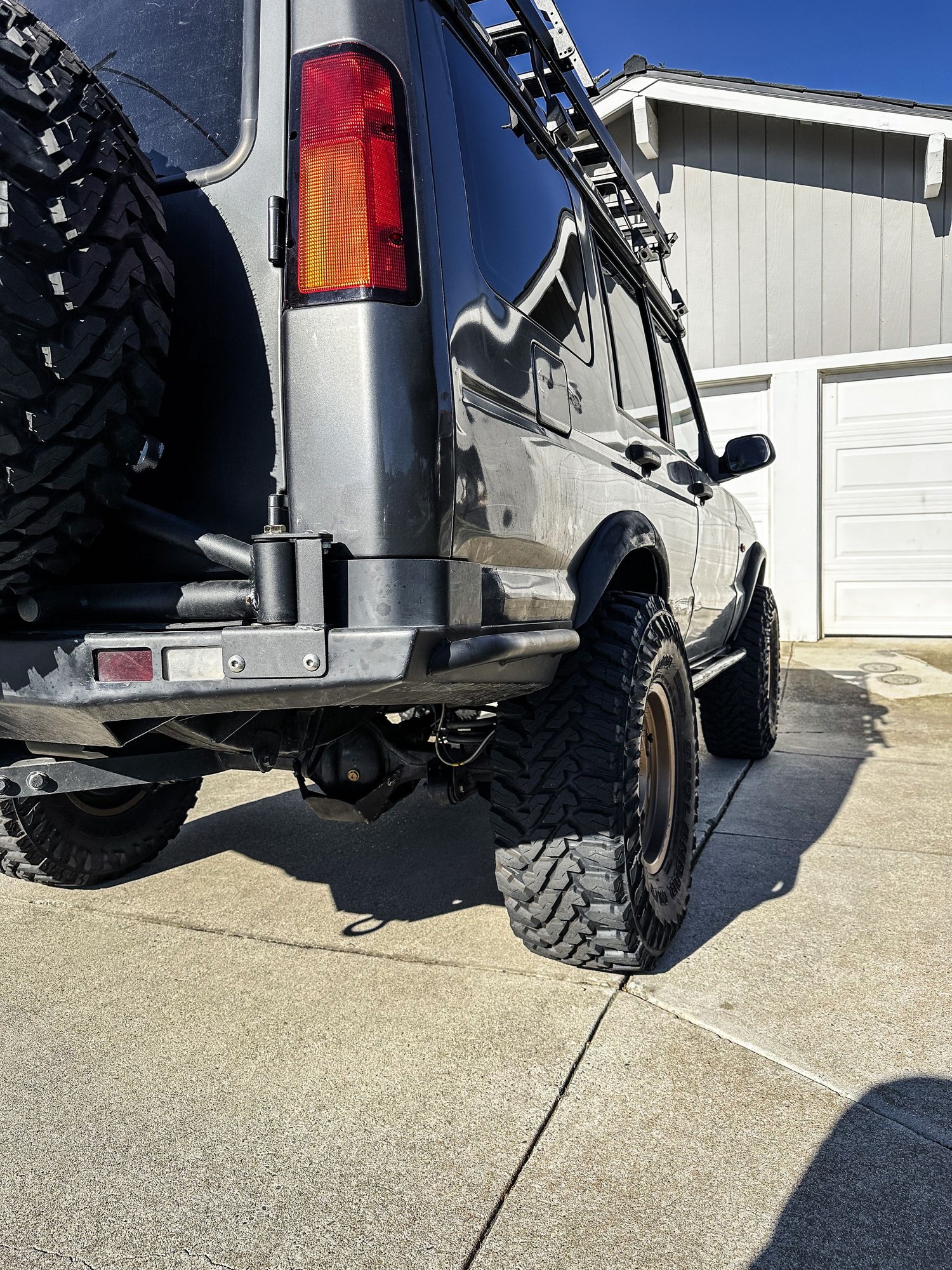

Some more pics of the nerf bars
Old Jul 2, 2023 | 02:06 AM
  #105
longtallsally's Avatar
Joined: Dec 2016
Posts: 1,207
Likes: 500
Look great. Fingers crossed for you.

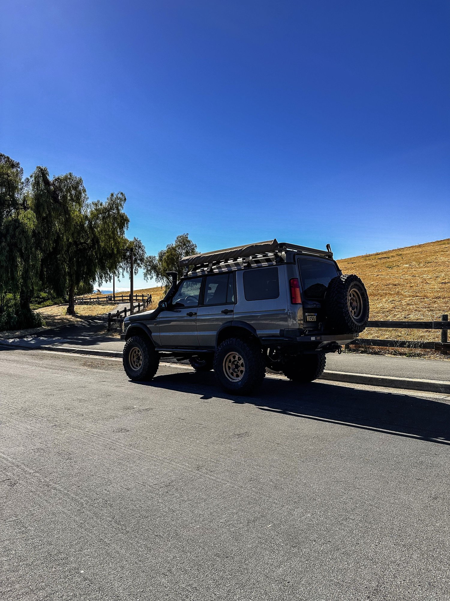

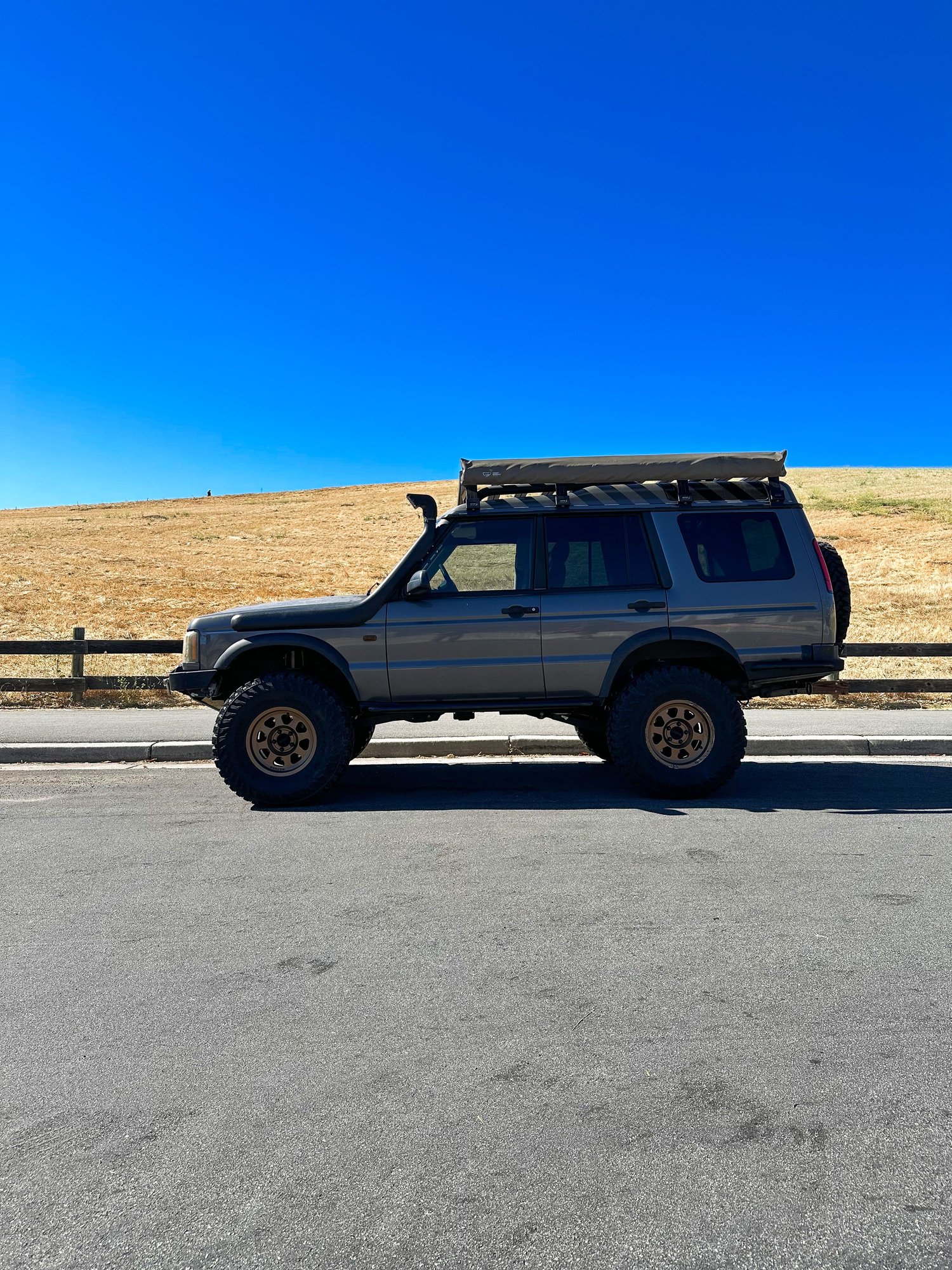

Likes: 111

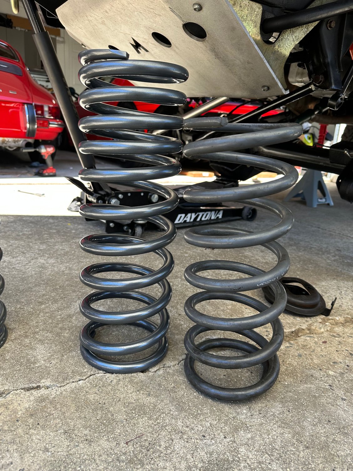

Swapped linear 3in HD springs and 1inch spacer blocks for RTE 4.5 in progressive springs. The disco is sitting about an inch or so higher now which should settle a little bit I imagine. More importantly the ride quality is much better with the progressive springs. The ride is more compliant as it isn’t as “crashy” over potholes and surface transitions such as on overpasses.

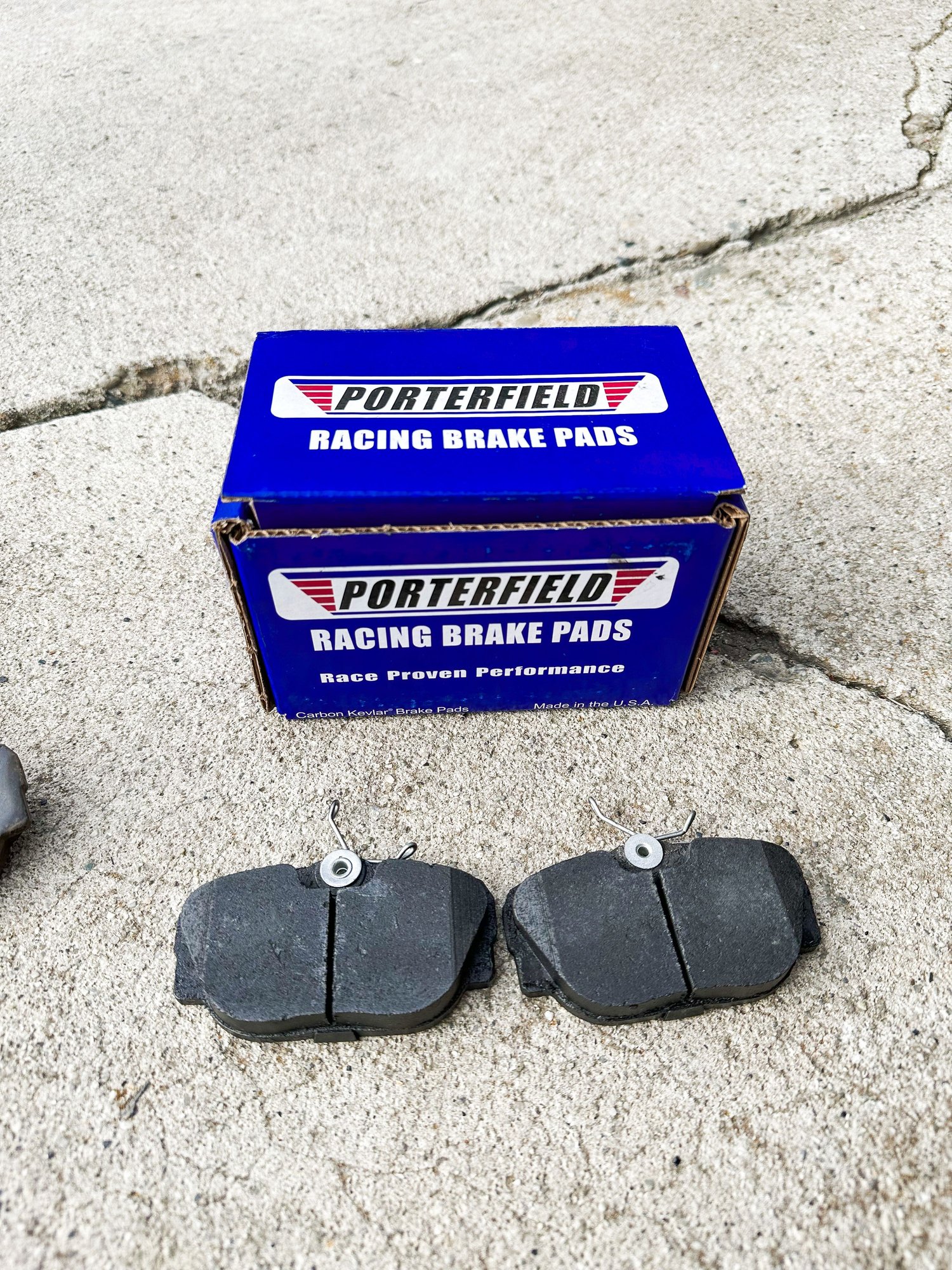

I also swapped out the Akebono pads for Portorfield R4-S pads. I use these pads on my Porsches and love them. Hopefully the pads help with some brake fade I’ve experienced with the Akebonos on the trails.
Which skid plate is that?
Terrafirma

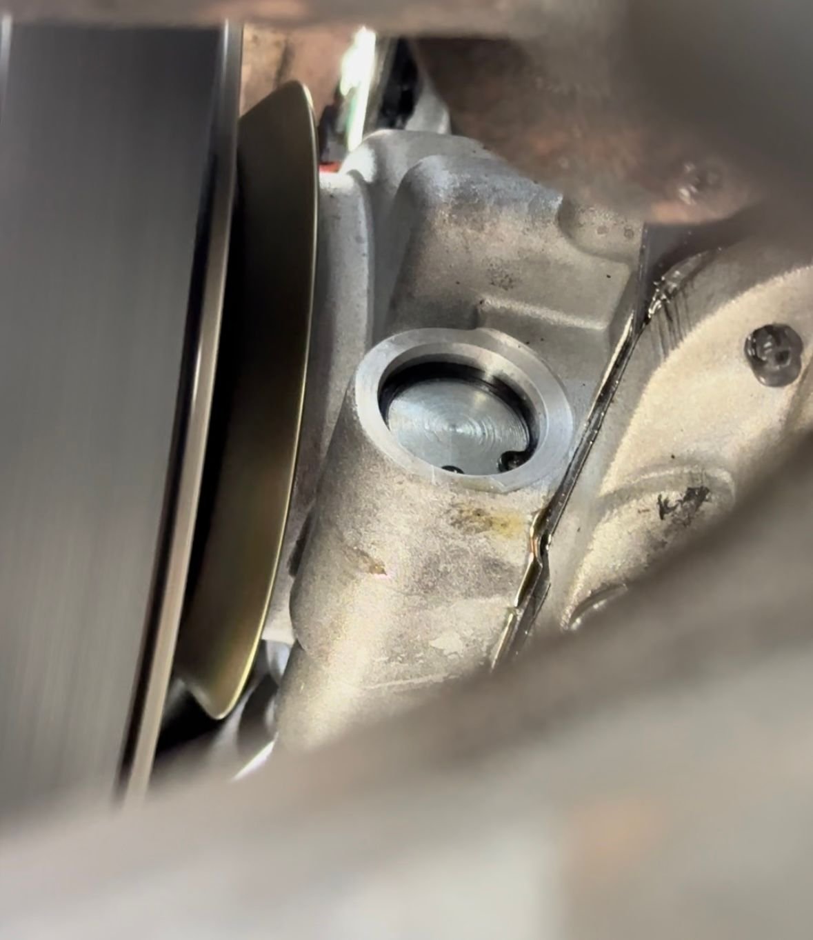

So….the new AB engine is leaking oil. Shortly after I got the car, I noticed the oil pan had oil on it. I figured AB did not seal the pan correctly as my last two engines had that issue. I degreased the bottom of the engine and noticed oil was coming down from above the pan.
Long story short, I traced the leak to the oil bypass valve next to the crank pulley. At idle, it does not leak oil. But as soon I give it some rpm it starts to slowly seep oil.
from my understanding, the whole front cover needs to be replaced to access the o ring on the cap in the oil relief valve. But if anyone has been able to remove the cap to install a new o ring while the cover is still attached to the truck I’d love to hear your experience. In all the posts I’ve read, the front cover was removed to replace the o rings. I can get my c clip tool in the area to remove the c clip but I am unsure on how to remove the cap itself.
