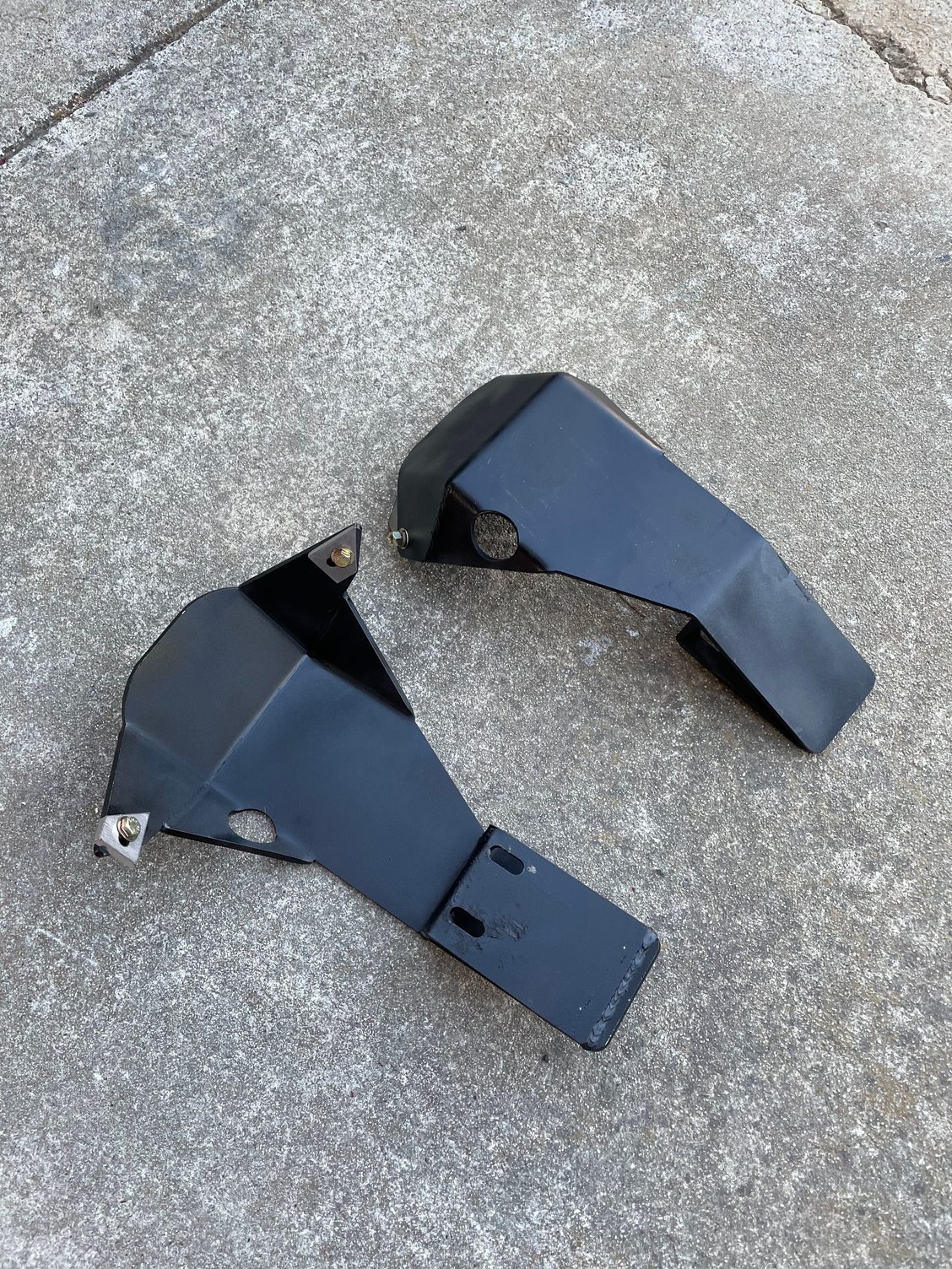

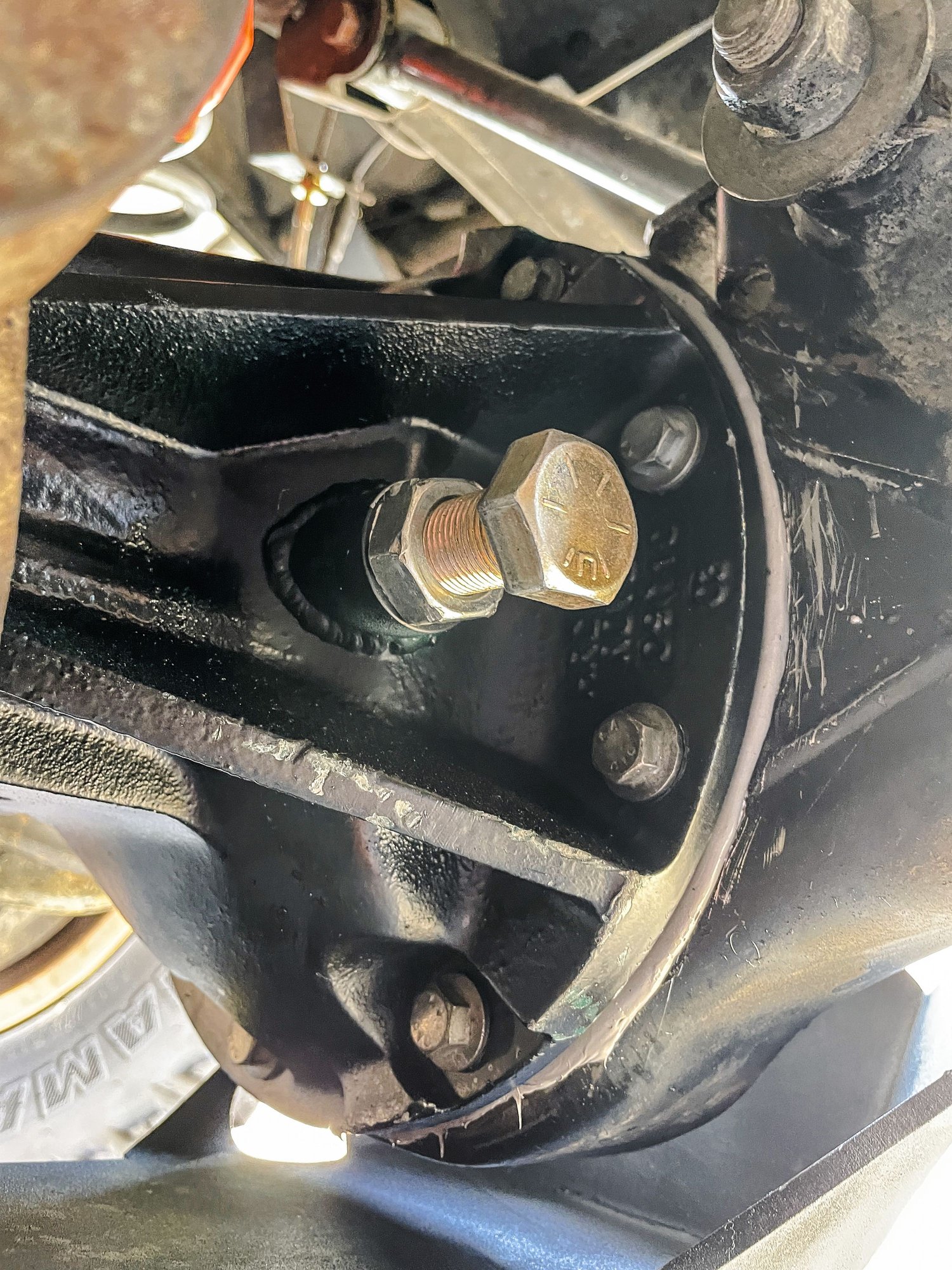

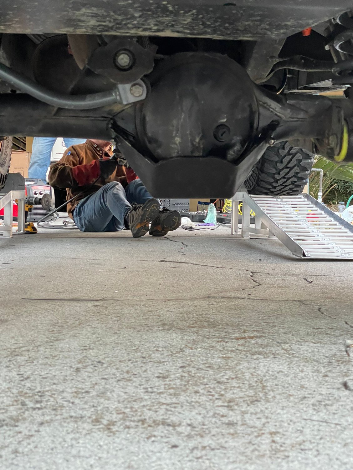

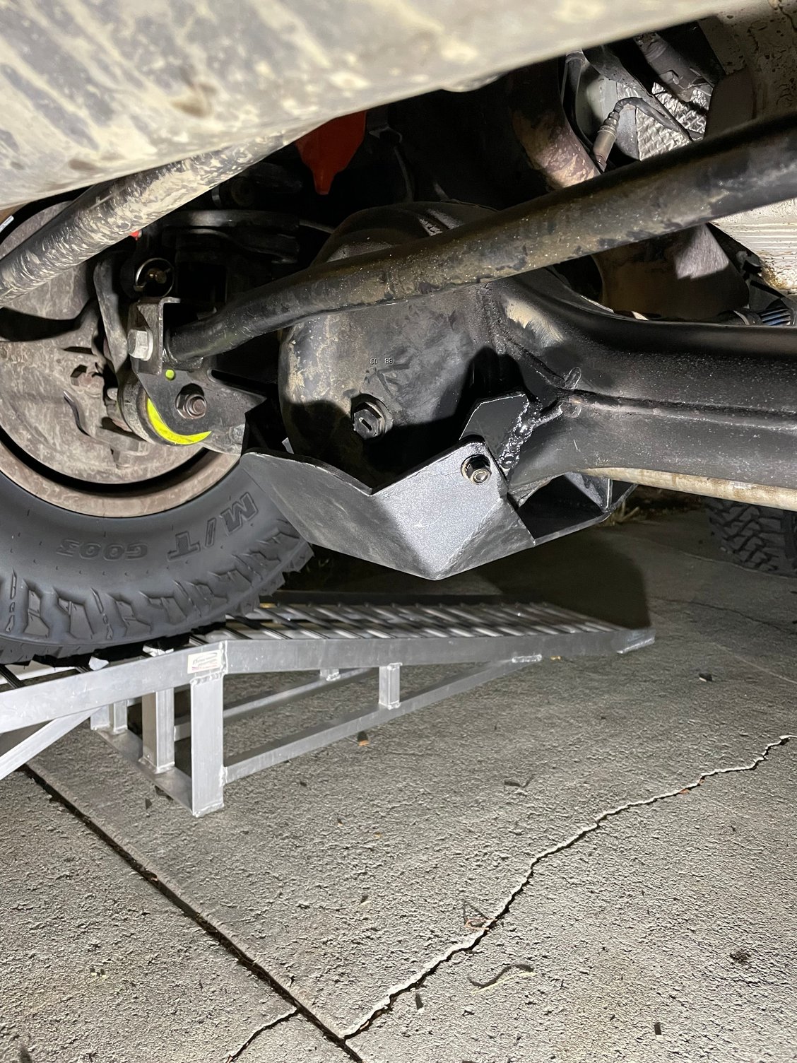

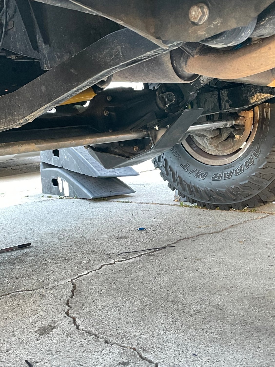

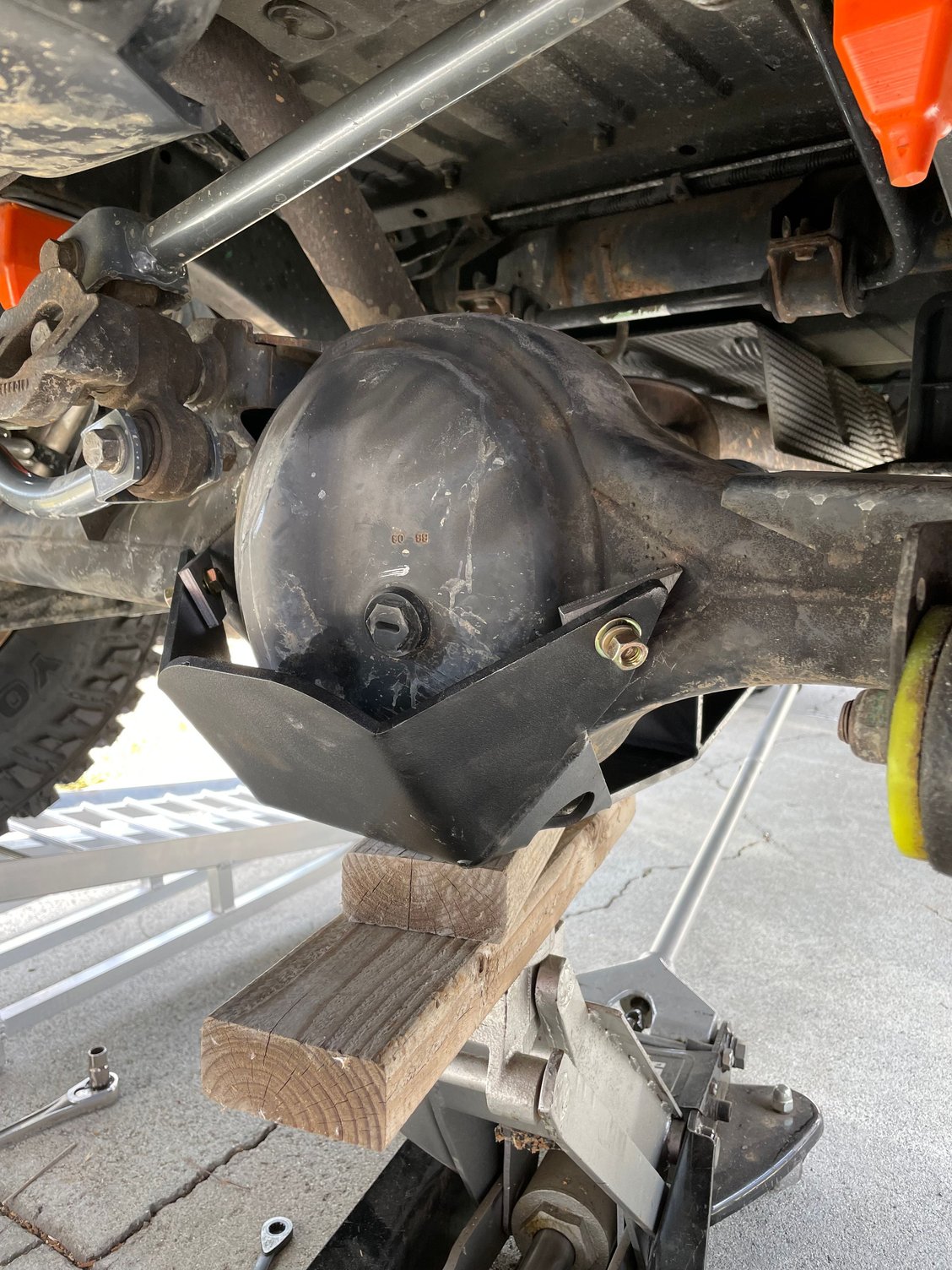

Installed Tactical Rover diff guards yesterday. For anyone who installs the diff guards in the future, the two bolts that attach the guards to the bottom of the diffs are BSF fasteners. Metric and standard bolts do not work. I ended up tapping the bolt holes to M10 size.

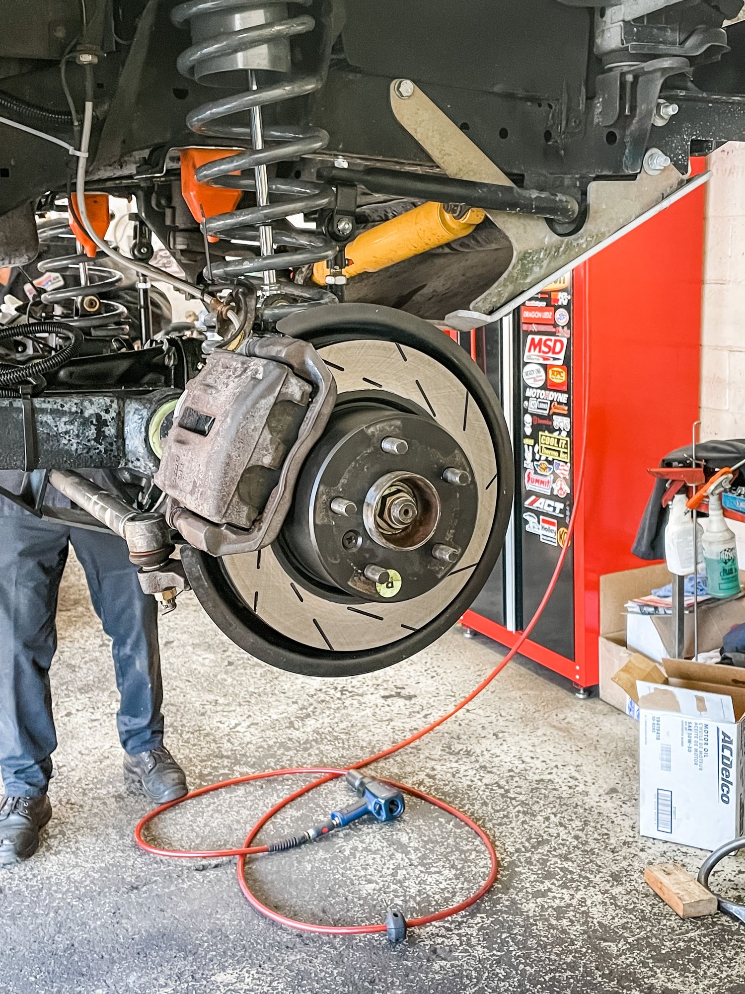

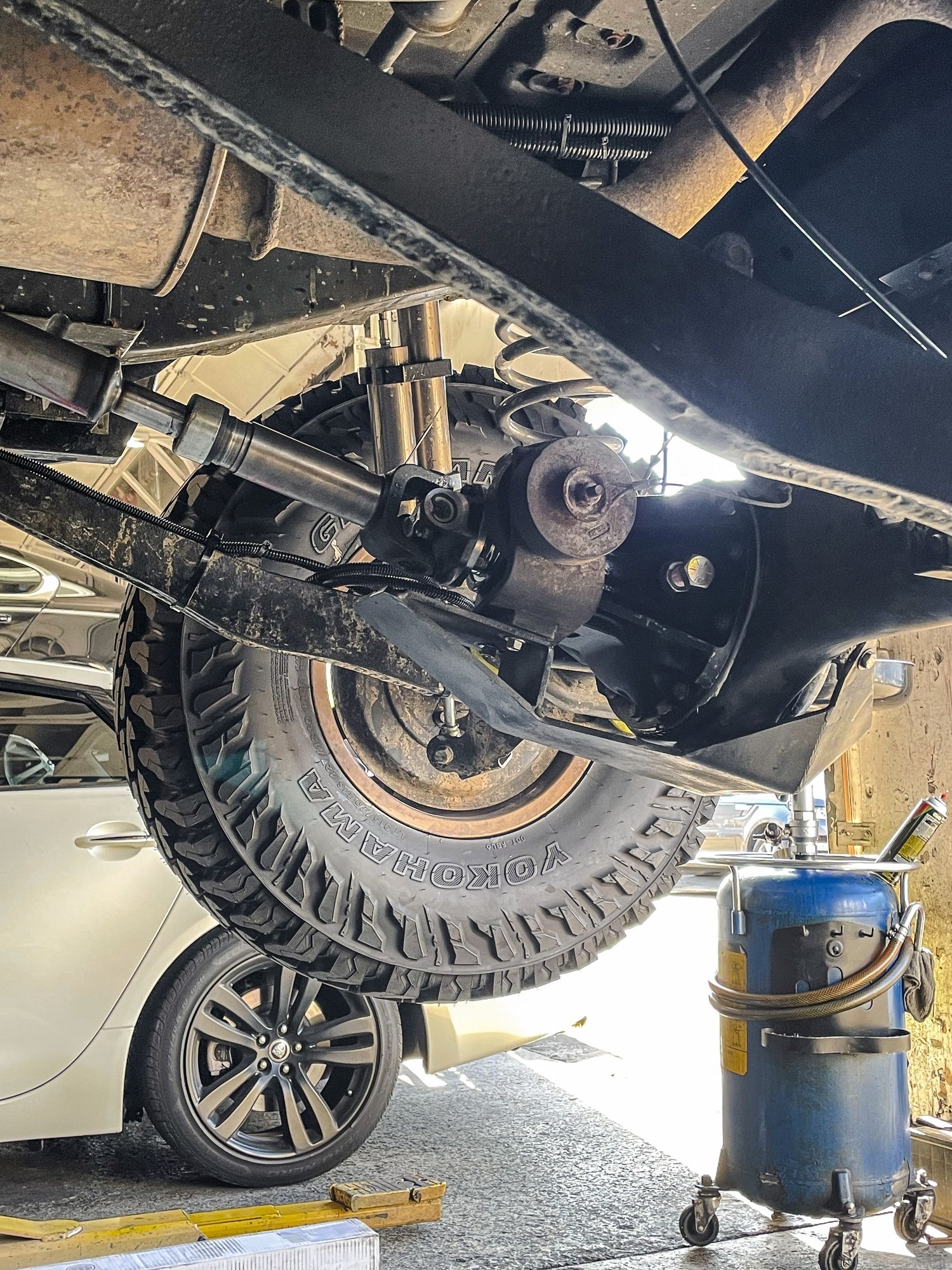

Went to pick up project money pit from the shop and just my luck we found gear fluid seeping through the brand new oem axle seal on the passenger side front axle
the anticipation is killing me, but I at least got to take a few shots of some of the new goodies while the disco was on the rack

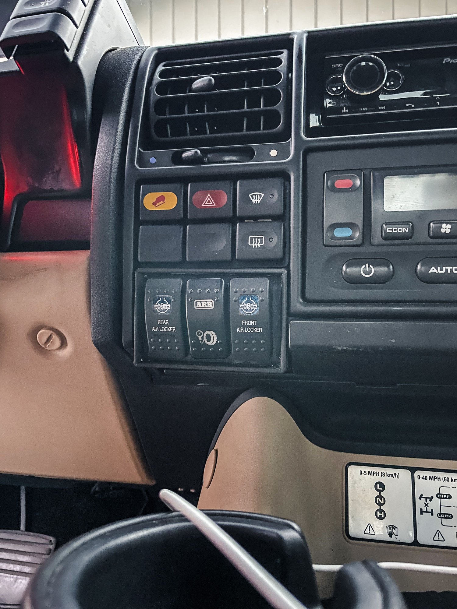

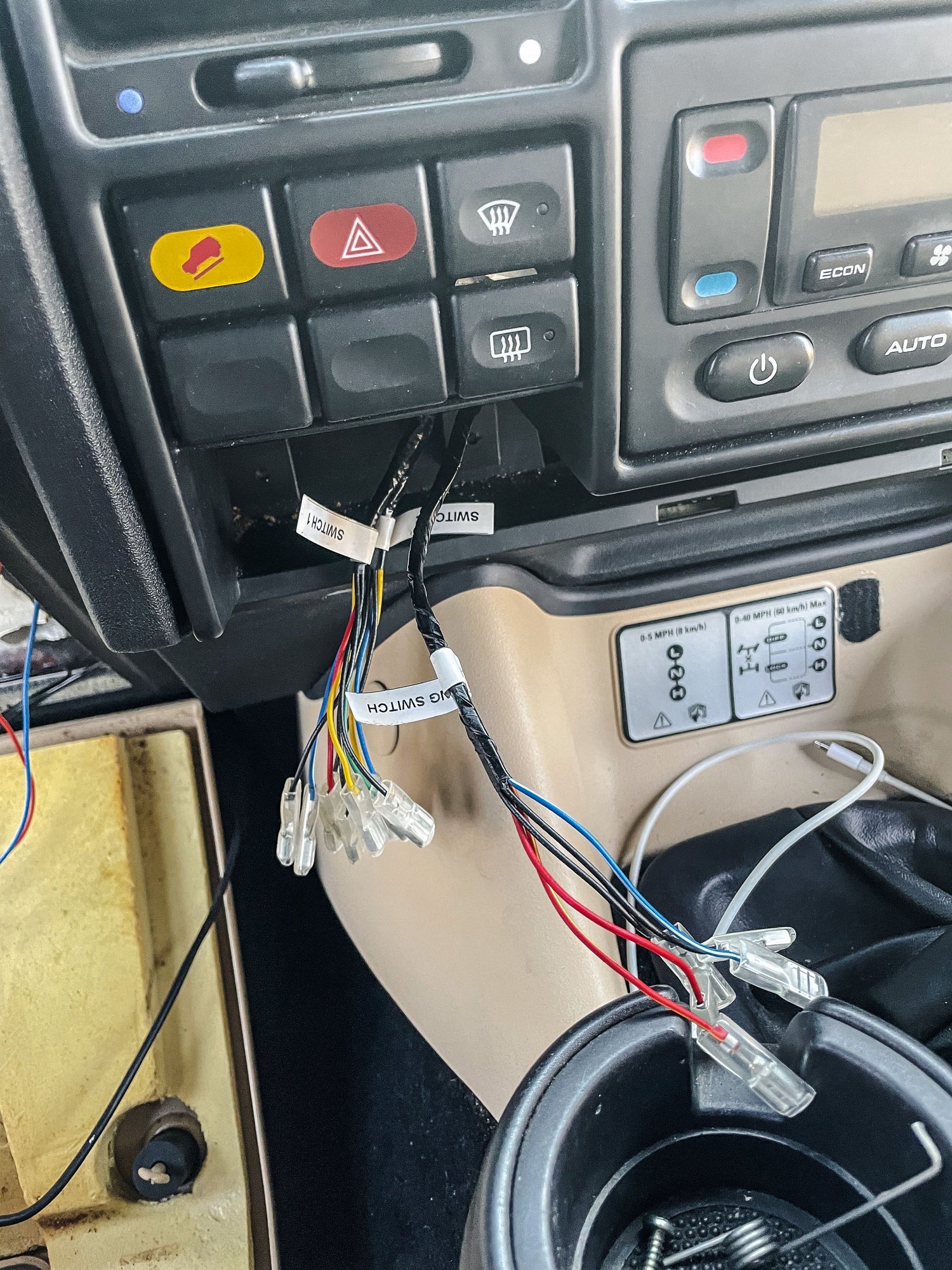

with the lockers installed, I did a little post work wire routing for the arb switches.

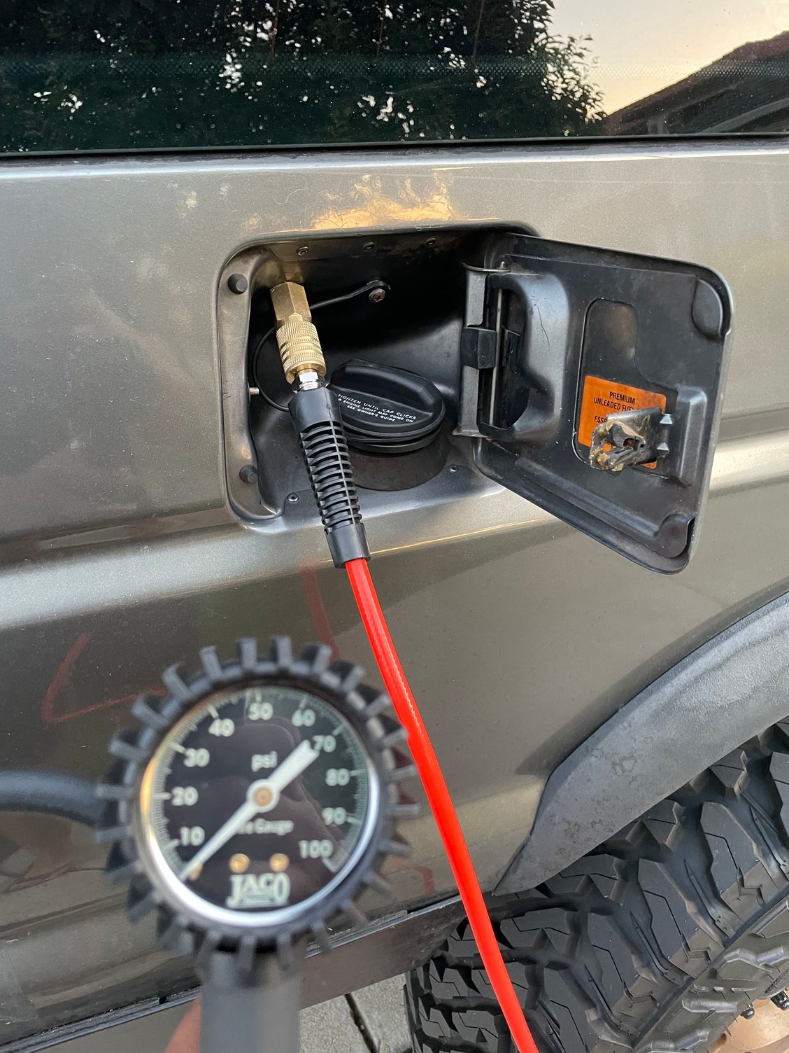

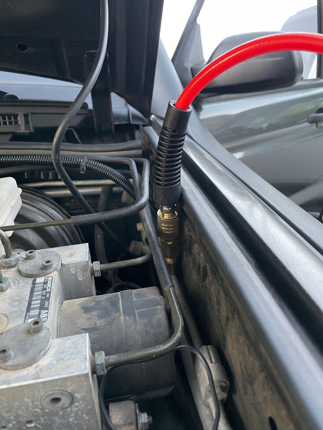

also, some pics below of my air chuck points with one in the engine bay and one behind the gas cap lid.
