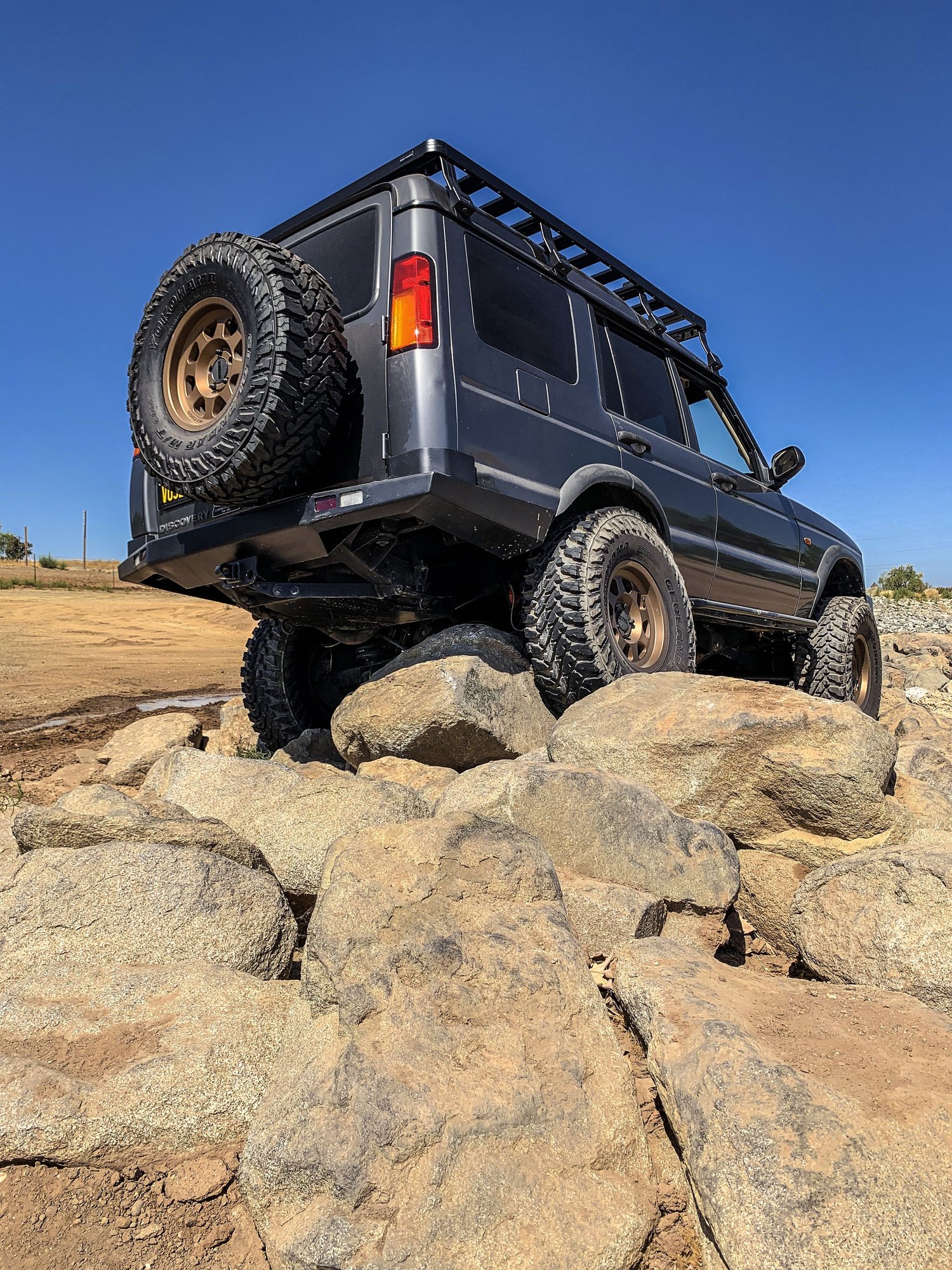

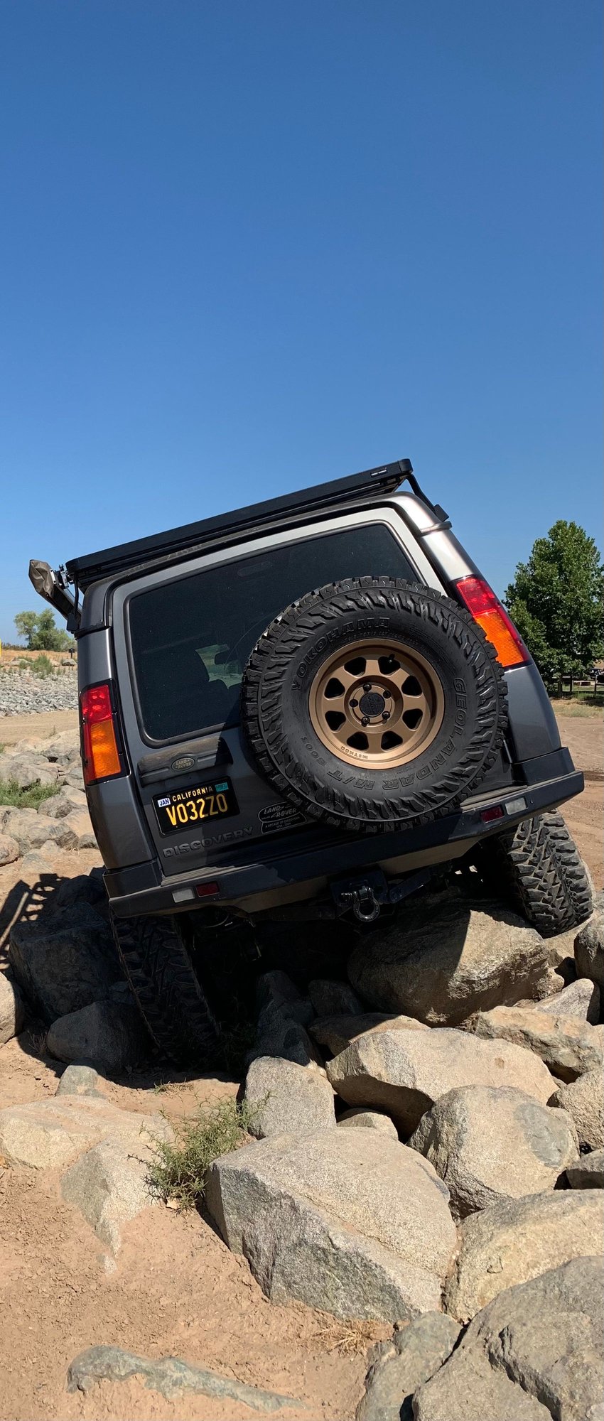

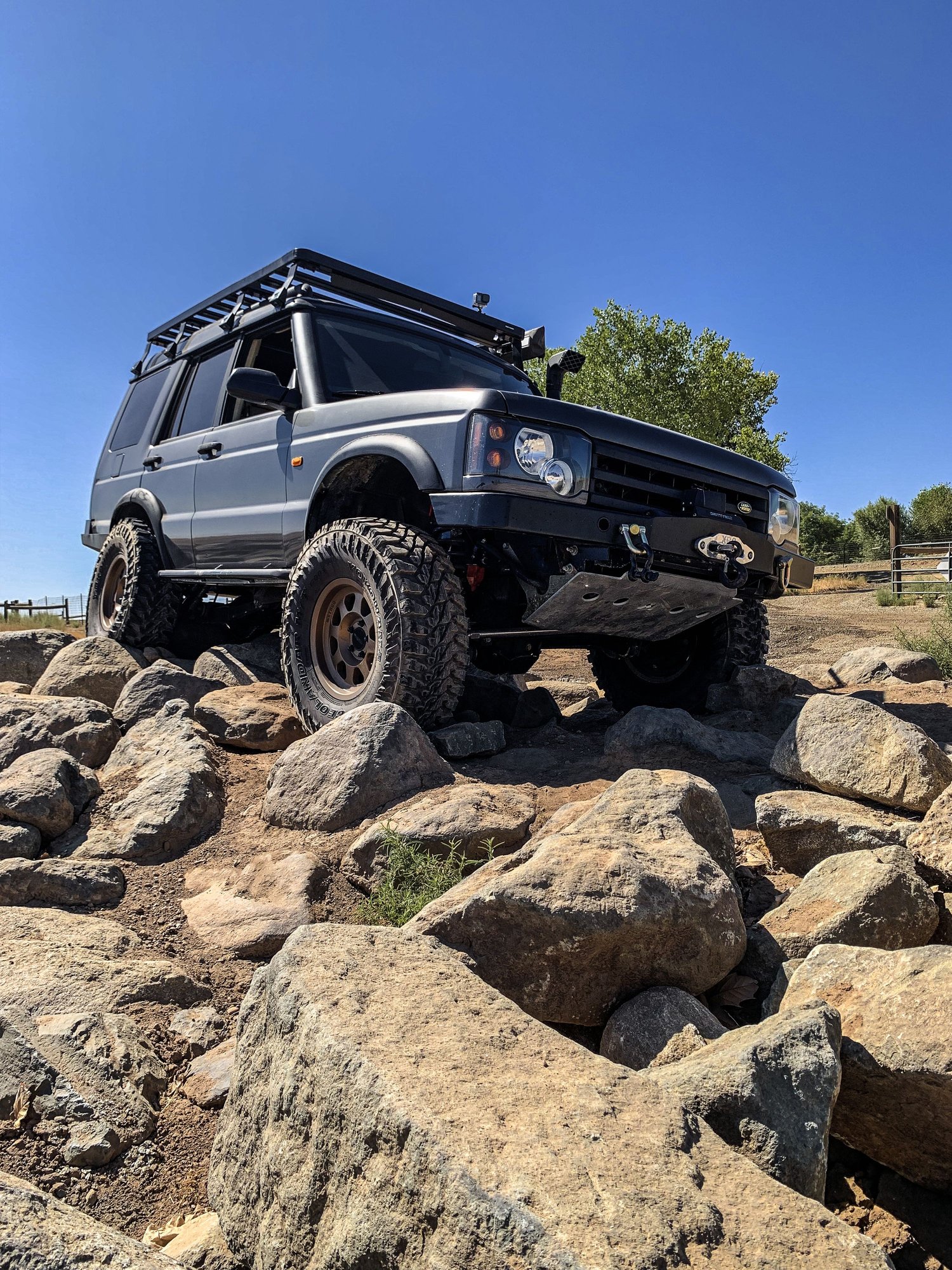

Took my D2 out for some rock crawling practice. First time doing this type of driving and it was so much fun. As you can hear in the video below, the Tactical Rovers diff guards did their job and protected the diffs. I did happen to slightly bend my RTE HD SS track rod which is a bummer, but otherwise the D2 did awesome.

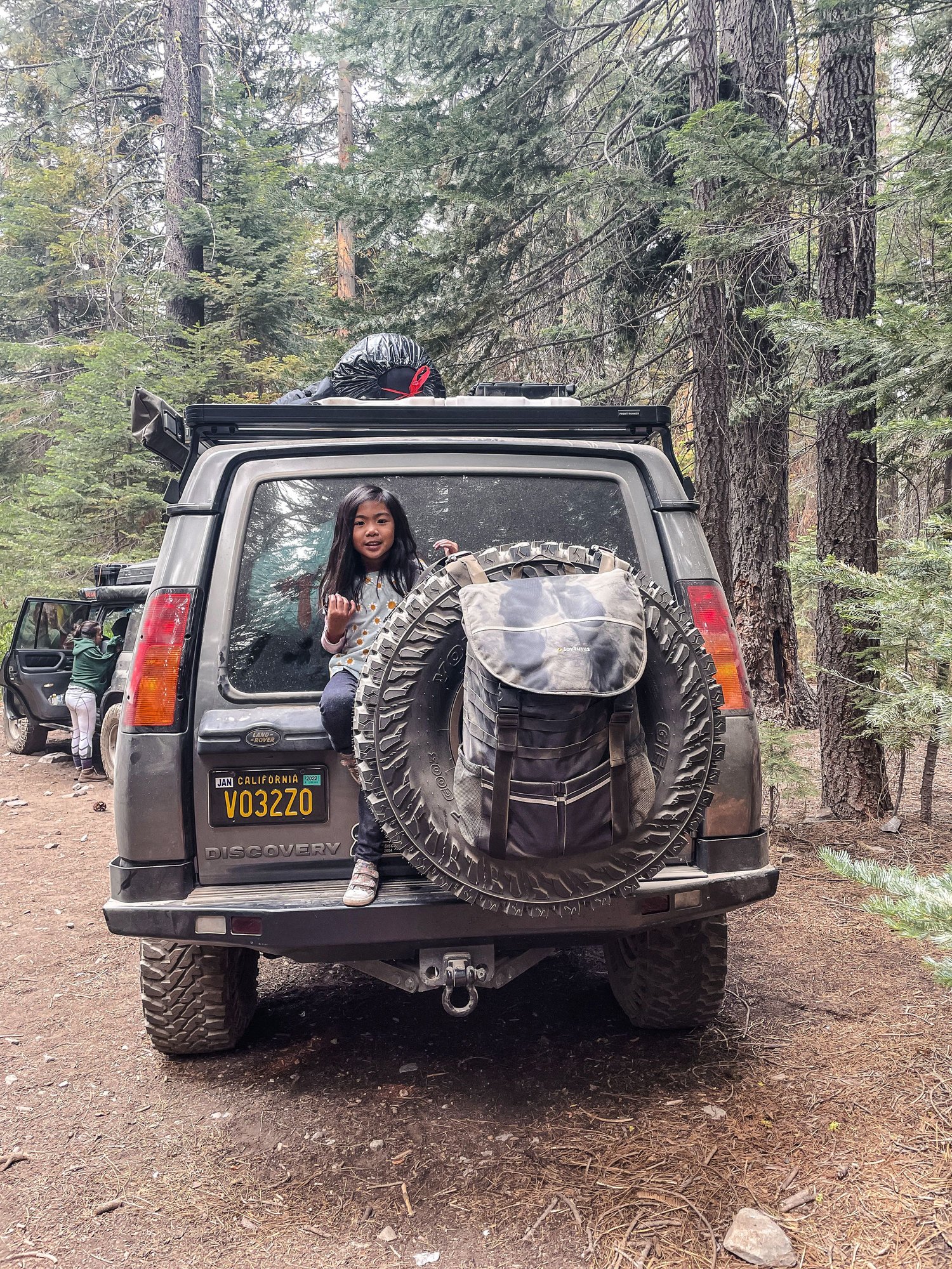

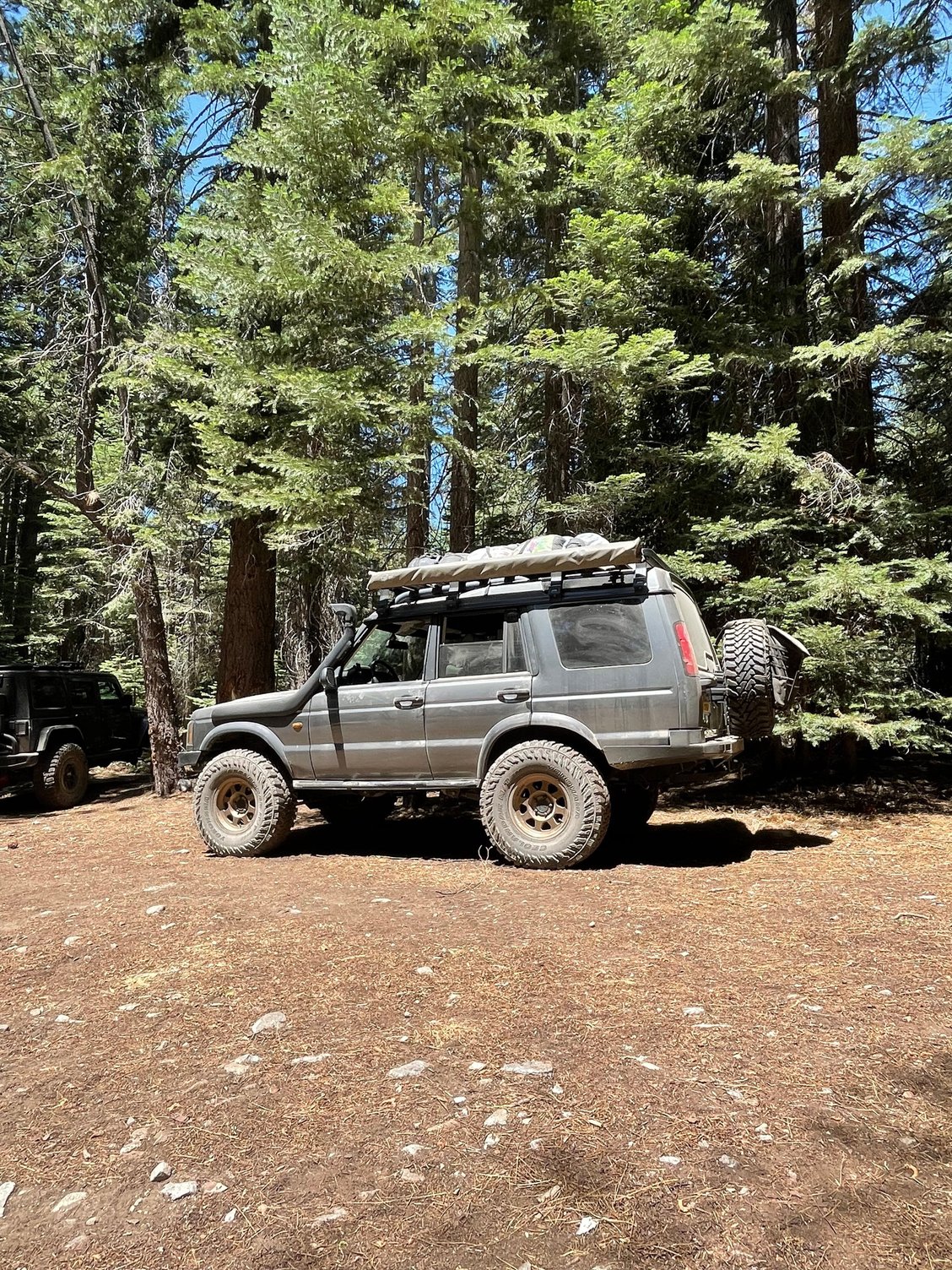

Family time with project $$$ pit. Spent a weekend at Bowman Lake with family and friends. Was great to disconnect for a few days and see the kids play without an ipad
