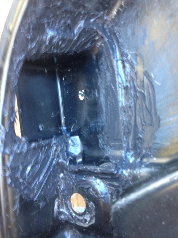

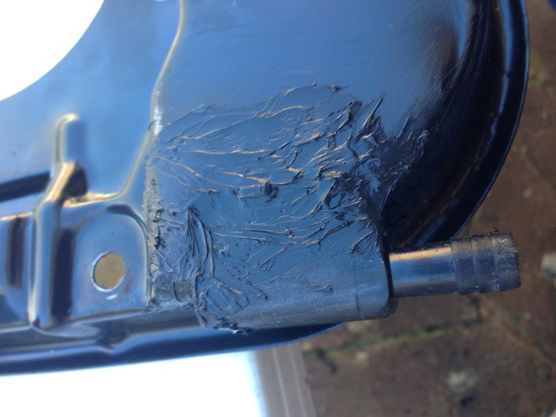

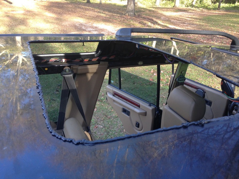

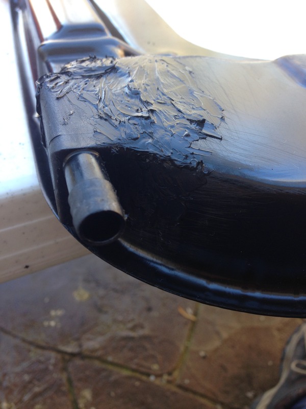

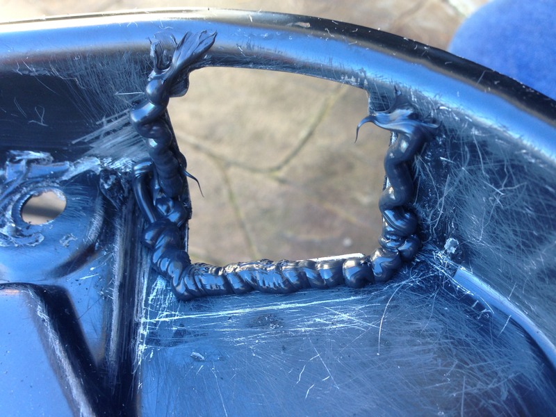

Default The war on roof leaks....

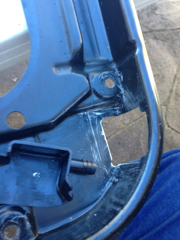

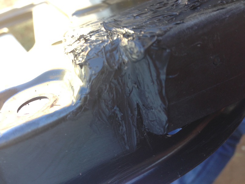

I hope to finally resolve the sun roof leaks permanently....
My first attempted worked for a little while, but the water just cannot get out of the drain tubes, so I now have decided to seal them up for good.
My sunroof motor rebuild sorta worked, but i think that it was just too far gone to call it a successful repair. So instead of messing around with them, spending money to replace the motors, seem like it just made the most sense to just seal them up.
Here is what I did to seal them up.

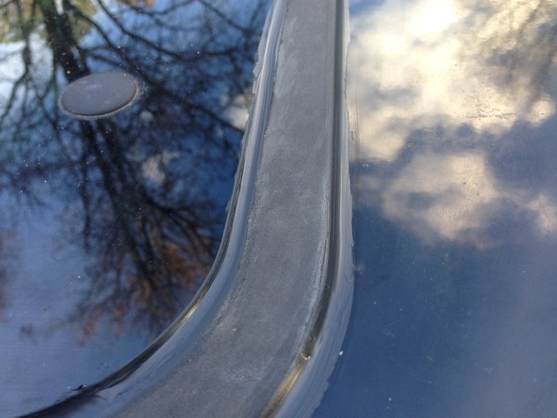

I ran a bead around the roof where the sunroof shell will sandwich between the roof. I then ran a bead around the shell and then around the glass.

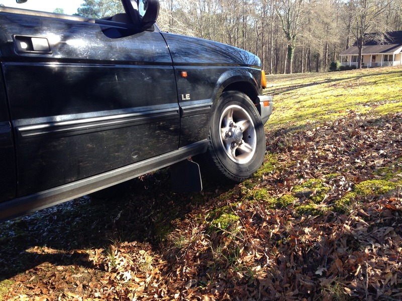

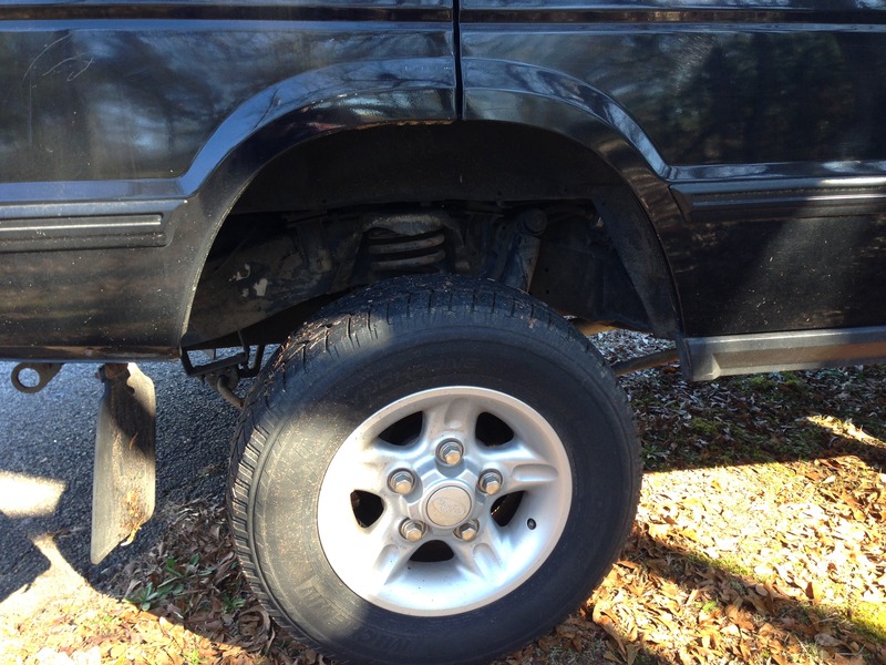

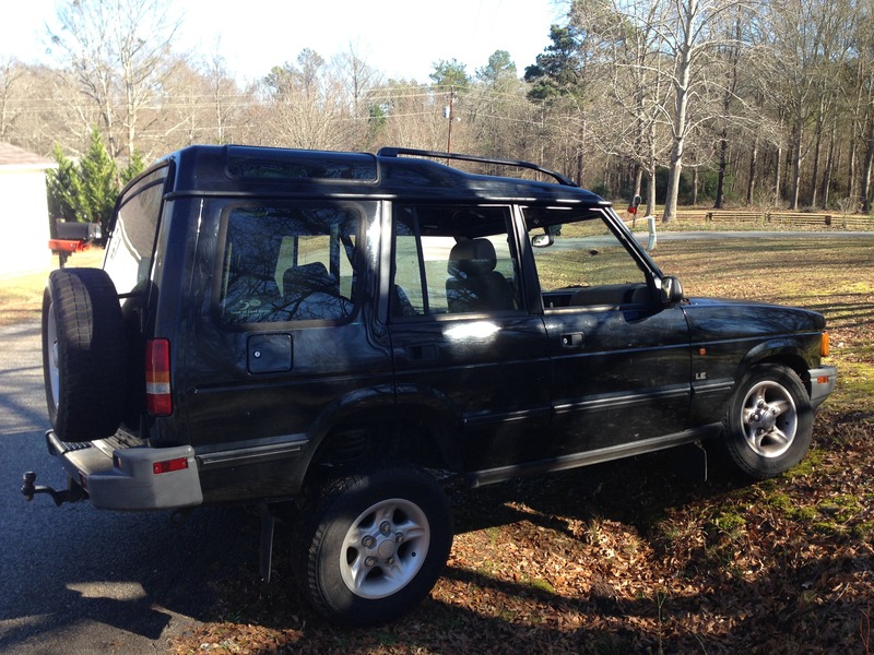

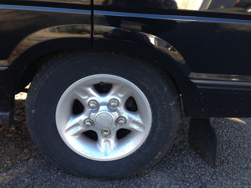

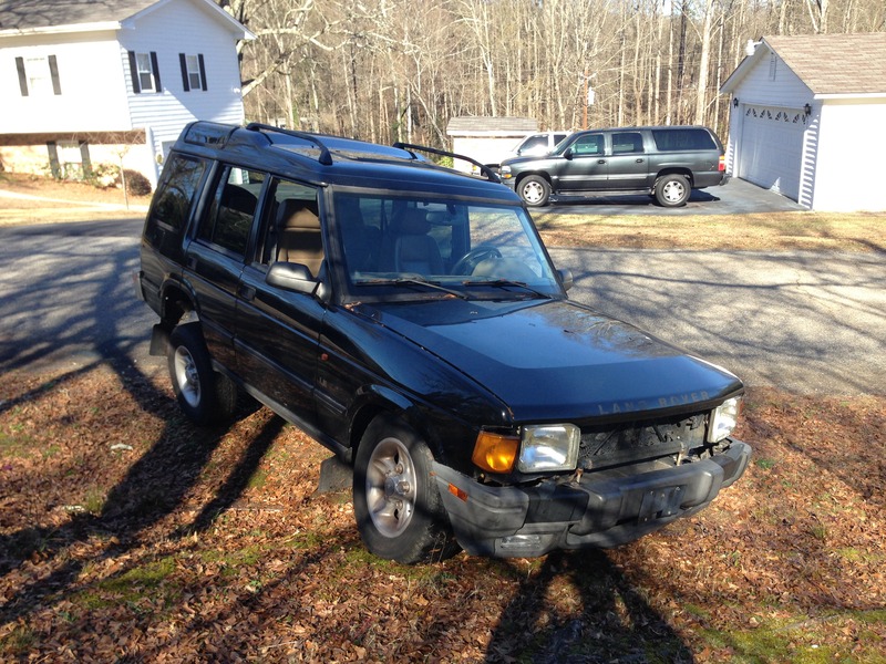

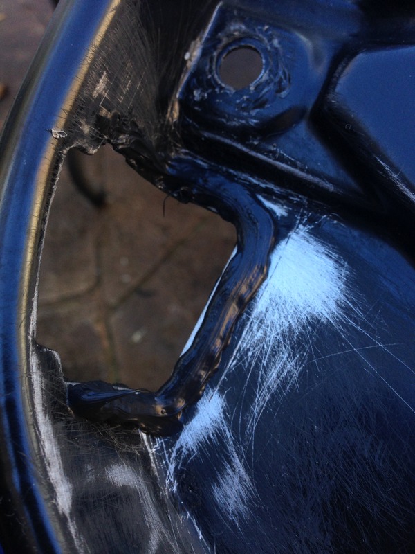

Did a little suspension test out in the front yard....
I see some trimming in my future.....

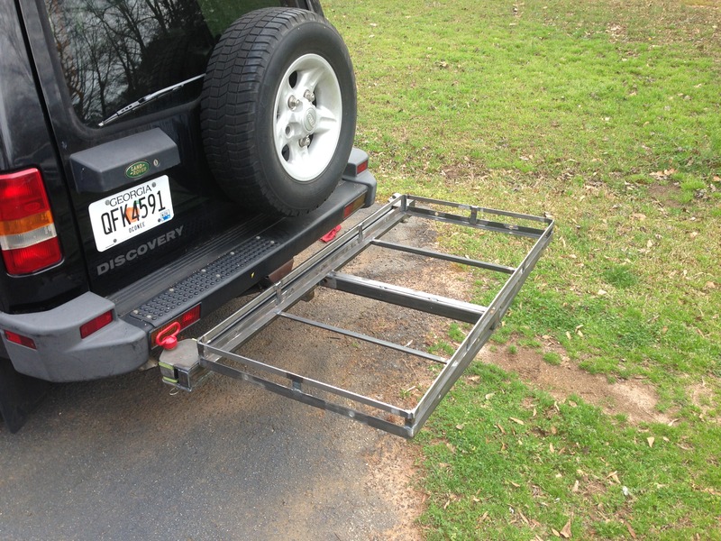

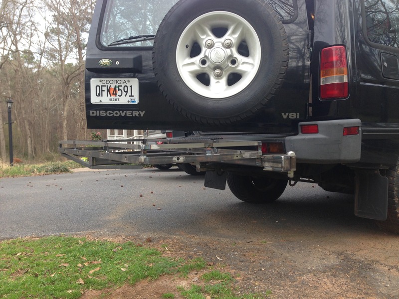

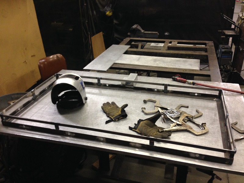

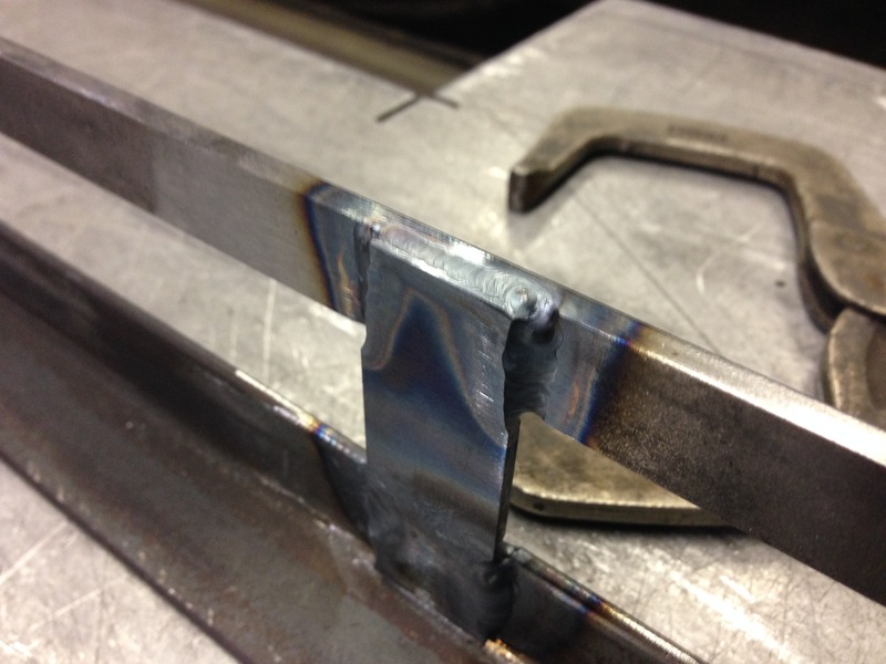

Havent done much with the Disco lately, mostly due to holidays and work, but i have been working on my first tig welding project.
I built a cargo rack for my dad years ago for his Xterra and once I got the Disco, I wanted to build another one.
I am pretty excited about this project and should be pretty awesome when i finish it up.
This is also getting my tig skills down so I can start designing my bumpers.
Here are a few pics of my progress for the rack. More to come in the next few weeks.
Not too bad for a rookie..

not bad at all certainly got your penetration with the weild

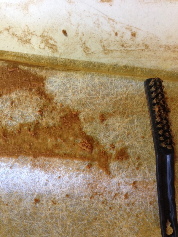

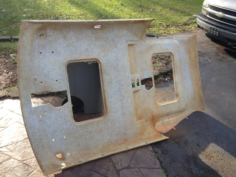

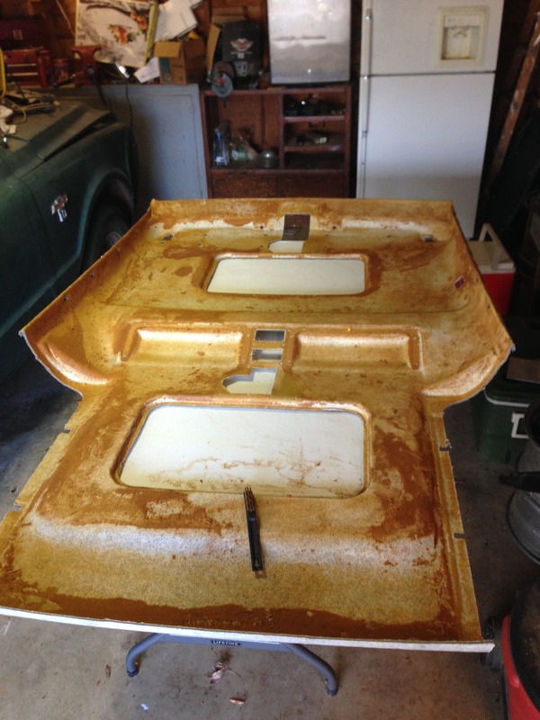

I have been kinda bouncing around from different project and made some progress on the Headliner shell to prep for painting.....
Needed to remove all of the old glue....a stiff brush seemed to work well for this..
Now just need to do some final brushing / sanding and can clean for final prep before paint.

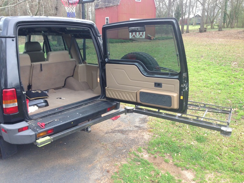

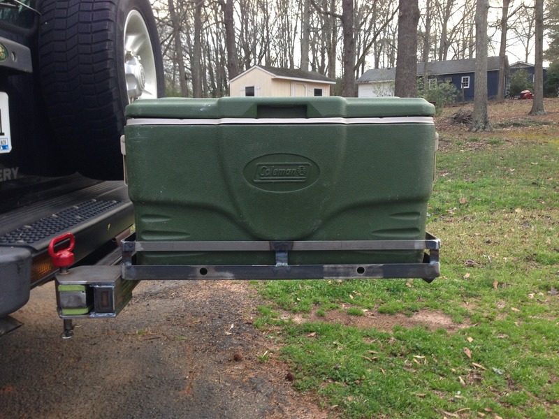

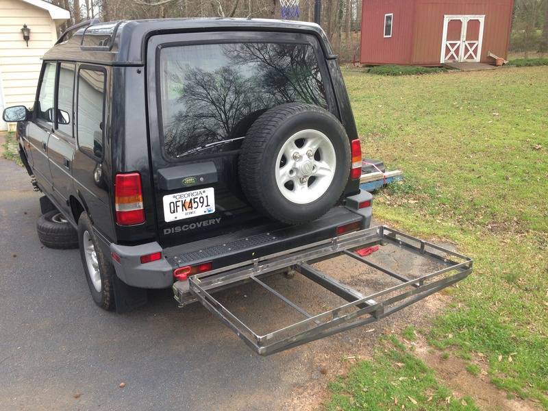

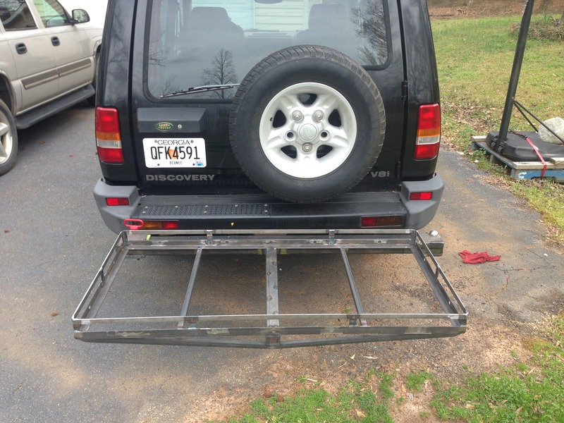

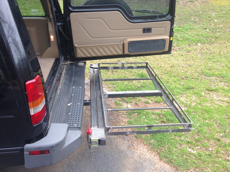

Default cargo rack test fit

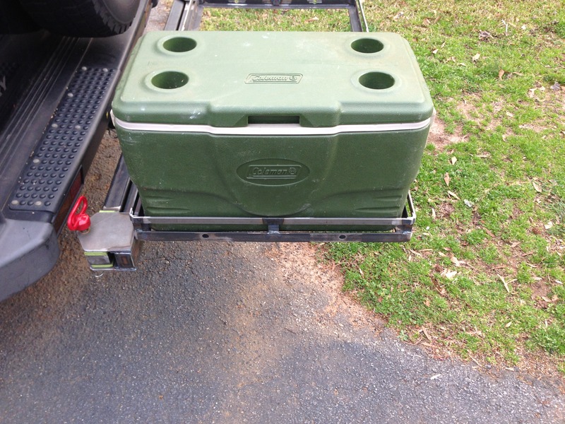

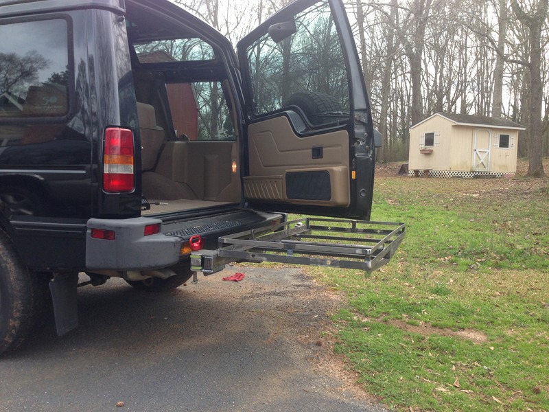

Made some good progress on my new cargo rack for the Disco.
So far, I am pretty happy with the way it has turned out.
Just need to add one final gusset / brace and then weld in the expanded metal for the "floor" of the rack itself.
