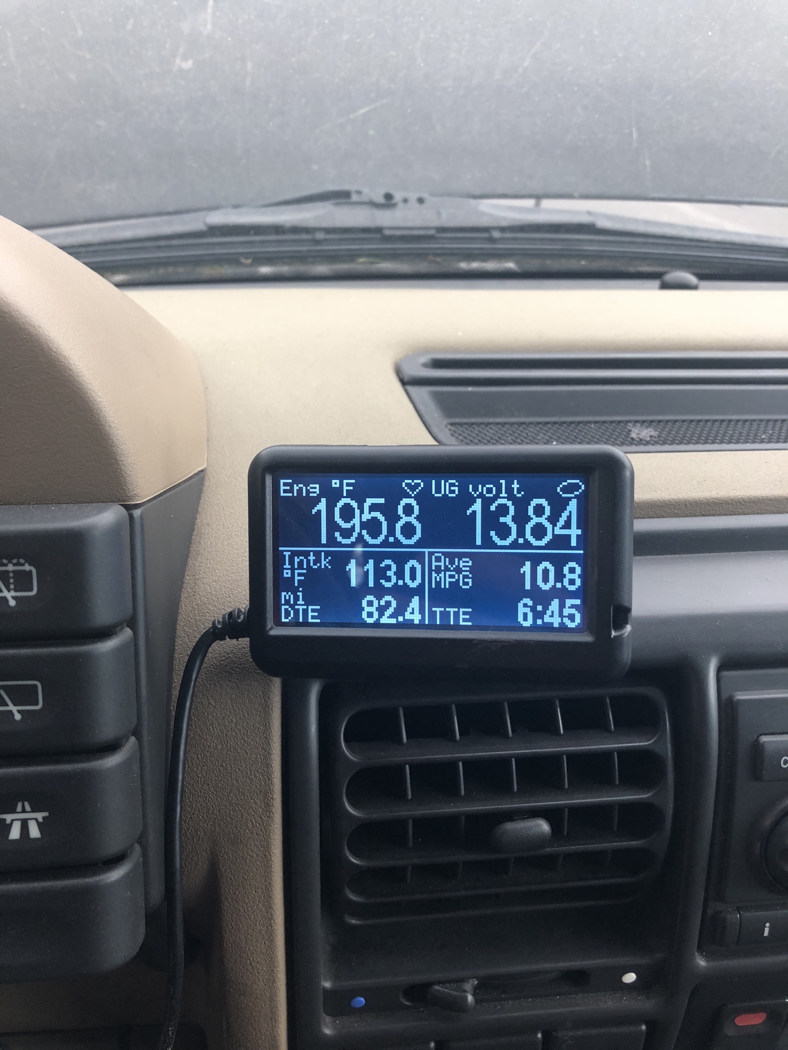

No but really, things seem to be working as they should now. Heat in the cabin measured at 130 degrees, most coolant hoses were in the 130 range as well, meanwhile the UG was reading around 180 at the same time. MagPie took a really long time to get up to temp, almost 30ish minutes but held steady while at idle in the 195 - 215 range (i'll explain more later on that) for almost an hour.
Here is UG readings after things had been idling for about an hour:

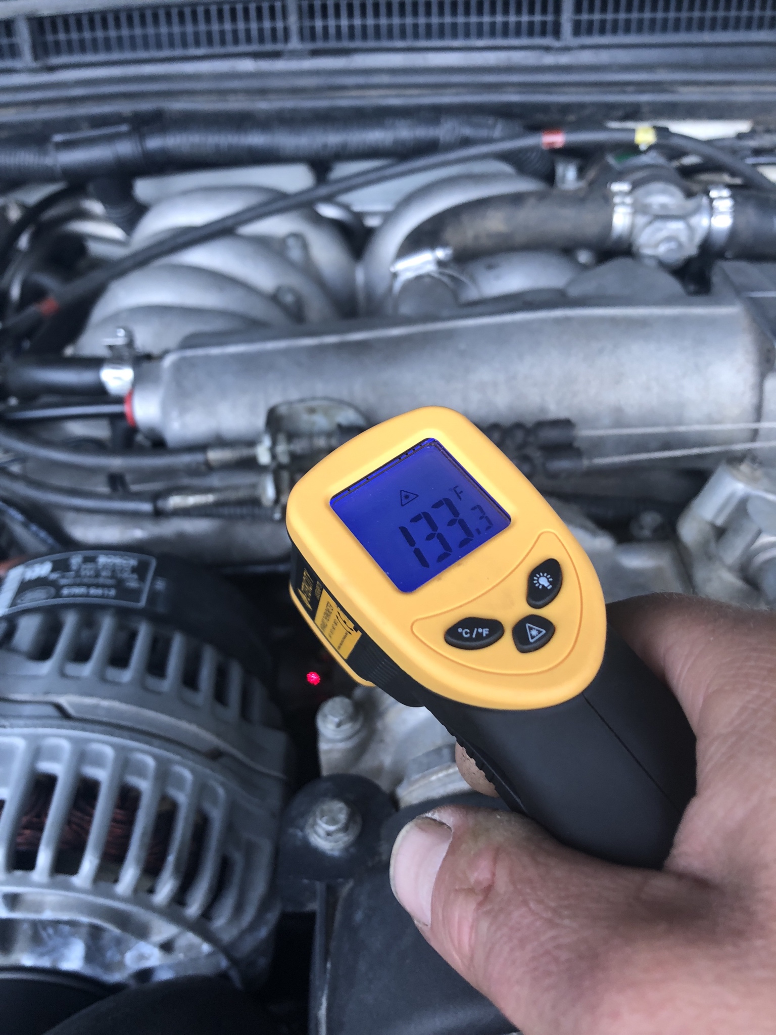

Prior to that pic, i was "poking" around the engine bay with the temp gun that I have and thought this was weird. Its kinda hard to tell but the gun is pointed right next to or right on the brass part of the temp sensor.

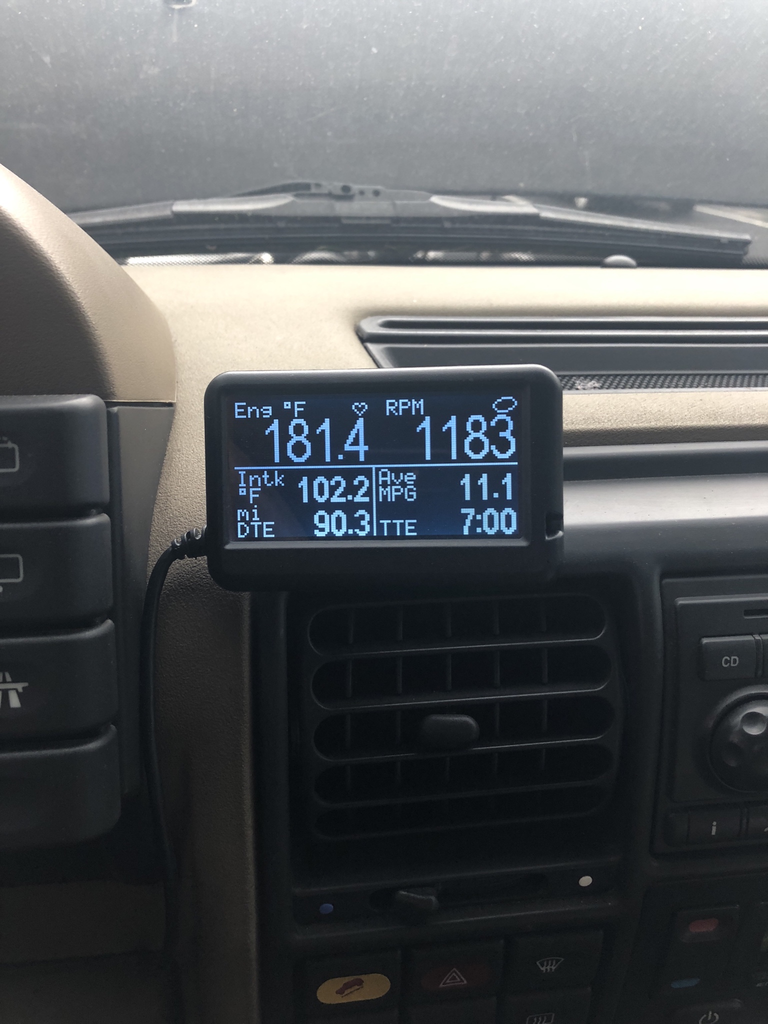

10 seconds later or so, this is what UG was reading:
Soo.. what is going on with that.
