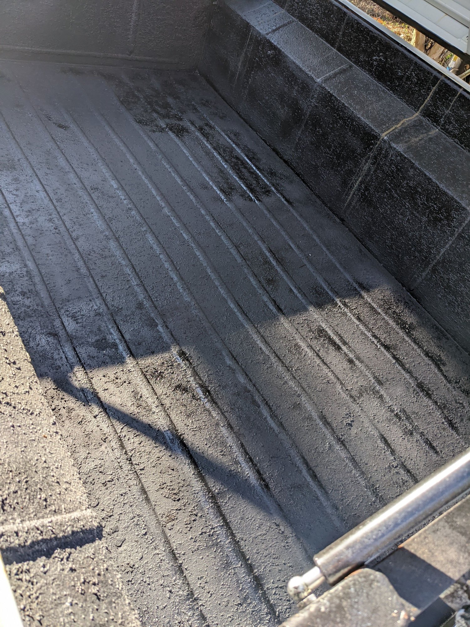

with the bed having dried out, I surveyed what was hiding in there.
So I hit it with some Rustoleum Rust Reformer
Waited a bit then did a second coat. Then it was time for the Herculiner. A couple of coats later with a bit of dry time in between we finished up here for the day.

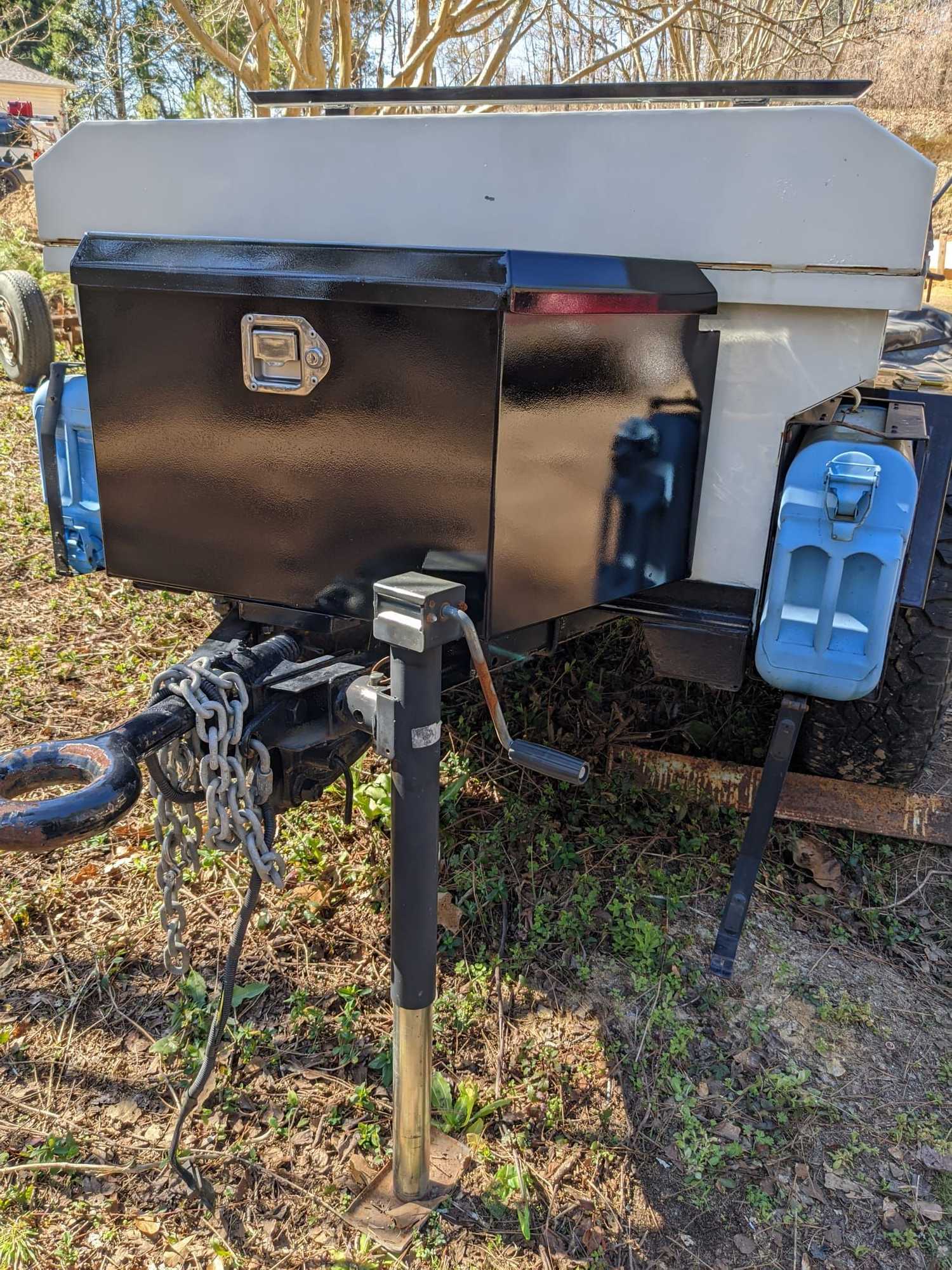

Today I was doing a lot of fiddly jobs on "Strange Rover" so I didn't get much accomplished on the trailer.
Took the old tongue box off it was looking pretty sorry for itself.
Gave it a good clean some prep and hit it with the old stand by Rustoleum gloss black. Holds up surprisingly well, and super easy to color match if you scratch it up.

Baby steps, got the water cans cleaned up and refreshed along with the water can brackets.
