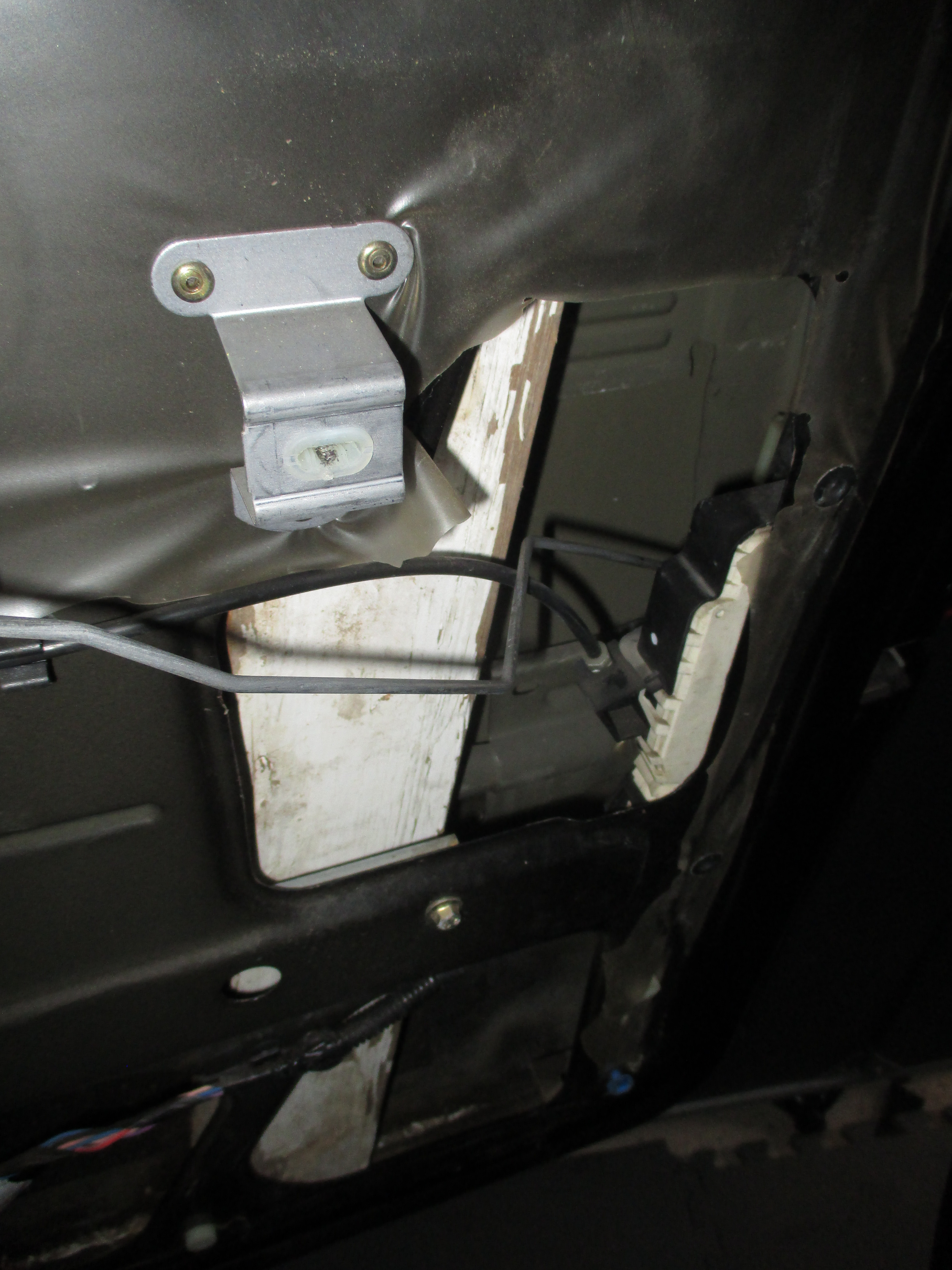

I think I found the best example of how this was cared for, both front door regulators were bent and broke, but the best was the passenger window which was propped up with two 2x4's. Vehicle is basically done, wet sanded and polished. I am waiting on a new front driveshaft from lucky8. This rig broke its front driveshaft once, as the the transfer case cable was frayed, heat shield torn, and a dent in the floorboard and a small (dime size) dent in the tranny pan, whoever had it break must have been driving slow when it went, and they were very lucky as it did not touch the tranny except for the small dent on the pan, which now that I think about it may not even be from that. I replaced the transfer case cable, so it shifts into low now. 3 door lock actuators replaced, 2 window regulators replaced. The final things are the fender flared need attention, and still need to service the transfer case (tranny, diffs, oil and power steering done)
