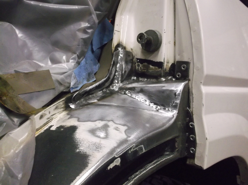

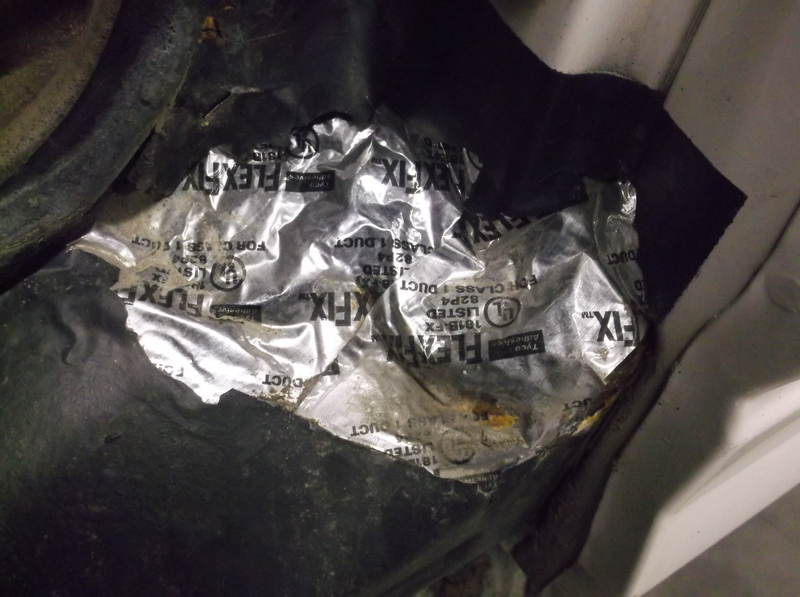

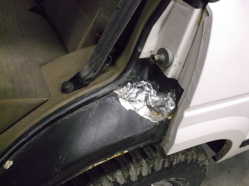

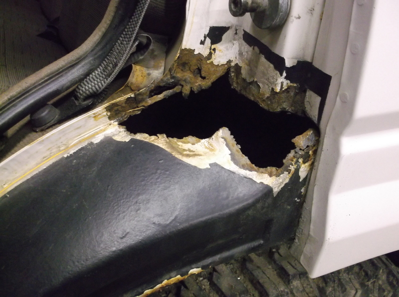

Alrighty........That snow woke me up to the fact that I have that other C pillar rust repair to get to. With the snow mostly gone & a trip to the car wash yesterday.......time to take a look while the weather is decent again....
So.....Some ones idea of a repair......
This is like unwrapping that unwanted birthday present from your creepy uncle....
There she blows, in all her untouched glory......without picking, it extends into the interior......AWESOME!!!...
I'll admit, for a minute I thought about getting some more of that flexseal tape...but that wouldn't be much fun. Might have to work backwards on this side, it's pretty bad....a number of bends and curves are supposed to be there.....we'll see, I may just do away with the bends, curves, indents and make it as smooth & straight as possible. I'm back to useable metal without trimming, any more than that the wheel needs to come off.....not going to happen today!

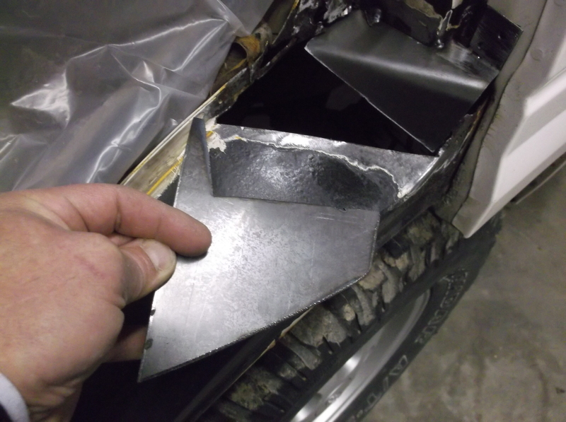

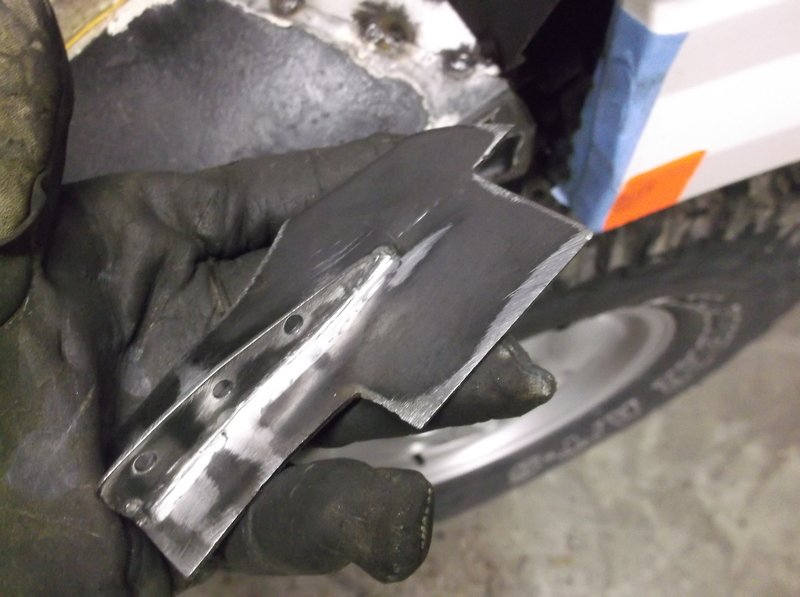

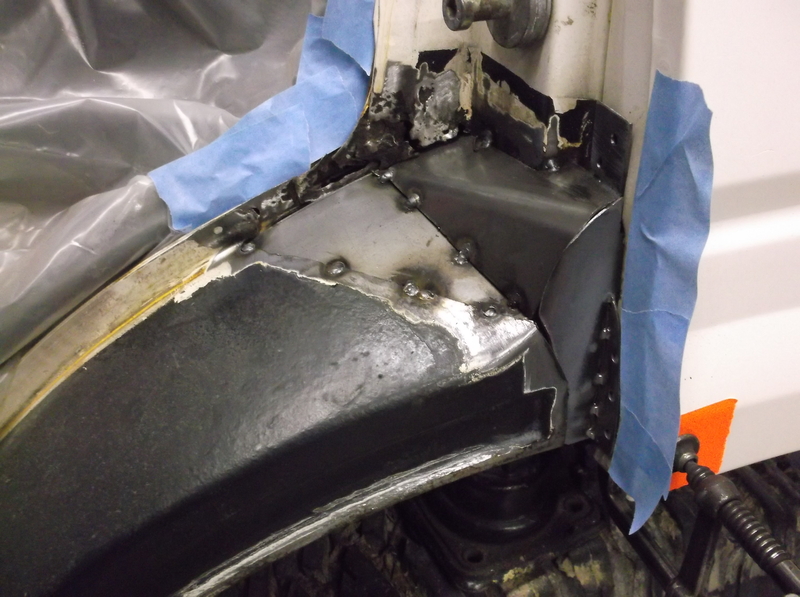

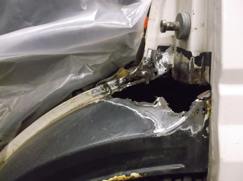

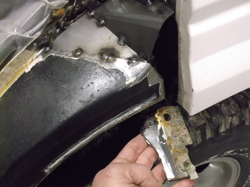

Well........This one wont rust there again......While extremely frustrating and I really don't enjoy rust repair, the challenge is always a skill's sharpener, this one more than most. Picking at it last evening after work....it just kept going and going.....it was a puzzle to repair....I ended up doing it in strips & pieces filling in and building out. Again not wanting to 'gut' the interior, on most of the interior side I used 3/16" rivets as well as some light welds, didn't burn it up. The lower inner wheel well body mount was gone on this side as well....just repeated the previous procedure. This side was WAY worse than the other, additional spots needed attention......all in all, I think I have 9 hours into the repair.
That upper, roll down transitional lip has to be there, but the large dimple for the child safety lock does not.
New fender to body connection
Semi cleaned up..

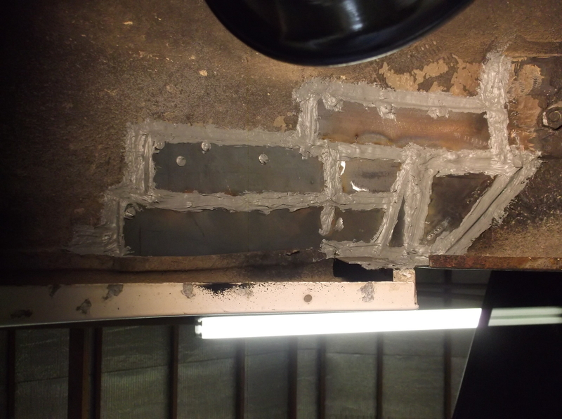

Upper internal patch work & seam sealer..
I didn't photograph all of it, but hopefully you get the general idea....

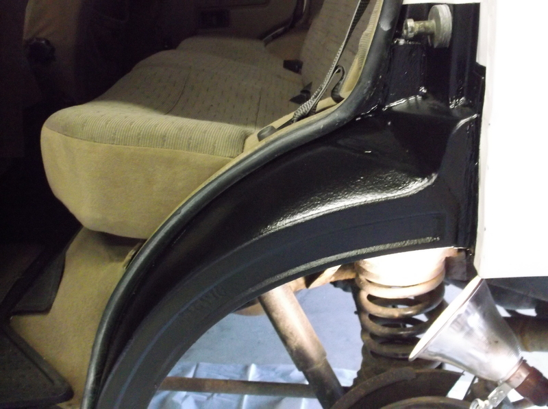

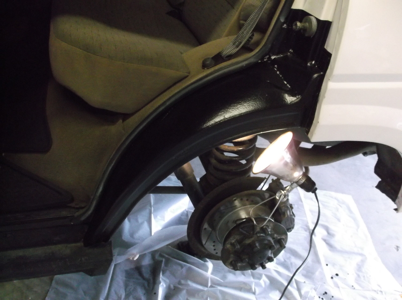

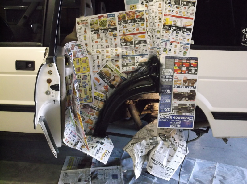

In the end, considering the damage....I'm pretty darn happy! I doubt my rear door will rattle open again....that rear quarter was just floating. Very solid now and just in time as we're looking at 4 days of rain ahead. Inside and out, I used Duplicolor Bedliner spray to seal it up & finish it off. Black can formula in the wheel well, blue can for the xposed entry surface.
