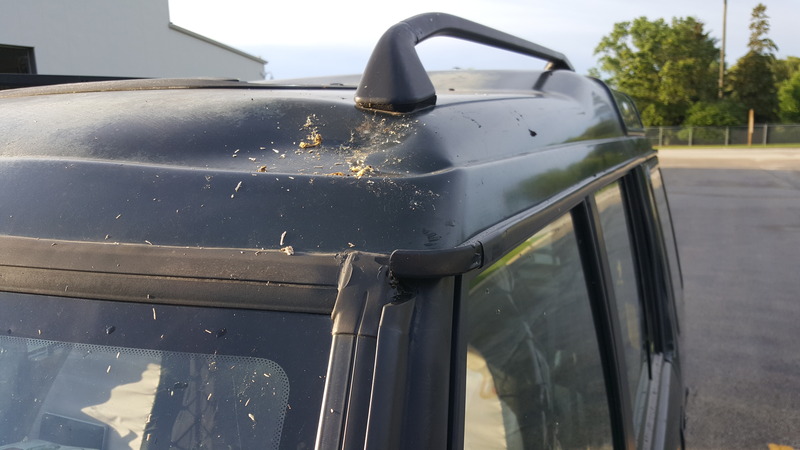

Started off by finding a 6ft long by 3 inch diameter tree branch laying next to my daily driver and a nice dent on my roof.

I suppose it could have been worse and been my windshield but it still hurts.

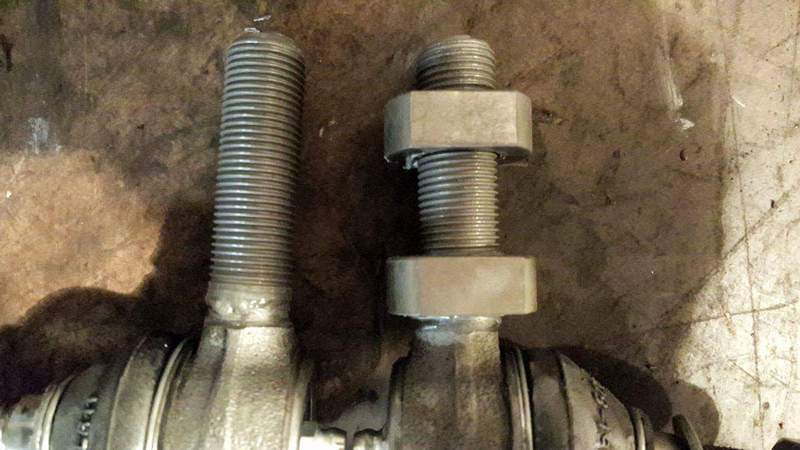

My Jam nuts from RTE came in yesterday so I figured I'd were the night up with something easy by installing the track rod . Yeah right!!!! I was supposed to get 1 left and 1 right land thread nut. Well despite the R and L written on the nuts I received 2 right hand thread jam nuts!!!!! RTE is supposed to be sending me one tomorrow.

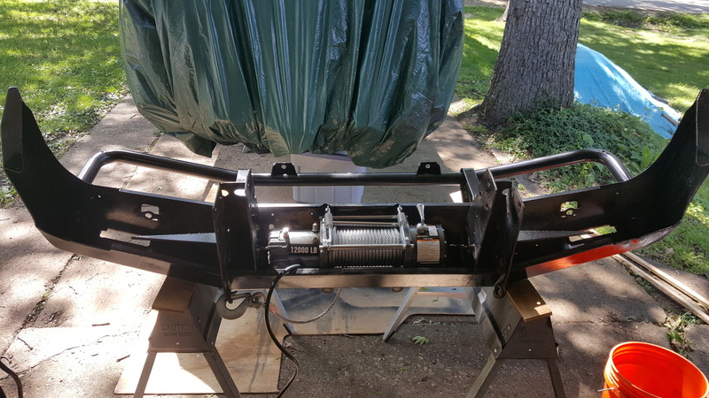

Installed the Harbor Freight winch and mounted the front bumper.

Mounted the HiLift to the front bumper.

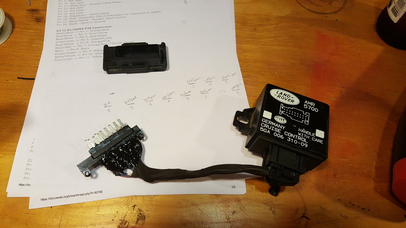

Made up a D2 cruise ECU adapter.

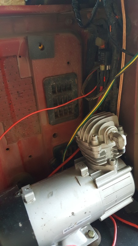

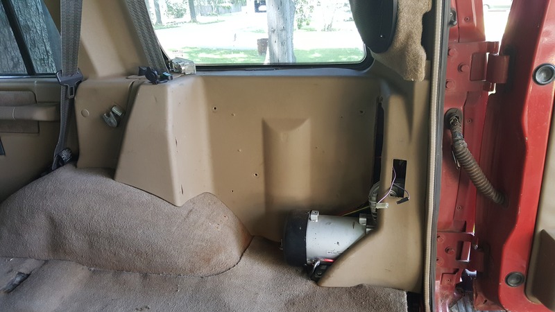

Lots of wiring in the cargo area. PUMA compressor tucked in its new home. Used old shock bushings for rubber feet to dampen vibration.

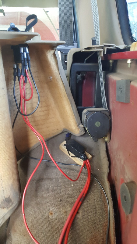

Power distribution block taped up and secured. Wires running up to 12v socket and switch for compressor.

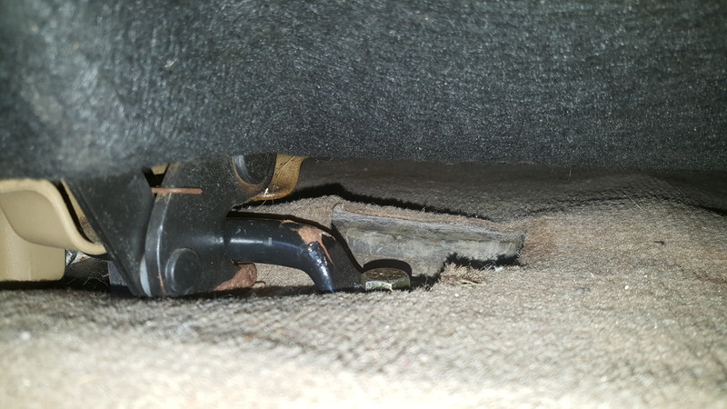

And someone asked about how the D2 resr seat locks into the floor.

Do you have room to get at the winch cable release ****/handle from above, or is it reachable from underneath?
Also, are you adding another battery? I've heard the amperage draw on those 12000 is pretty steep.
Anyhow, looks like you been pretty busy, keep up the good work.
Brian.
Have to give it the old reach-around from underneath to turn the freespool handle.
No second battery for now.
The HF winch was never part of my plan and just kind of a last minute acquisition. The MileMarker winch that was in there needed new cable, contactor, amd fairlead. And my Viking GS-9 winch with synthetic line was too wide to fit. If I end up keeping this truck I'll probably end up swapping out the bumpers and winch.
