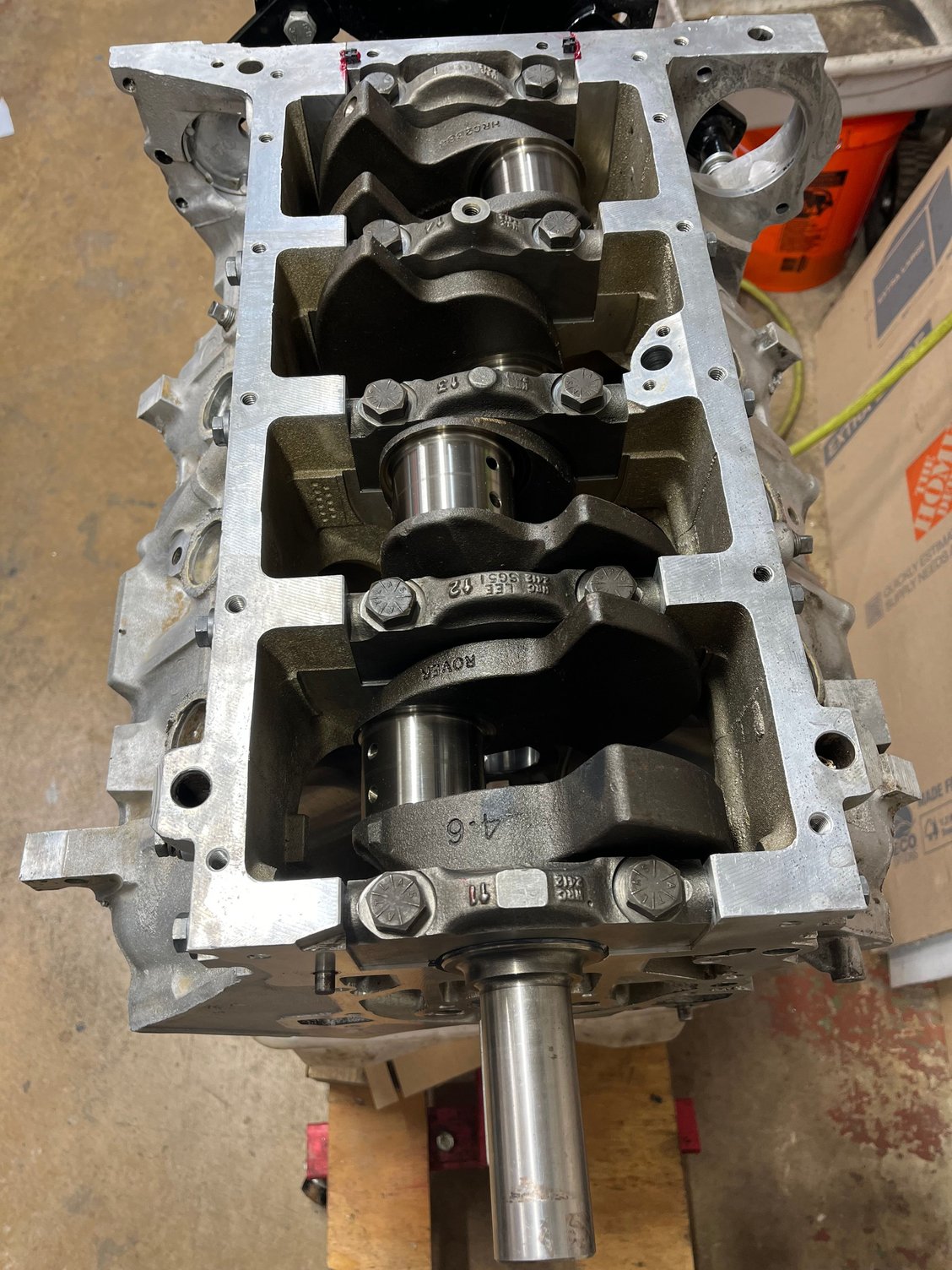

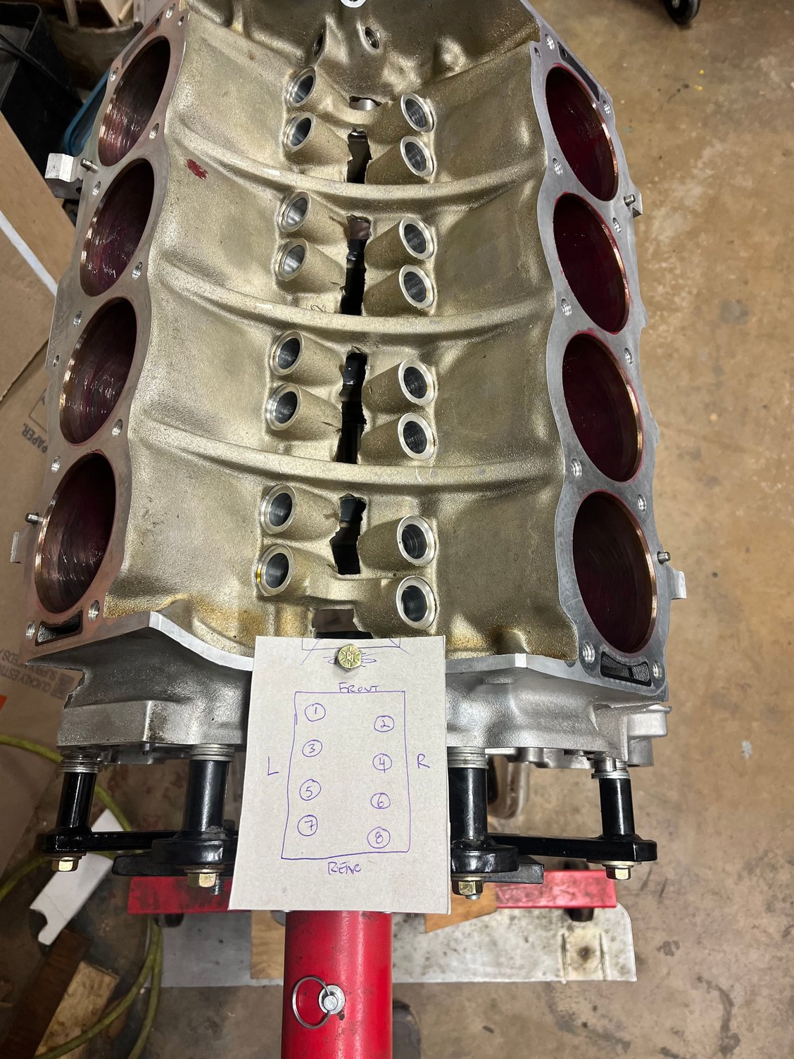

Alright…. I didn’t just come here to gloat about taking a trip to Colorado for 2 weeks in a 16yo vehicle and having no car troubles….

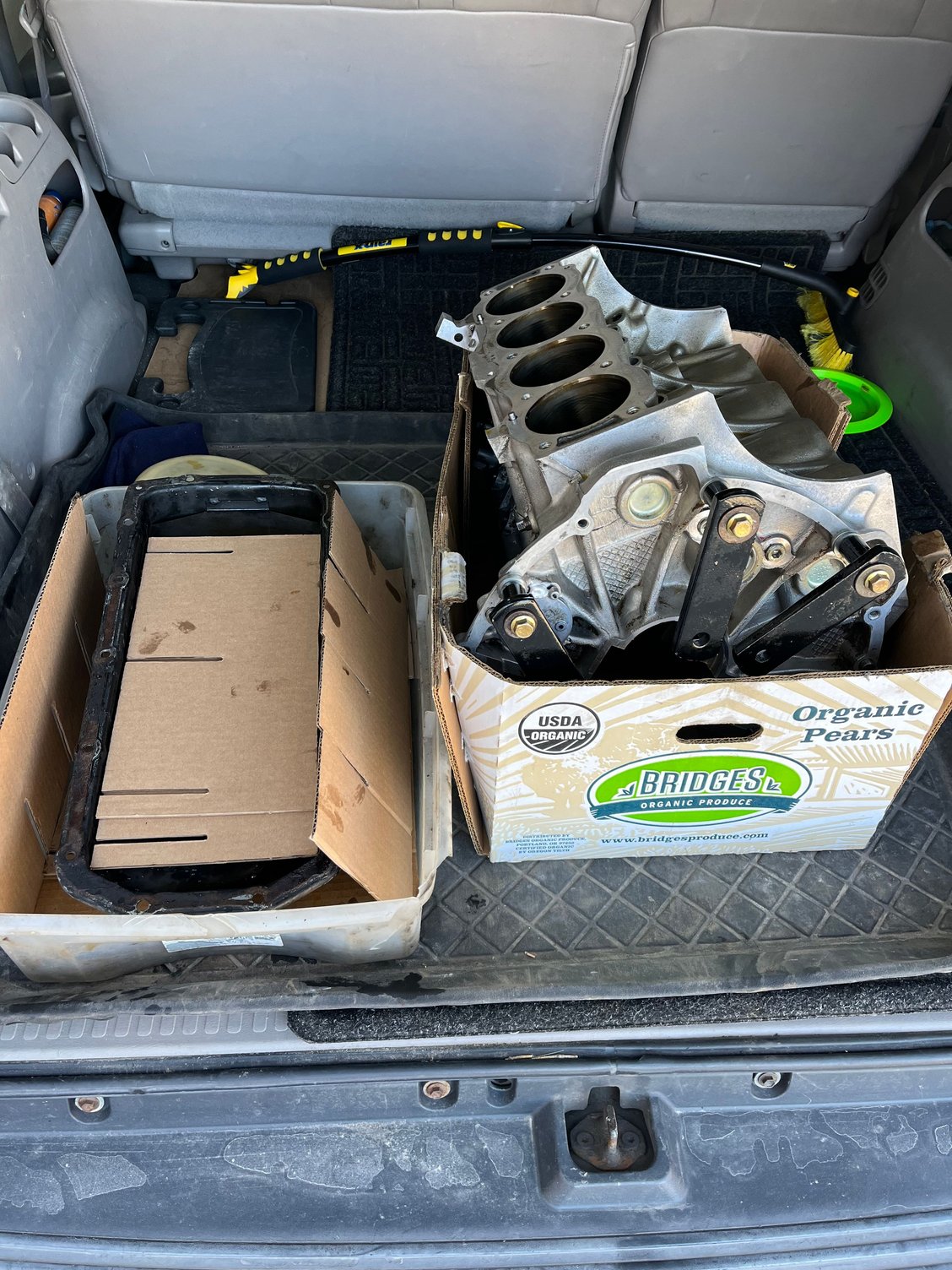

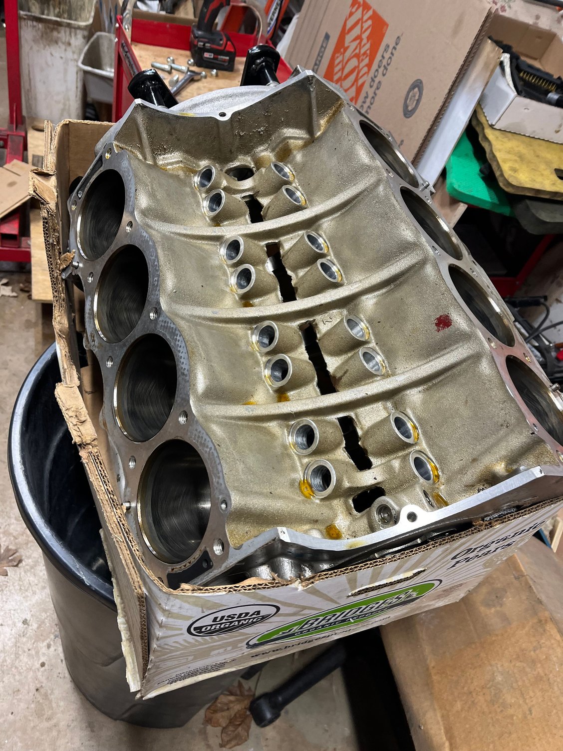

I finally pulled out my 4.6 14CUX engine that I had stripped bare 5 years ago along with all the boxes of parts.
Used the ultrasonic cleaner and pressure washer at work to get the caked grime off.
Looking pretty good.

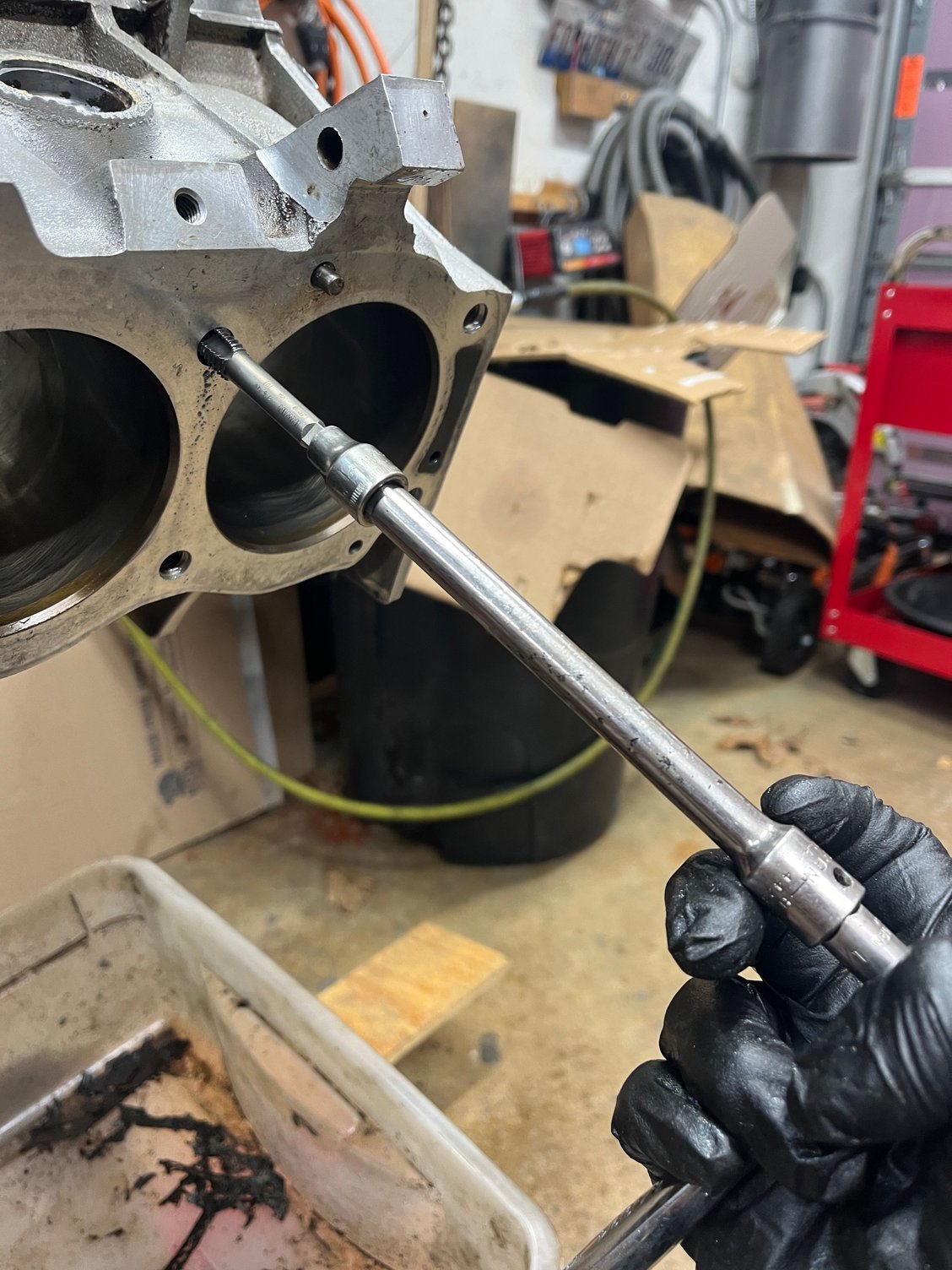

Chased all the head bolt holes with a tap and was shocked how many filings came out.

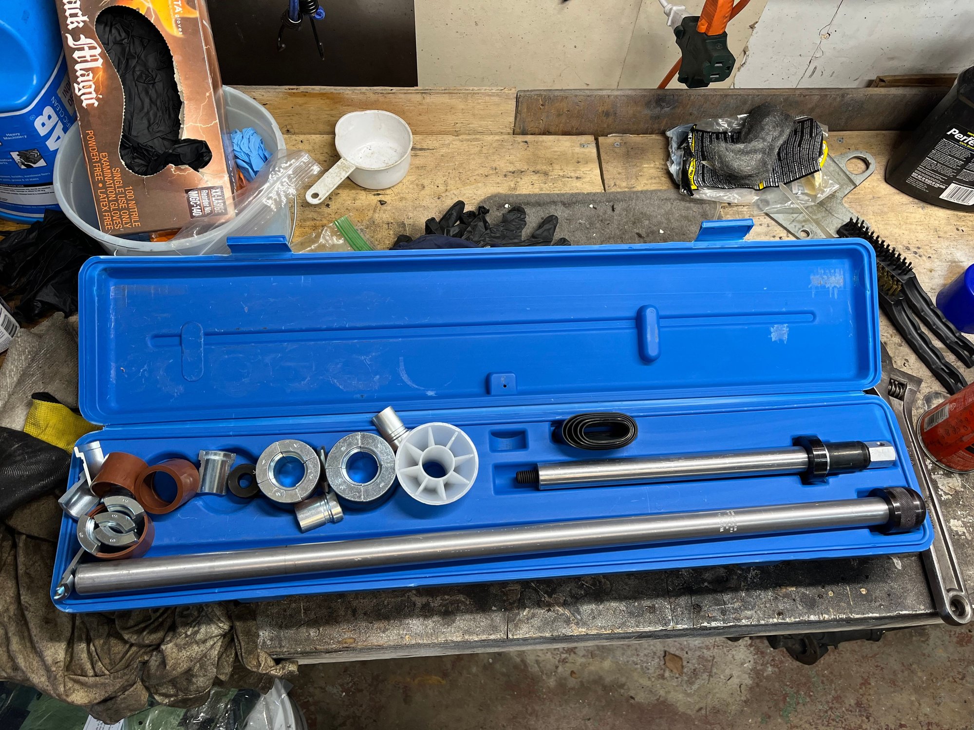

Knocked in some new crankshaft bearings with this guy. Now I get to store this large tool until the next time I completely rebuild an engine.
4.6 crank installed
Cheat sheet for installing the pistons and caps.

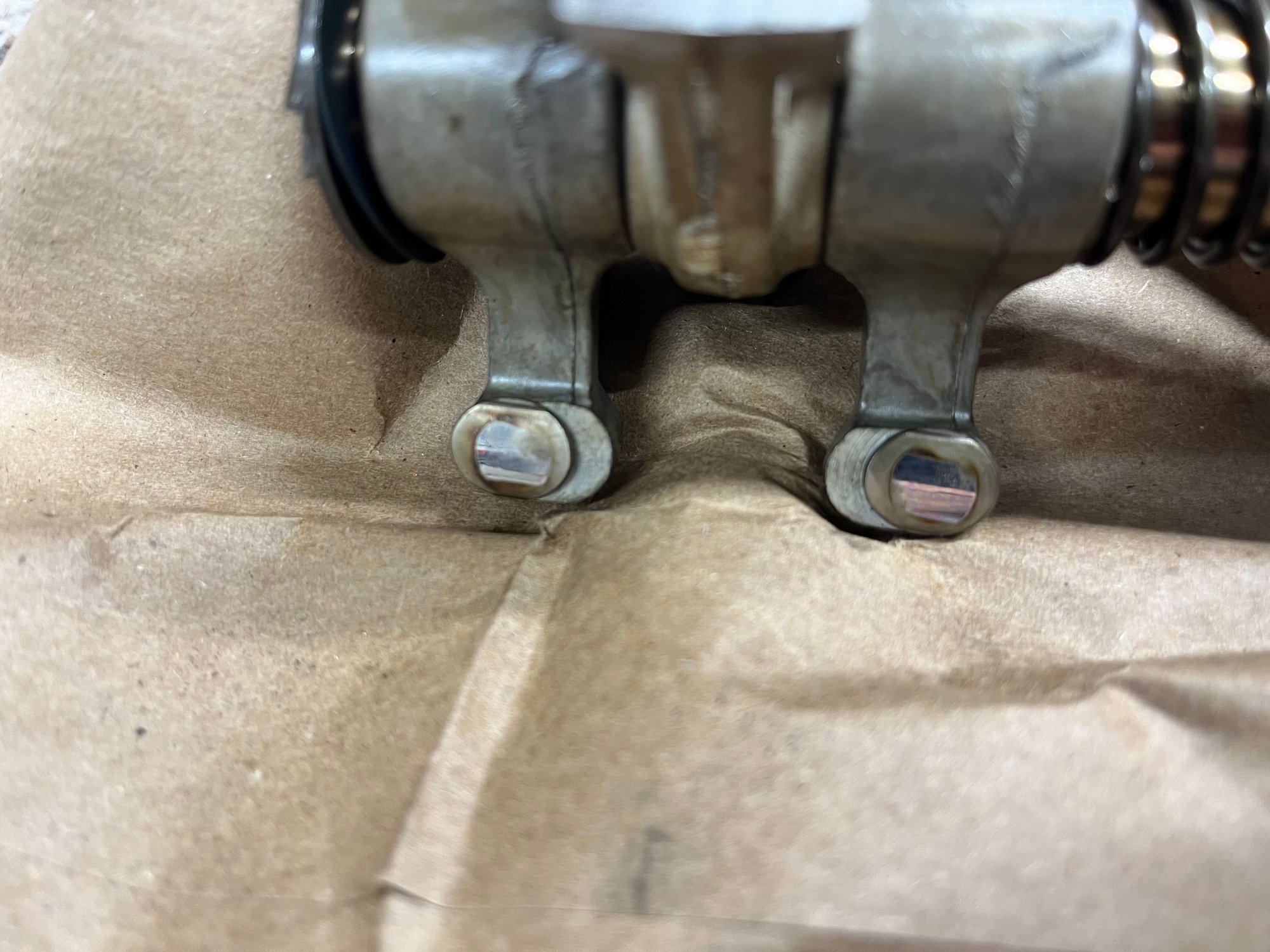

And decided to buy new rocker arms and push rods based on current ones condition. No sense installing new Crower lifters and camshaft with crappy rocker arms and push rods, I suppose.
