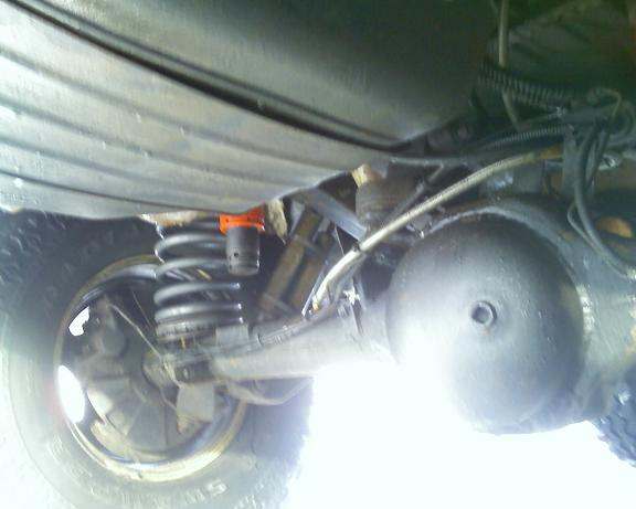

Ordered two 8" sewer caps for my diffs. $67 shipped for both from Fluid Design Beta - Butt-Weld Cap, Sch-40 (Std.)
They're 3/8" thick and will replace my AT diff guards.
Will end up looking like this.
Also got my welder and Plasma!!! Gotta return the crappy Harbor Freight cart because it's too small, I may just weld up my own cart.

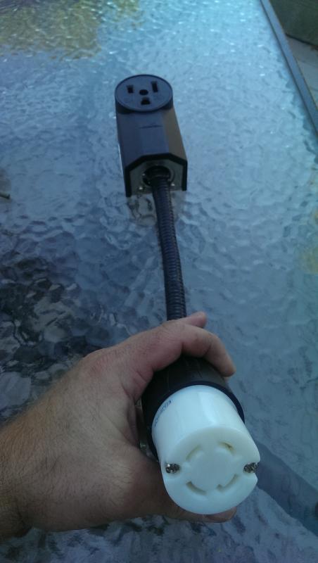

I managed to get my garaged wired up for 240VAC. I installed a new breaker in the panel and ran conduit and 4 10GA wires from it to the front of the garage where I installed a generator receptacle. When our power goes out it(which it often does due to overhead utilities) I can plug in my generator and backfeed my panel(don't worry I shut off my main breaker). Otherwise I made up an adapter and can run my welder and plasma off the same receptacle. It turned out pretty well.

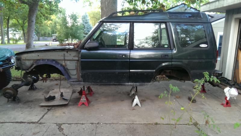

Front and rear axles and suspension are completely dropped. Front bumper is yanked.
