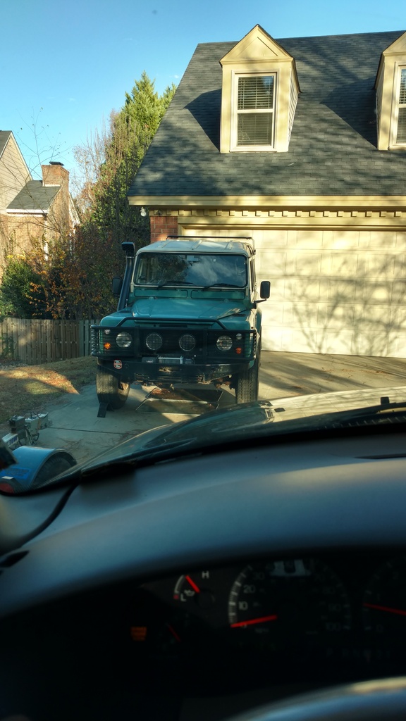

Here is the drama queen at home in her spot in the driveway. Hoping to get her in the garage this weekend. Still have to finish unpacking in there... Not to mention install the new garage door opener, if Sears ever comes through on the extension kit. My door is a 8 footer
