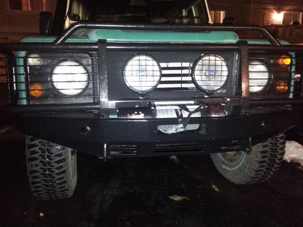

I spent the rest of the afternoon putting the grill, light surrounds, bumper, winch and brush guard back on. I replaced a few burned out bulbs and all seems well.
I'm going to try and put a few more miles on it then drive it to work on thursday.
Only real problem I'm noticing so far is she is only warming up to about 1/4 on the gauge. Some checks with the infared thermometer seem to agree with that. I might need to get a grill muff thing for it to restrict flow so I can get the engine fully warmed up and the heater going full bore.
She definitely runs cooler now than she did before all the work.

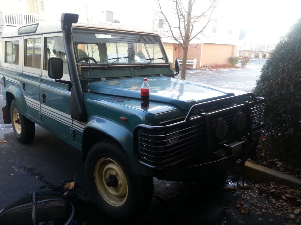

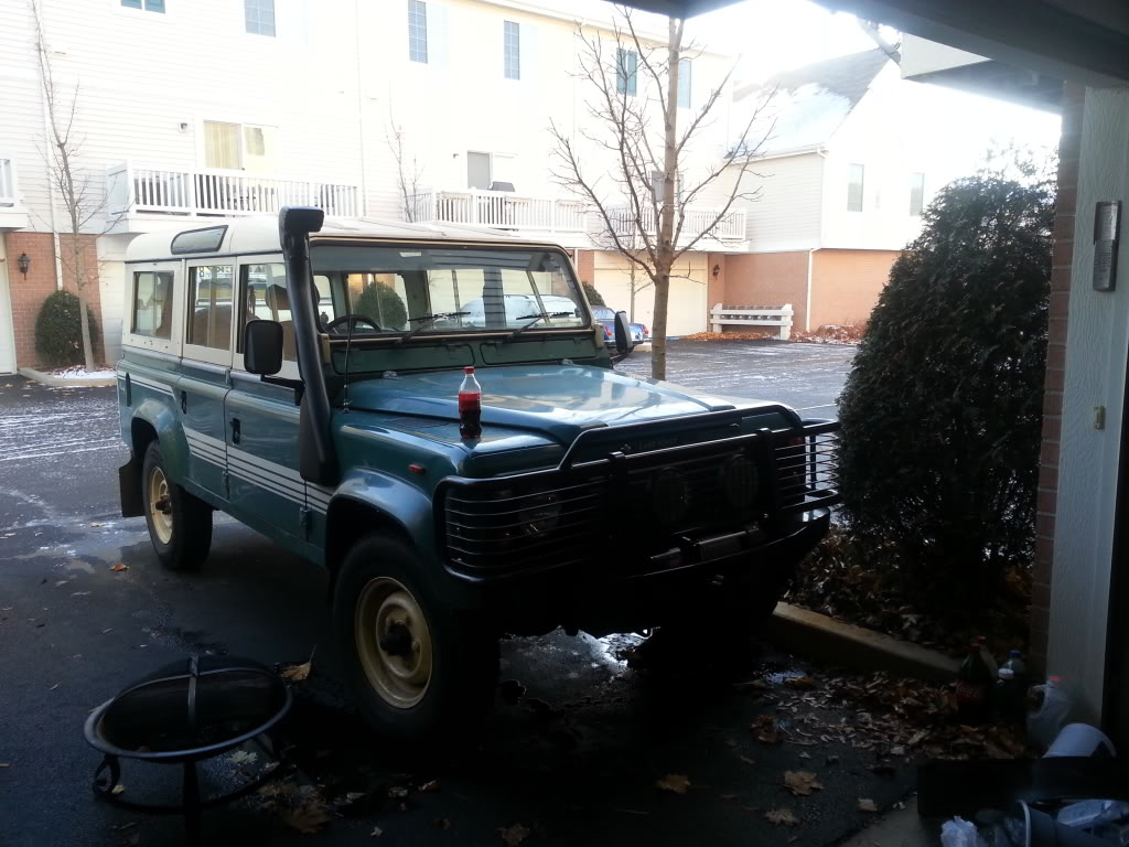

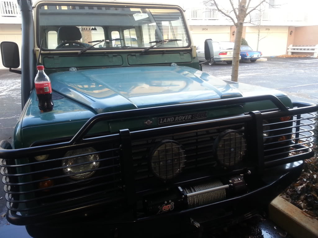

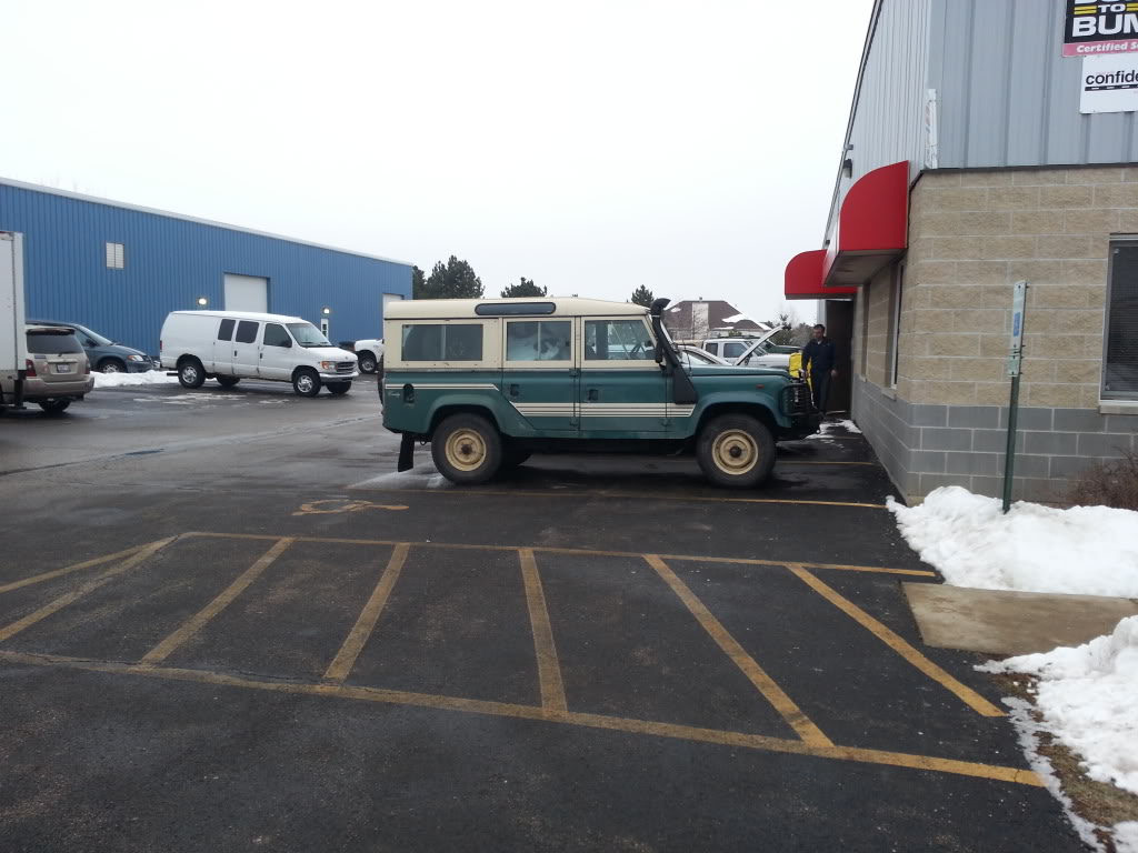

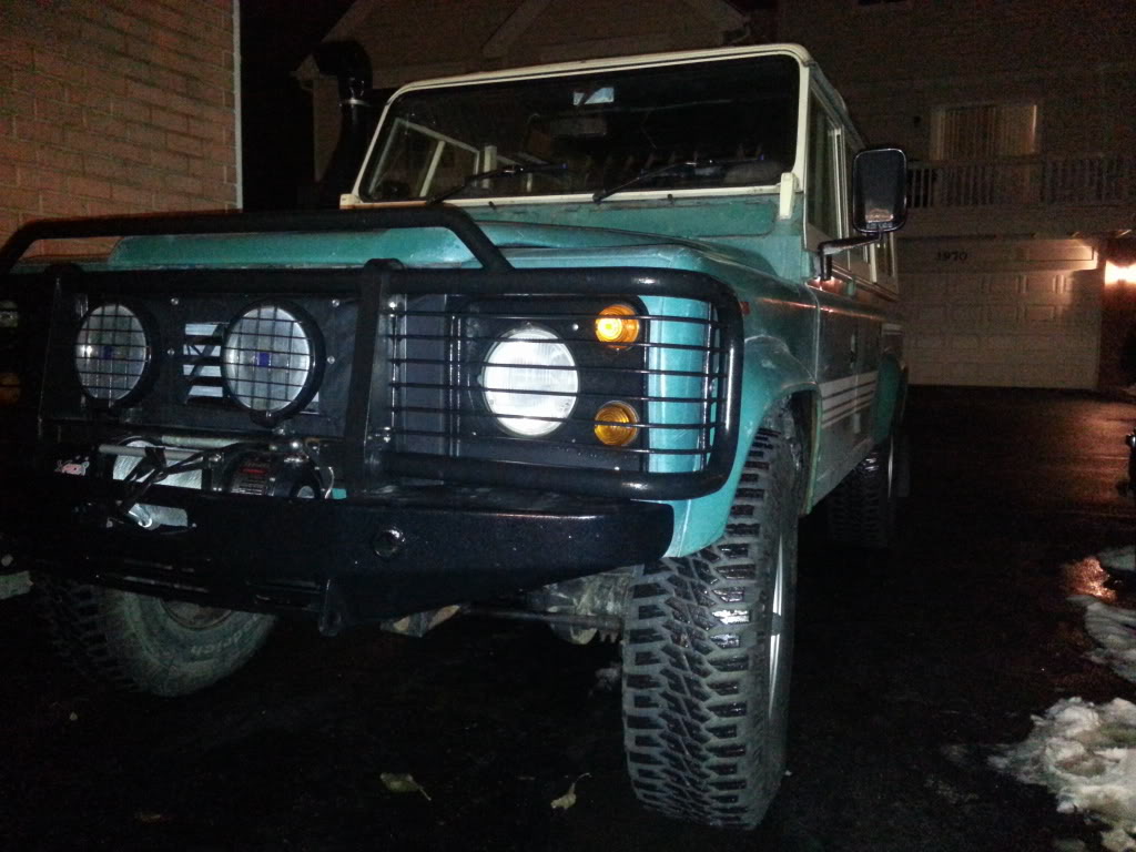

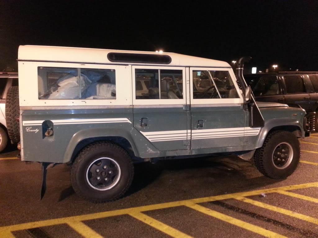

Today was a good day, got the alignment squared away, then the new rims and tires.
Before:
After:
