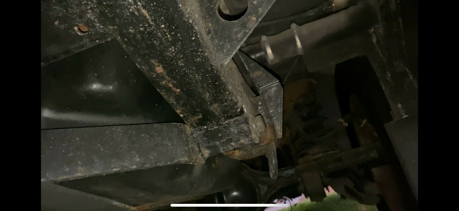

2004 Discovery SE7 (Not sure what the "7" means) with 106,000 miles with very light structure rust from the looks of it. At least I can't stick my finger anywhere within the frame that I'm not supposed too.

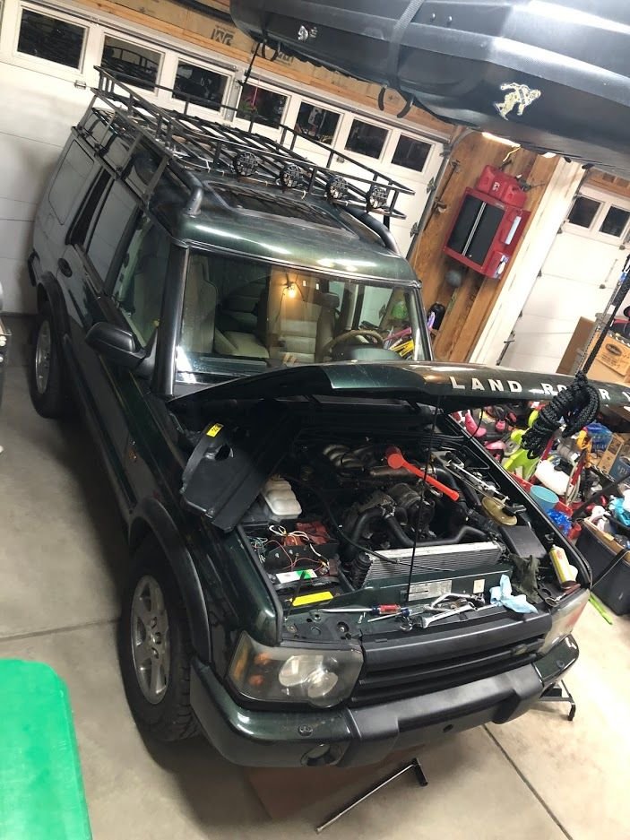

First night home with new toy
Rear Tear Down

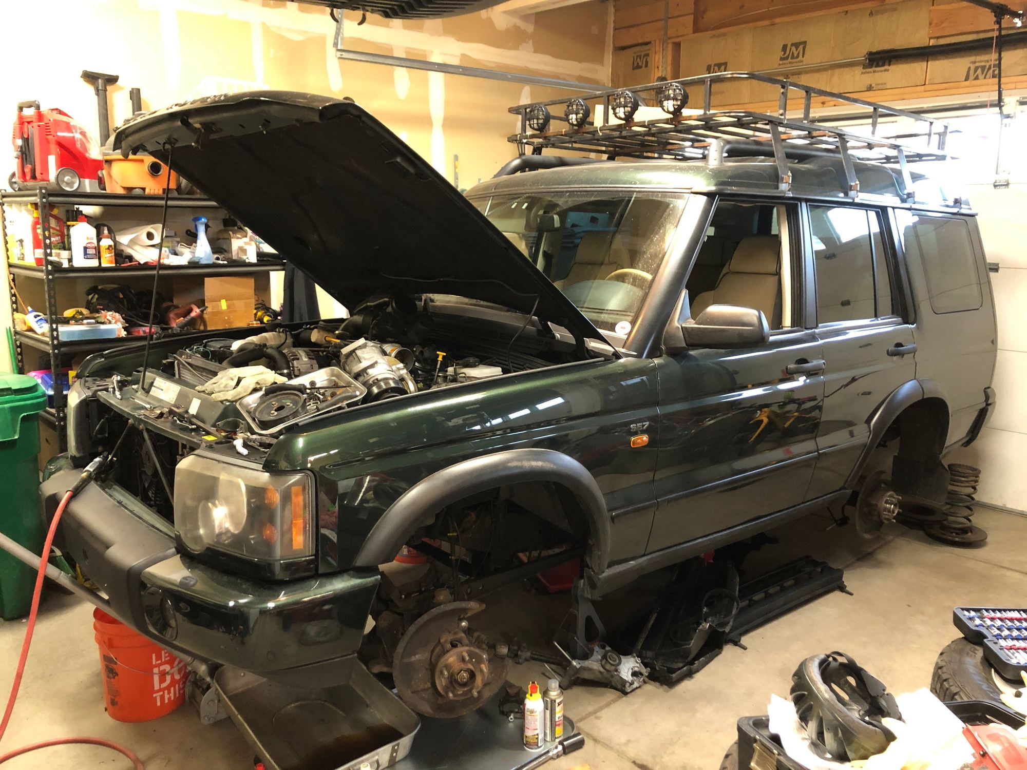

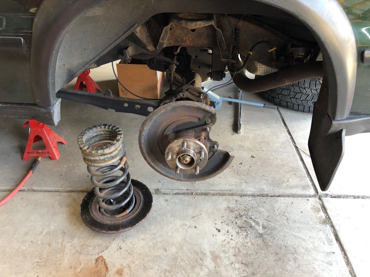

Suspension is out, brakes are off, Power steering pump is off, coolant systems tested and topped off...waiting for parts...

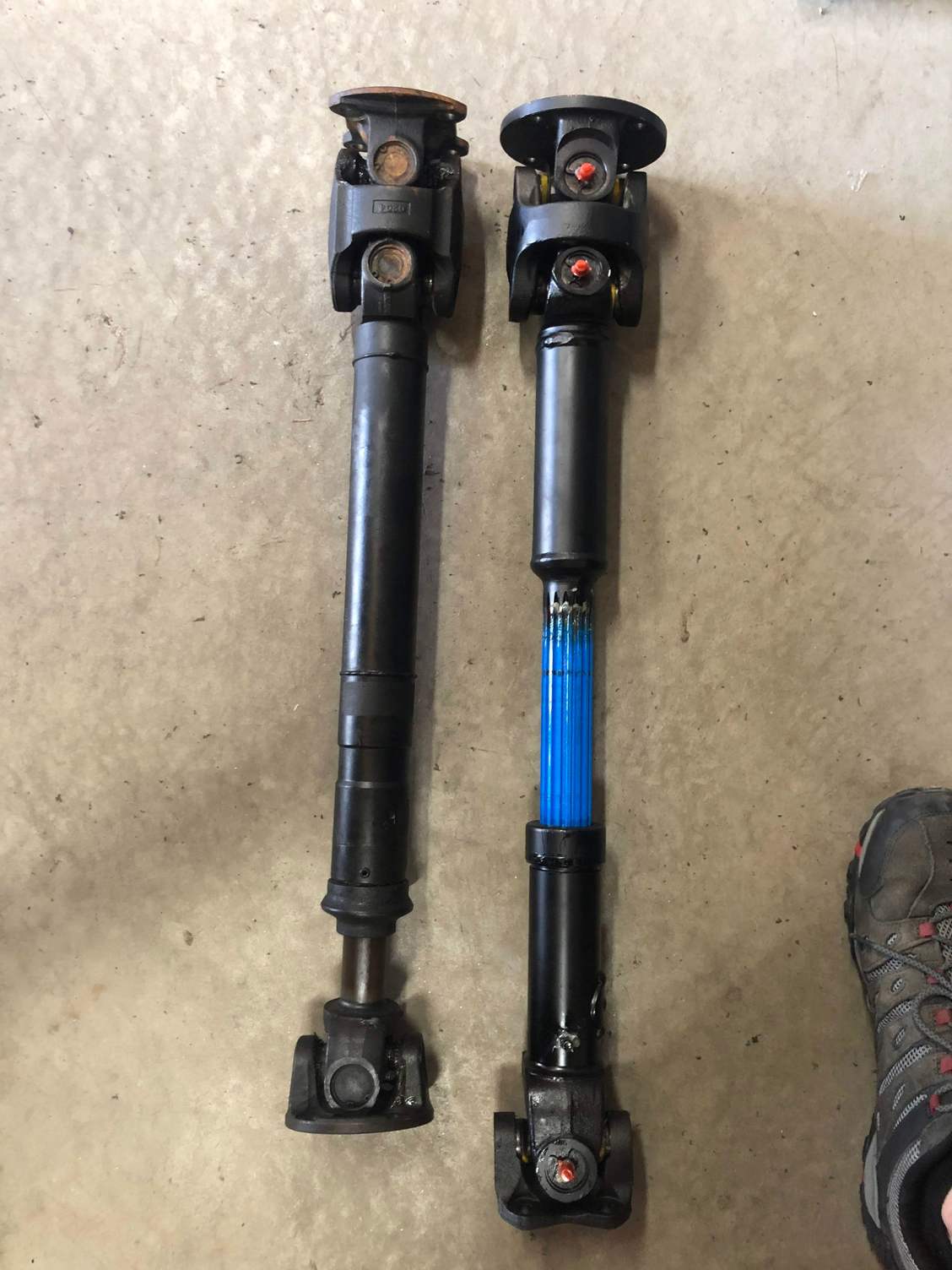

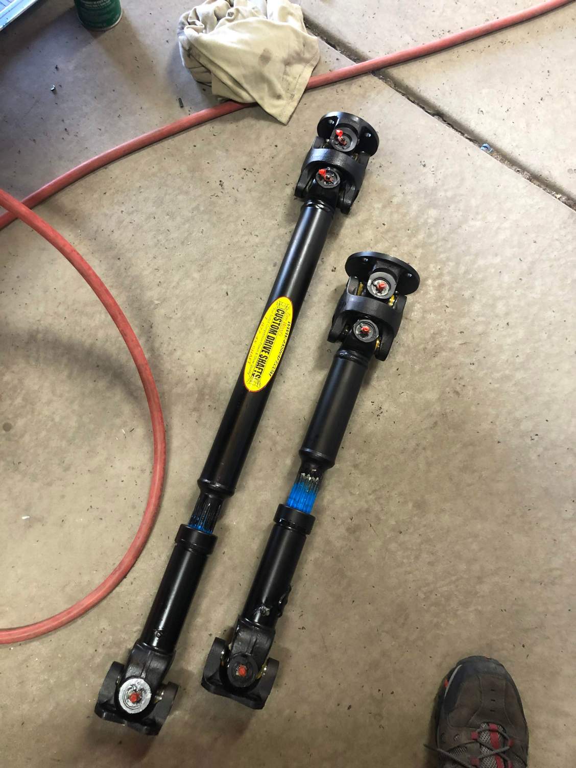

I did receive my drive shafts last night and installed the front with no issues.
New Woods rear and front driveshafts
Stock front on the left, Woods front on the right
When I went to install the rear, I quickly noticed that the rear flange is the rubber donut type, so now I'm waiting on more parts, picking up the rear flange conversion.
This should be all I need, right? No spaces or anything?
