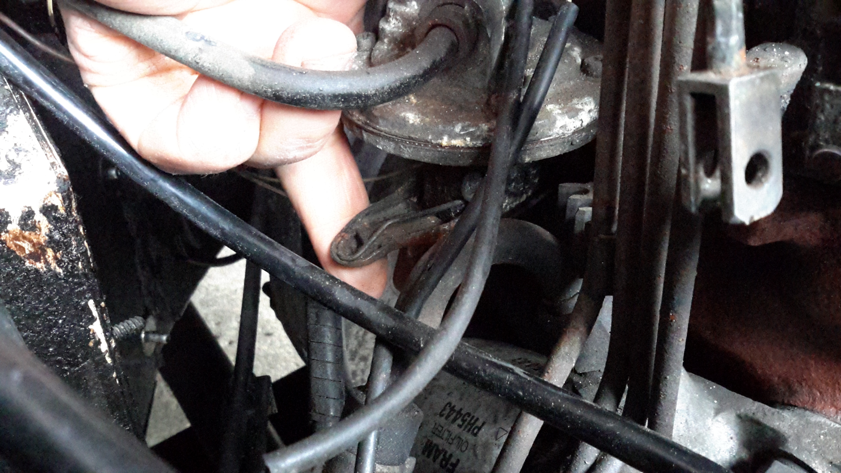

3rd The fuel filter is not mounted to anything and I was wondering if someone could send a picture of where and what it is suppose to look like and where it is suppose to be.

3) just google 2.5 TD land rover fuel filter, see example

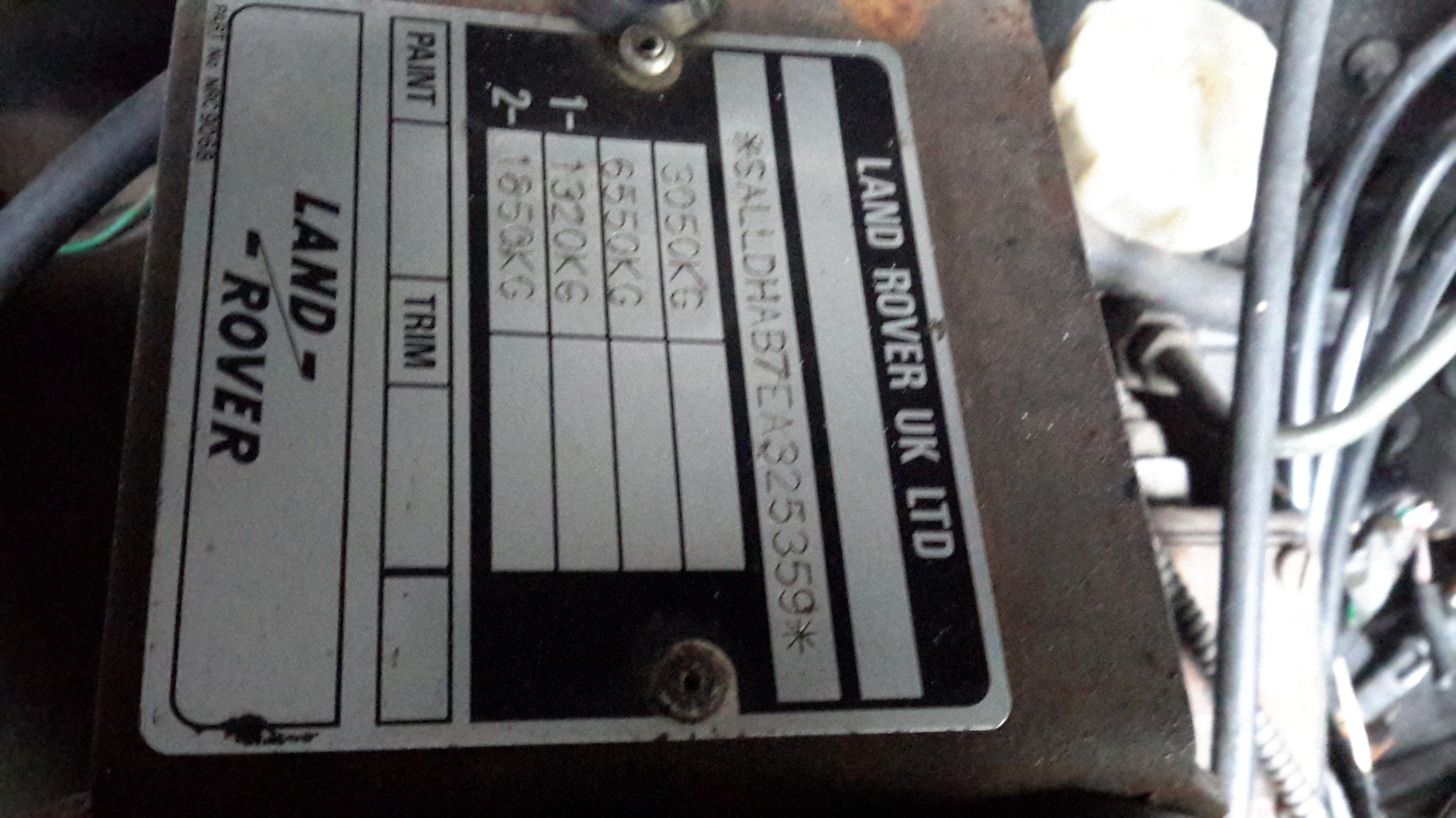

1st is the VIN # you can probable tell what engine is in it by that. I think it is a 2.5 turbo. You will probable know better then me. and I am suppose to fix this haha

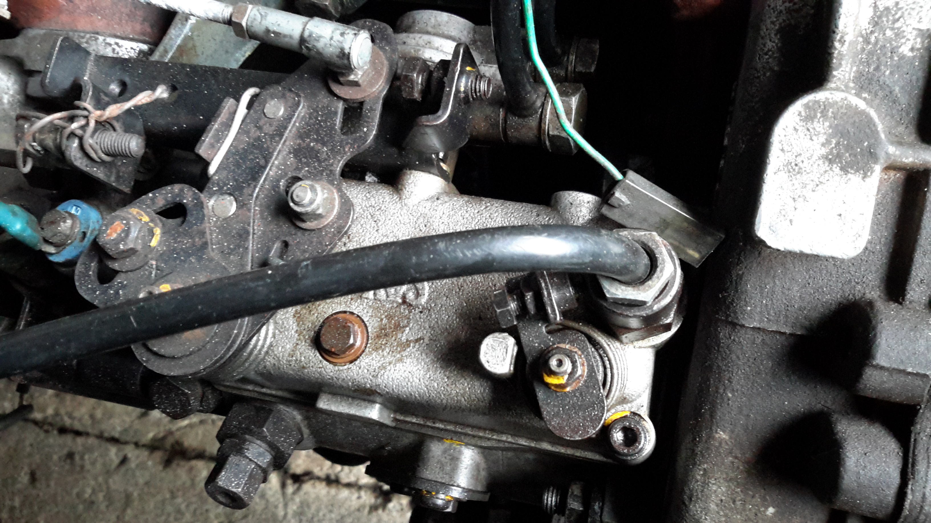

2nd picture is, I don't know, you tell me....

2nd photo is Injection Pump

Look at the fuel filter assembly. On the top there is a bolt usually a 10mm that you turn open until you see a hole appear in the bolt, this is for bleeding air out. Once you have fuel coming out of the hole everything between the tank and the fuel filter assembly is bled. Now to the injectors.
