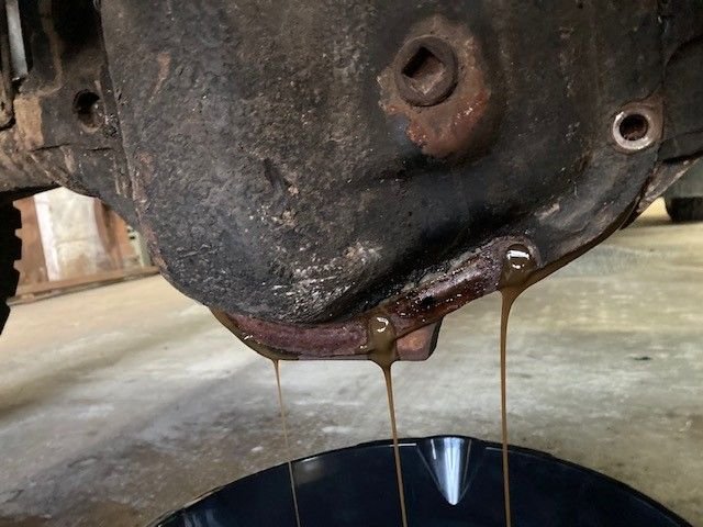

So i did some investigating on my clunk last night. I'm going to start with replacing the axles and drive flanges. I did change the diff fluid though. I think the PO liked to play in the mud. The specs I found on Rovers North say 2 qts of 80w-90 MT-1, but that doesn't get it to the fill hole. Can anyone confirm this is correct? Should I just fill it up as I would any other rear diff or is there a reason it's 2 qts? Thanks

Head gaskets are a common fail. And area you're discribing is most common area to leak.
LT77 transmissions are known to have poor output shafts. This shaft goes into transfer case and usually makes a banging between shifts. Very, very common problem.
Not a bad idea to start with fluids. Yes, axle fluid should come out of fill hole once full.
Don't be too discouraged, these things are just things that come with the territory...when purchasing an older vehicle.

Thanks for taking the time to respond. I'm glad to hear none of these things are out of the norm. There should be plenty of information out there to help along the way. I'm working my way through the axle bearings at the moment. I found they were a bit muddy upon inspection. I've built several old cars from Model A Fords to VW buses and bugs. I realize every old ride is going to have issues. I appreciate the advise and encouragement. I'm located in southwest Missouri about 45 minutes northeast of Springfield. I have the R380 transmission, is it known to have the same output shaft issues? Thanks.
