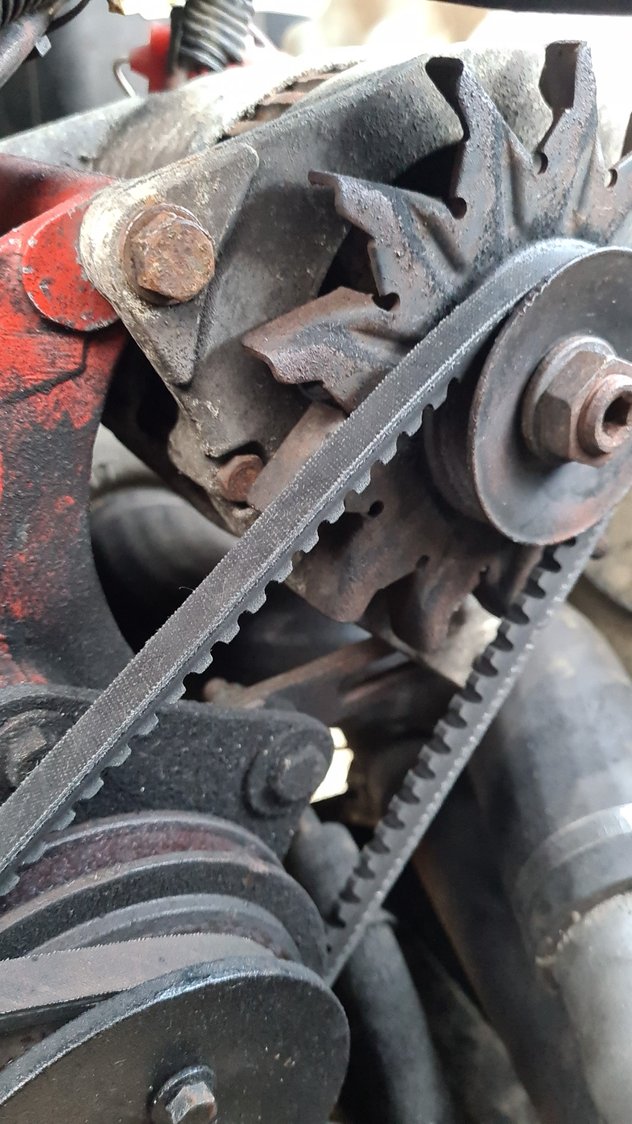

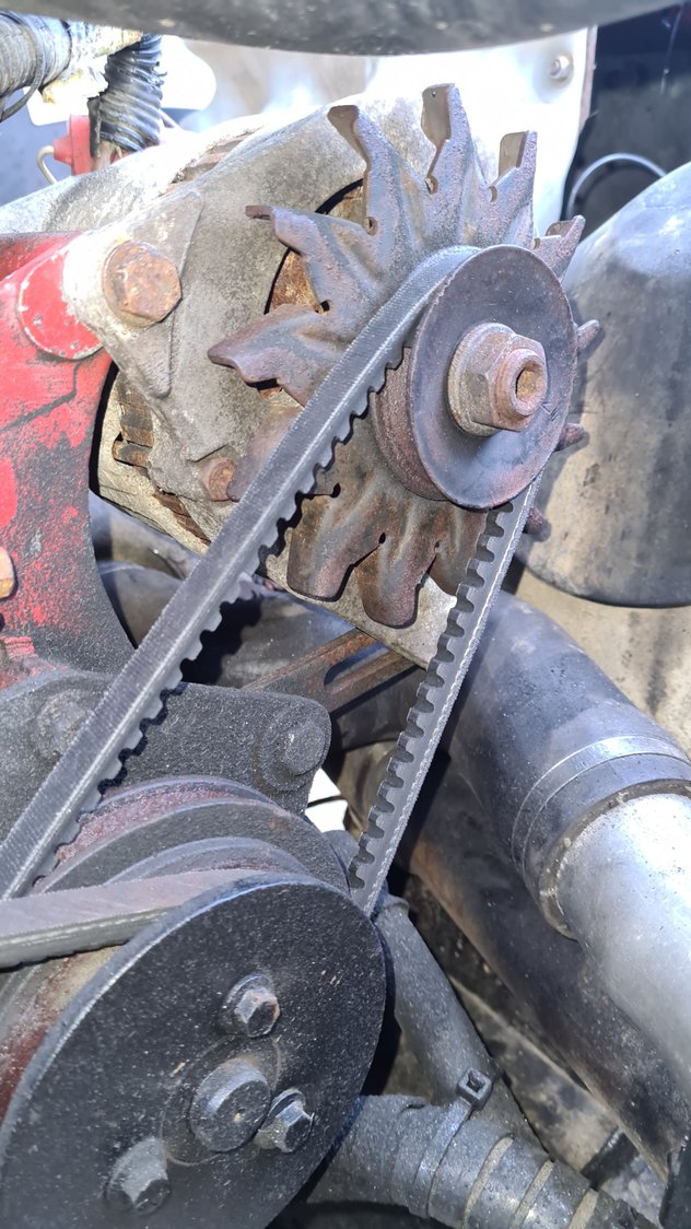

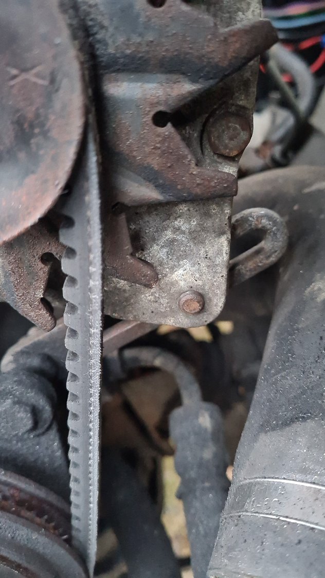

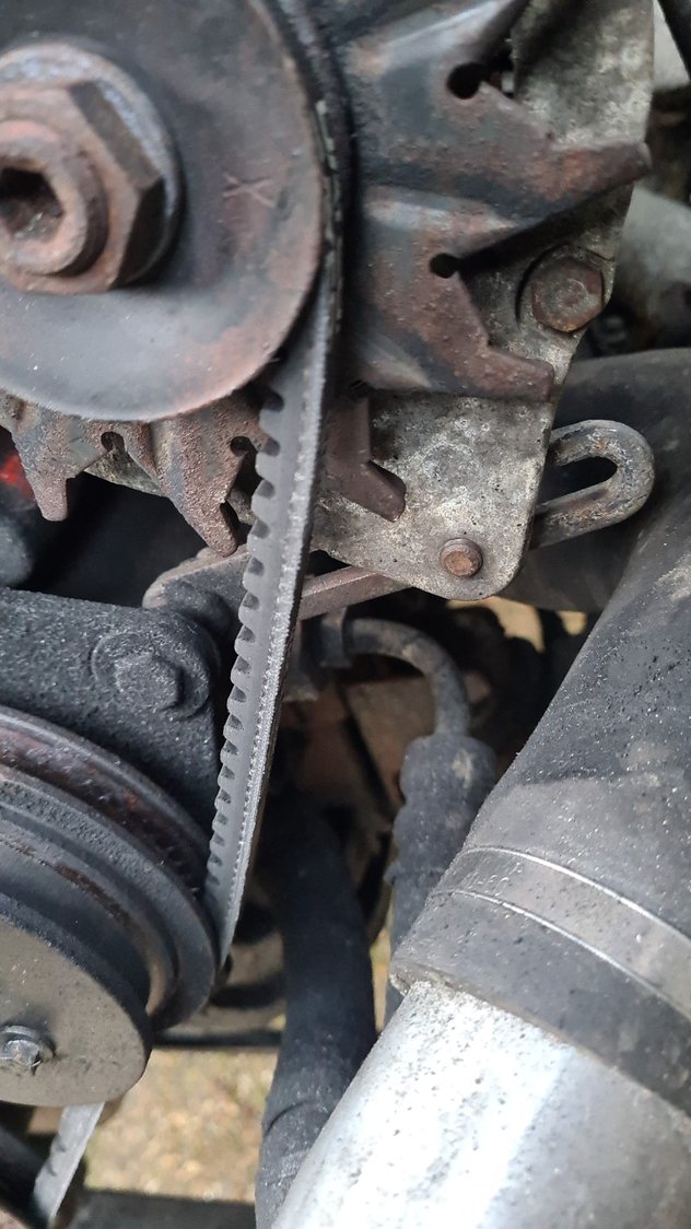

Pretty basic, just loosen the two bolts, upper is a through bolt with nut on back side and lower is a bolt. Both should be 13mm wrench or socket.
Quick question...do you think the bottom bolt is missing a nut? The reason I ask is that the belt has become loose again....maybe I'm not tightening it enough or my other though is the vibration is working the lower bolt loose.
Old Dec 28, 2021 | 06:34 PM
The Deputy's Avatar
Joined: Oct 2016
Posts: 4,865
Likes: 1,409
From: Michigan
There is no nut, originally. But, you could replace bolt with longer one and add a nut. Also, adding a flat washer to the bracket side will add more surface tension of bolt...which will increase holding power also.
Old Dec 29, 2021 | 02:29 AM
jonlenoury's Avatar
Joined: Dec 2021
Posts: 14
Would it be a safe assumption that this is an M8? I am loathed to take it out as I am not sure how easy it will be to get the new one back in? Will the entire unit drop down?
