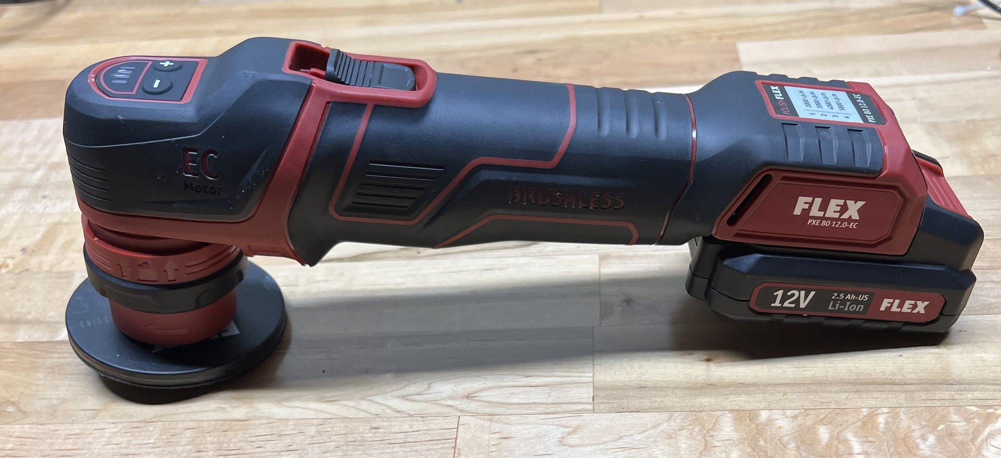

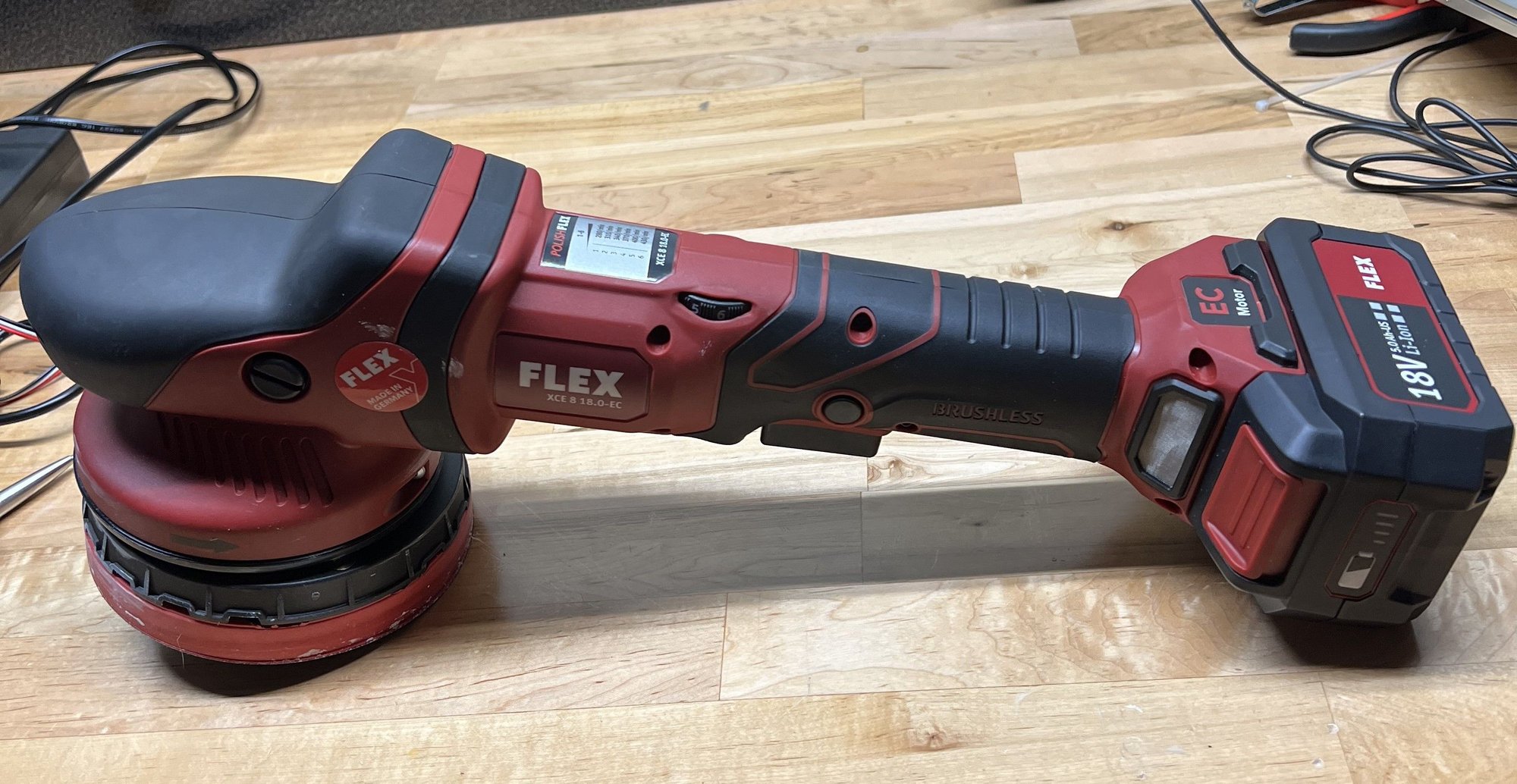

Flex XCE 8 18.0-EC (5 and 6 inch pads)
Flex PXE 80 12.0-EC (1 to 3 inch pads)

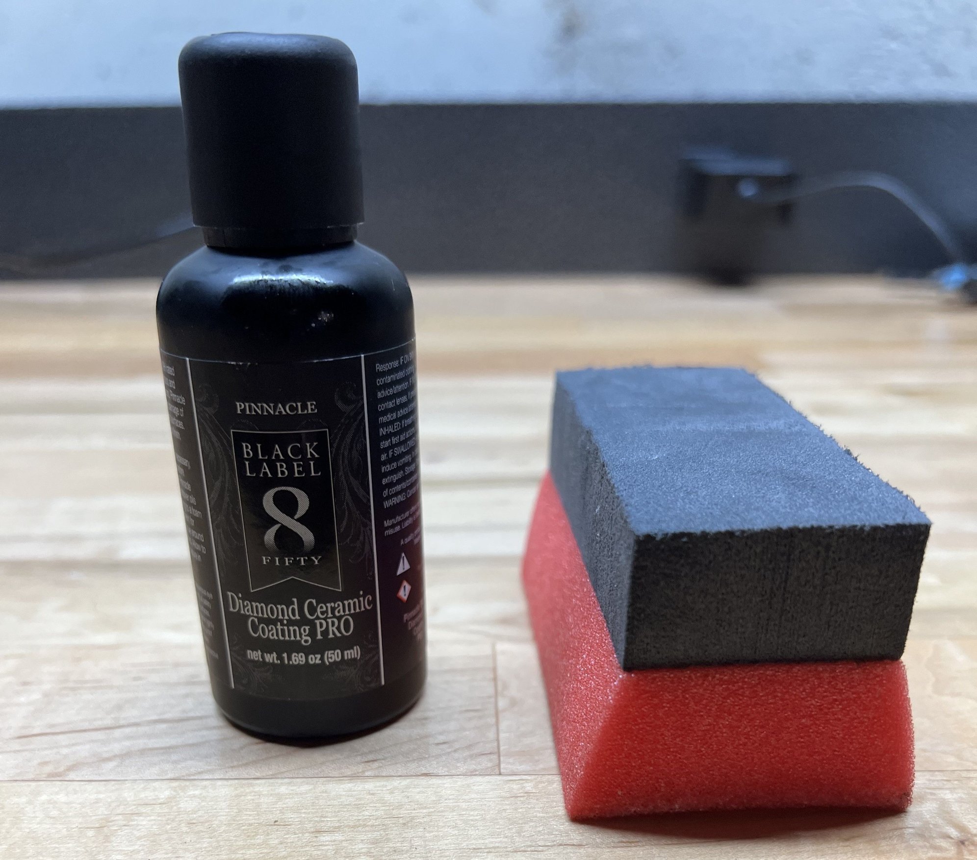

Ceramic coating:

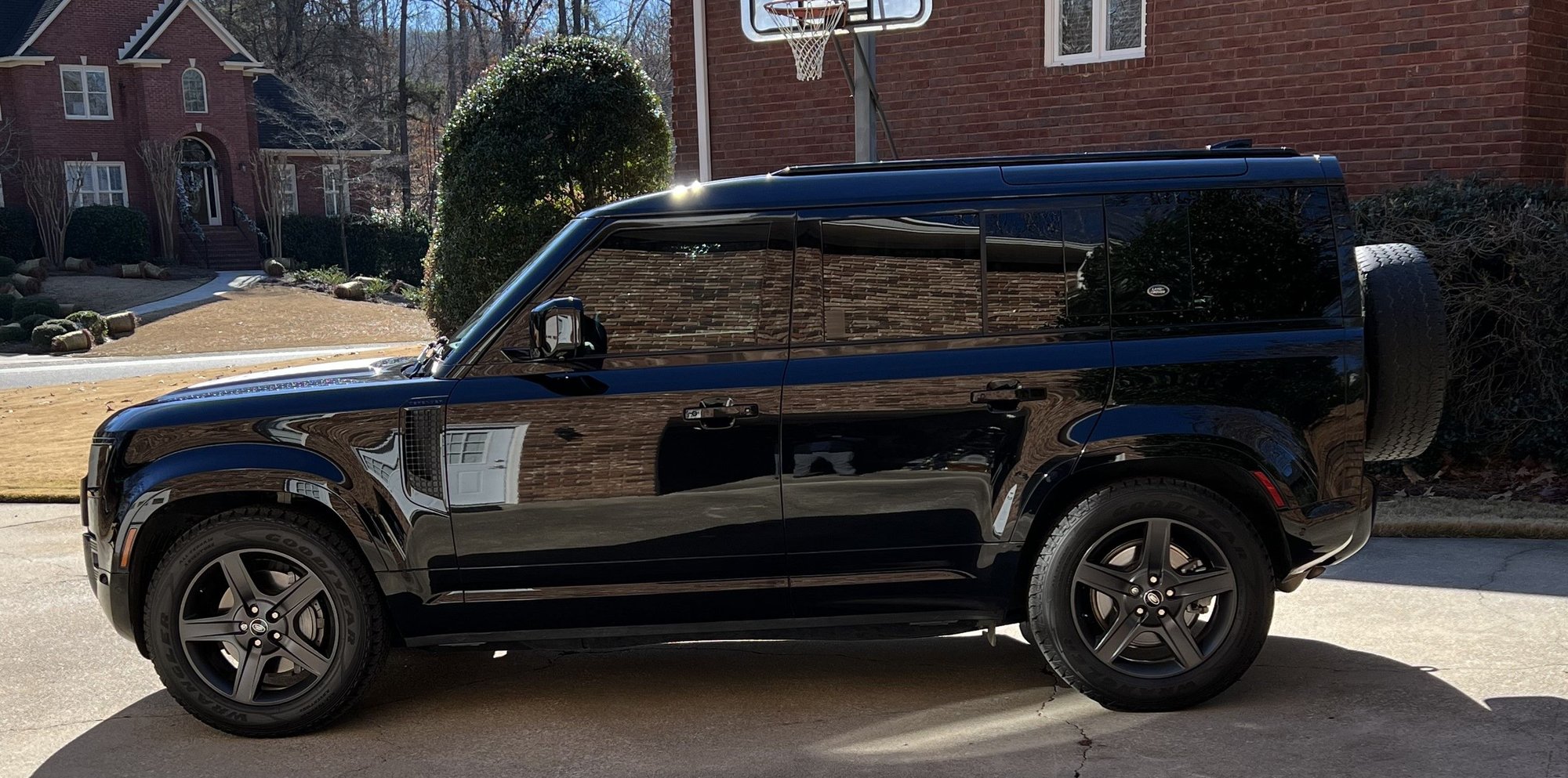

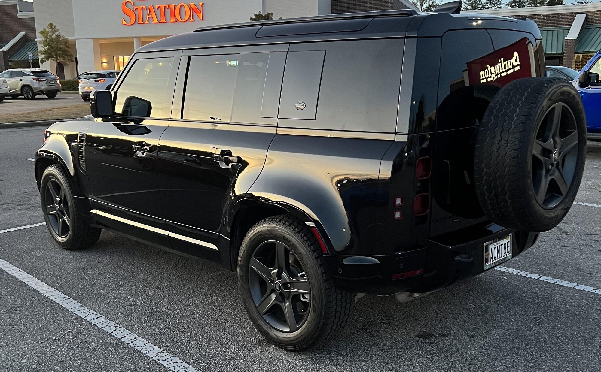

End Result:

Pinnacle Black Label Diamond Ceramic Coating Pro is fairly easy to use if you've prepped the surface well. I would call it a category 2 ceramic coating, with a category 1 being something in a spray bottle that lasts 3 months and category 3 being something a professional detailer might use that could last over 5 years with proper care. This is my own made up system of evaluation so take it for what it's worth. Given that, it should last 3 years with proper care. It is easy to apply and easy to remove. I did apply it too thick in a few spots that were about the size of my fist which left a distinct wet look that stood out. I can tell it was hard coating because I had to use the polisher and the 105 to remove the coating in those spots and reapply. Even with the reapplication in a few spots, it blended in nicely with the first coating. Here is a link to the product:
