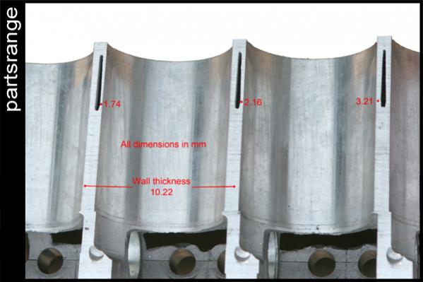

8. Water jackets have some smaller spaces, but there are also cracked blocks, etc.
Attached Thumbnails 1995 D1 Overheating Problem, 166,019 miles-rad-crud.jpg   1995 D1 Overheating Problem, 166,019 miles-2006_block_casting.jpg

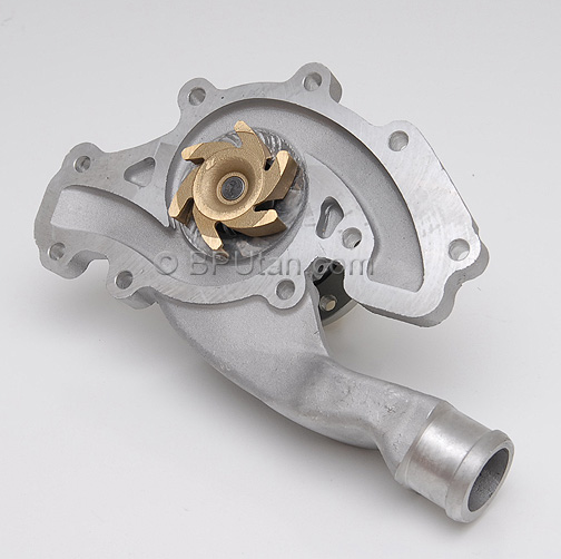

BP Utah and some others sell this sort of WP, which has a bronze impeller and moves more water. But overheating after a period of time makes me think of radiator not 100%, might want to check that out as well. Is the overheat at freeway speed or just in traffic around town?
Older water pumps wobble, leak out the front, and are generally scaled up inside.
Pix of where to put the 180F thermostat ($10 ish), spring goes inside the block.
Attached Thumbnails 1995 D1 Overheating Problem, 166,019 miles-p1120328.jpg   1995 D1 Overheating Problem, 166,019 miles-p1030596.jpg   1995 D1 Overheating Problem, 166,019 miles-p1030593.jpg   1995 D1 Overheating Problem, 166,019 miles-land_range_rover_classic_discovery_defender_oem_water_pump_g.jpg

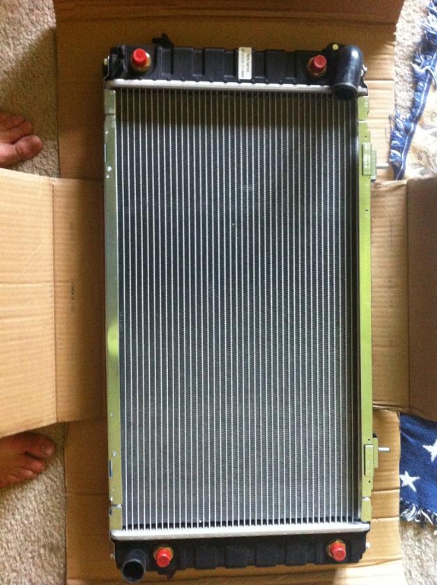

The original radiator is a copper and brass model, with three rows. $800 plus if you can find one. $450 ish to have recored.
An aluminum replacement has popped up on fleaBay, some members have installed it. While it won't last as long as the oem style, it is better than a radiator full of sludge.
Note that radiator has tranny cooler on one side and oil cooler on the other.
