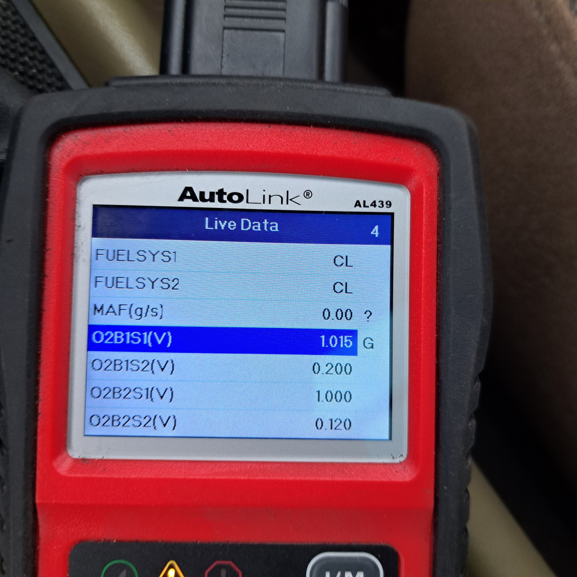

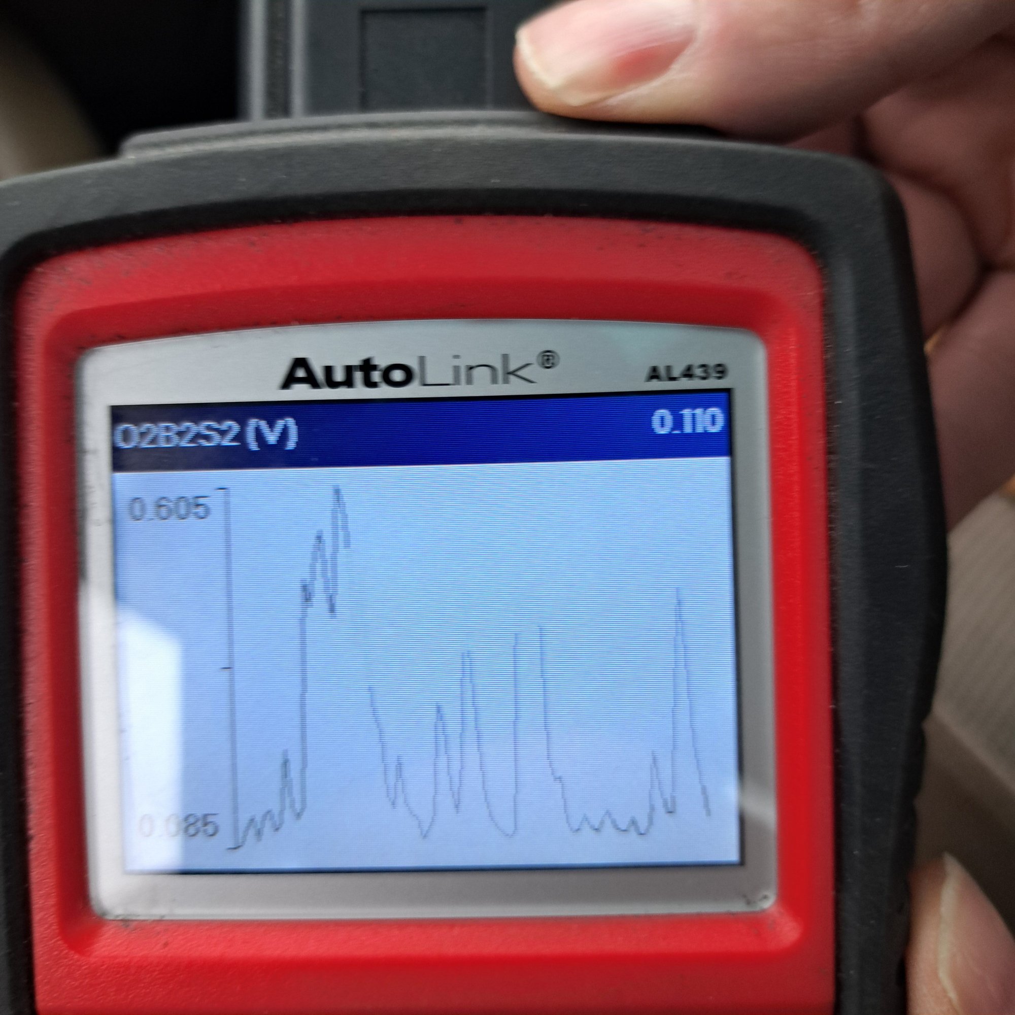

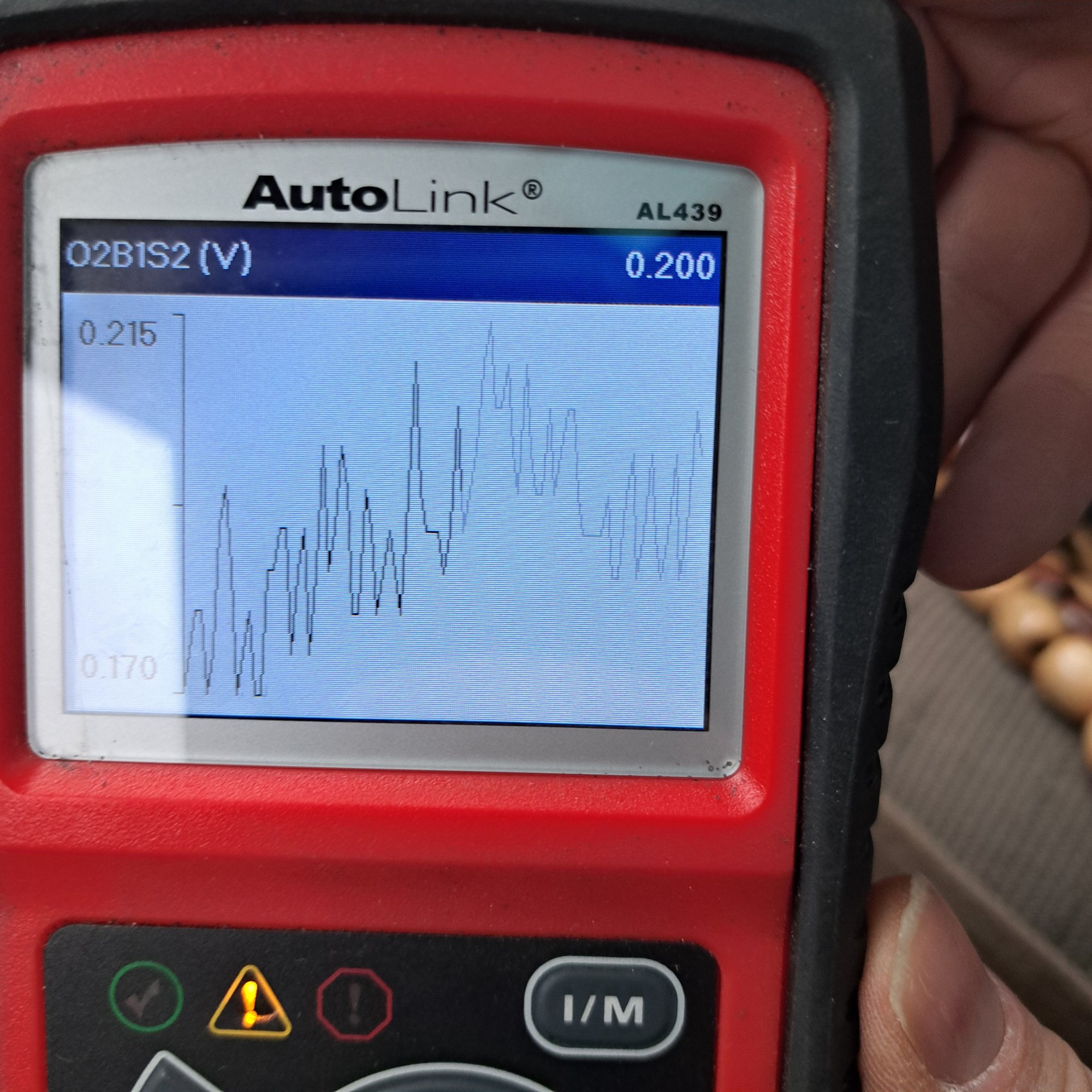

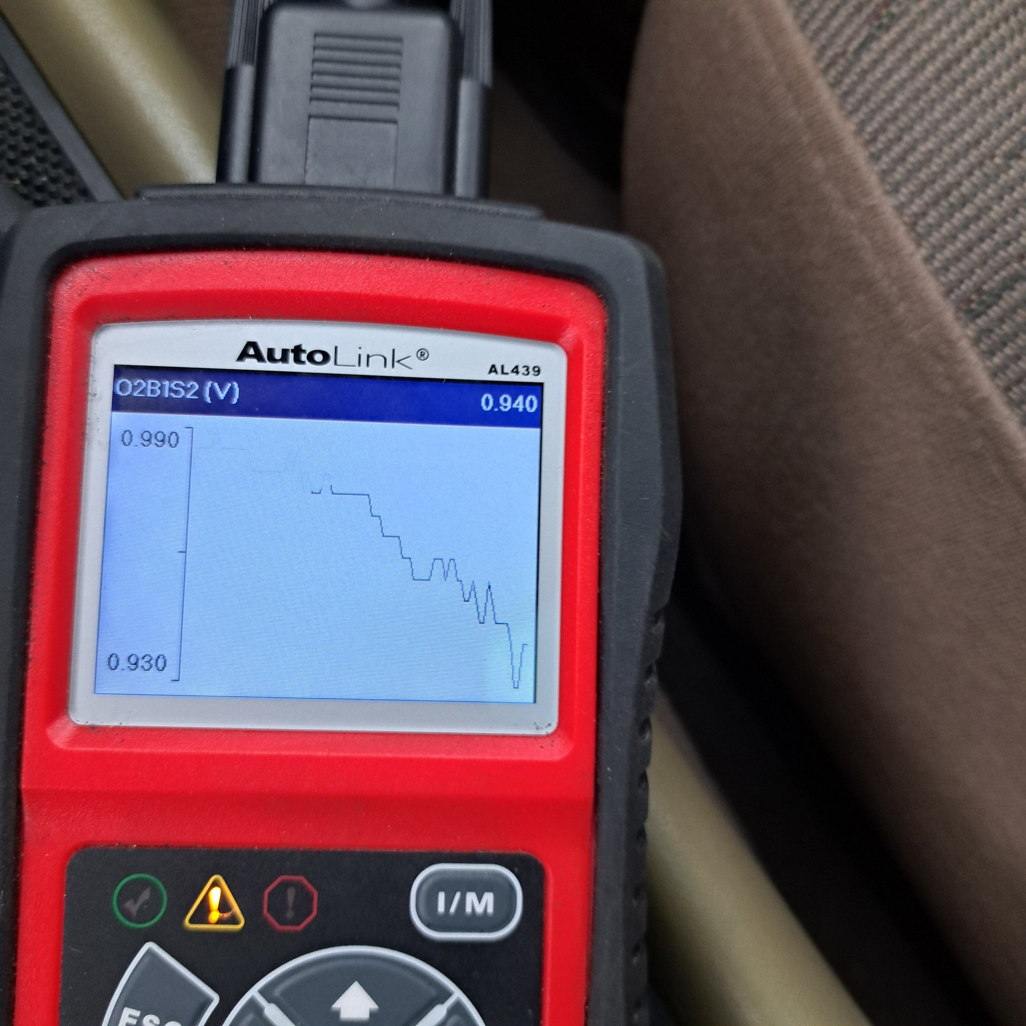

What did change when reader was attached the spluttering got really bad,but when trying to pull away,still idled good. Then driving home (15 minutes) the spluttering got less and cleared and I was able to do highway speed no problem. Total opposite to before when slow was fine and highway bad. I thought maybe the fuel cleaner was helping,so took the disco for a run to the city, drove ok at speed, got.to city and was terrible at low speed and pulling away, driving back was almost 100% the odd minor hesitation. When spluttering at low speed, smells like cat bad, but good at speed. It did throw code 102 twice, which said Mass airflow low voltage, I believe.

No need to monitor the S2 (Sensor 2) O2 sensors, only S1. That is B1S1 (Bank 1 Sensor 1) and B2S1. Those control the fuel adjustments to the injectors, so control how well the engine runs. Bank 1 is the left bank with odd numbered cylinders. Bank 2 is the right bank with even numbered cylinders.

Noticed a ? beside the MAF reading 0.00. Looks like the MAF could be bad. Need to clear up any MAF codes first, before looking elsewhere. Code P0102 also suggests the MAF is bad or very dirty. If you know a friend nearby with a Disco that runs good, maybe try their MAF. Or get one from a wrecked truck. They were usually running when they wrecked. The MAF reading should not be zero when running. Lower numbers at idle, then higher on freeway.

Your sensor readings are odd. I suspect that somehow the downstream and upstream sensors are backward though not sure how that happens.
O2B1S1 - Bank 1 Sensor 1 - generally refers to the Upstream (aka Pre-cat) sensor of bank 1 (left - driver).
O2B1S2 - Bank 1 Sensor 2 - generally refers to the DOWNstream (aka Post-cat) sensor of bank 1.
Downstream (post -cat) sensors generally show readings at/near 1.0. They don't (and shouldn't) bounce around very much at all. If they do bounce too much it suggests your cats are shot.
Upstreams bounce around constantly as the air-fuel mix is adjusted by the Engine Control Unit (ECU).
In your case, it looks as though the 'Sensor 1' sensors are hovering around 1.0 which is absolutely NOT what should be happening.
So either your reader is a little wacky in how it labels things, or the sensors are somehow hooked up incorrectly.
