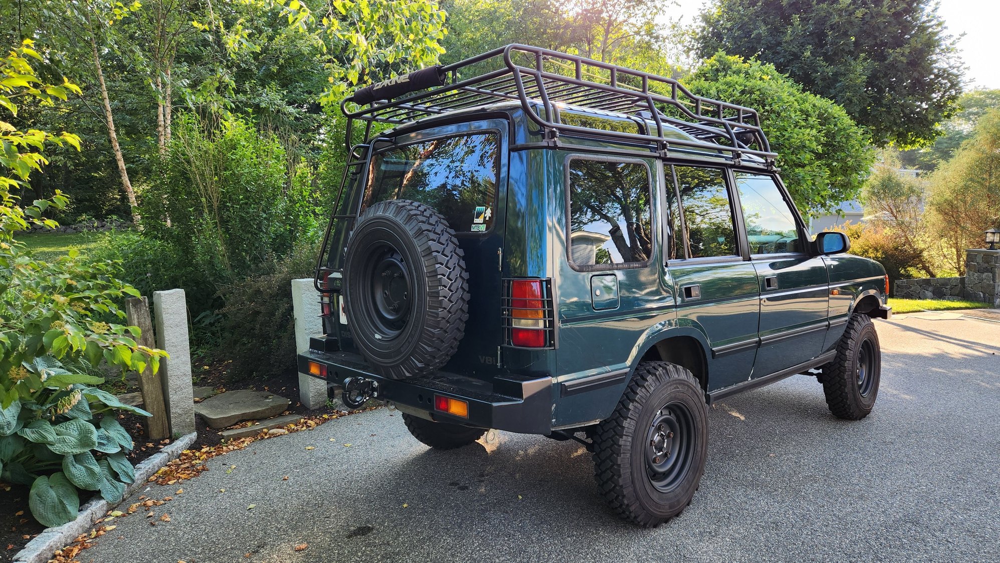

Here's an overview of my journey to my 1997 Disco 1. I've been a Toyota guy since forever, have owned a 100-series Land Cruiser and daily drive a 4Runner but a good friend has a 2004 Disco II and has owned RRCs and a Series truck. Last year I was searching for an 80-Series Land Cruiser as a project truck, but when my friend let me borrow his Disco II for a couple days I was hooked.
At that time, I had been passing by a stock Disco I in the neighborhood for a year, it seemed to be sitting most of the time and not being used often. Covered in leaves and snow, rarely moved. I didn't know the owner so I left a paper note on the windshield and sure enough, he called me. It has been in his extended family since 1997, maintained at various Rover dealerships but severely lacking in TLC. 134K miles. The clearcoat on hood and roof were totally shot, both sunroofs were leaking, carpets full of mold and rusted floorboards. A quick test drive and $3600 cash and the truck was mine!
In the last year I've been daily driving it and making my way through some maintenence and upgrades. Here's what's been done so far:

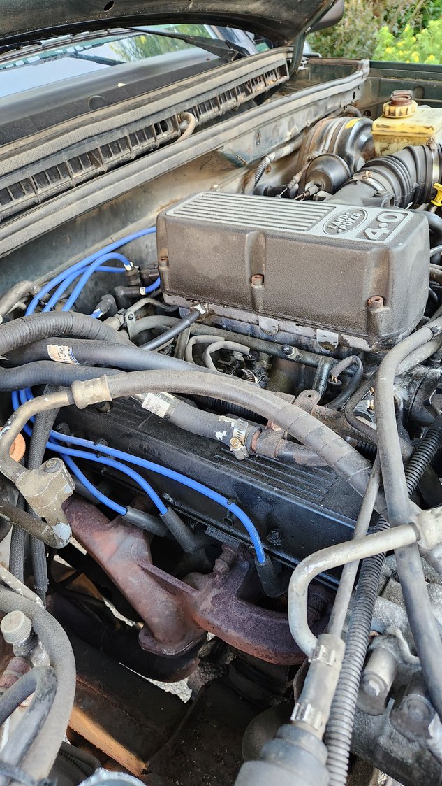

  • New sparkplugs/wires

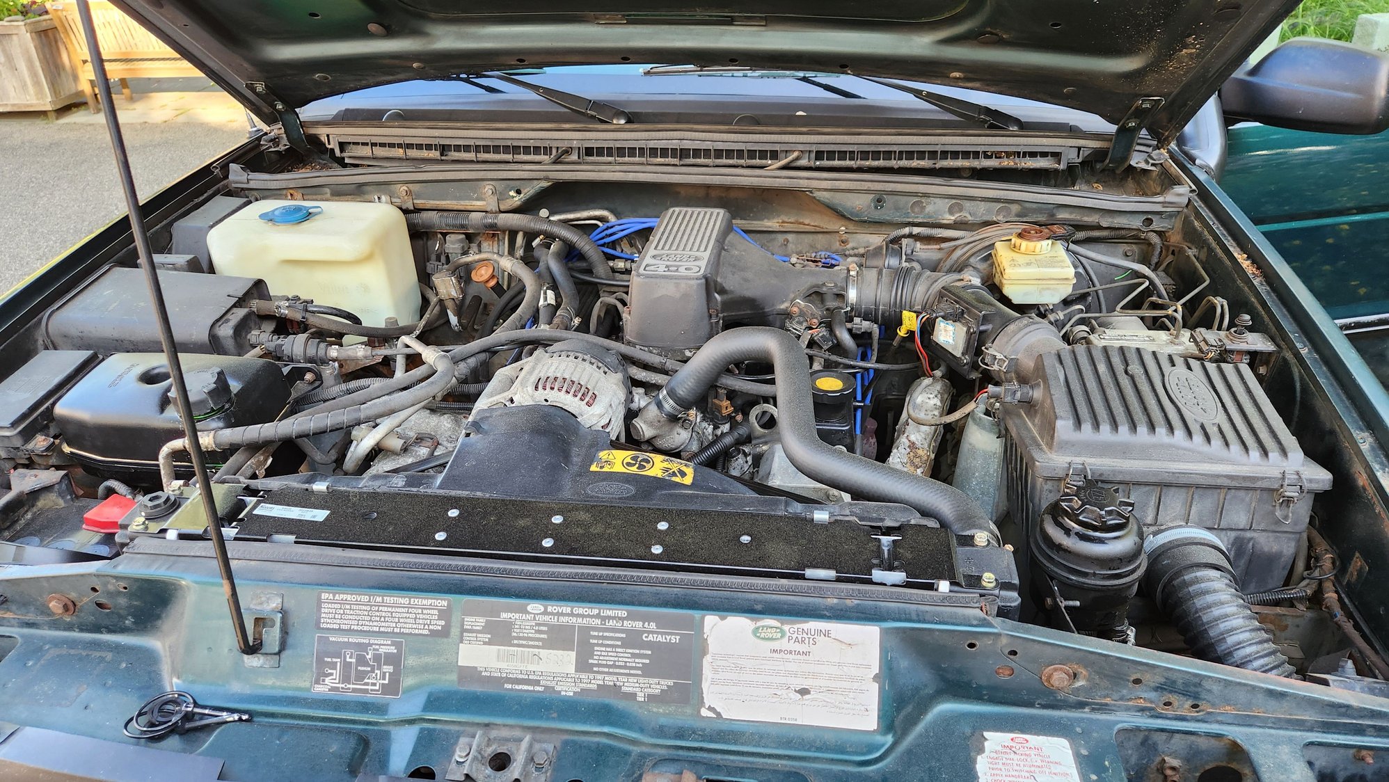

  • Nissen radiator, hoses and water pump and thermostat

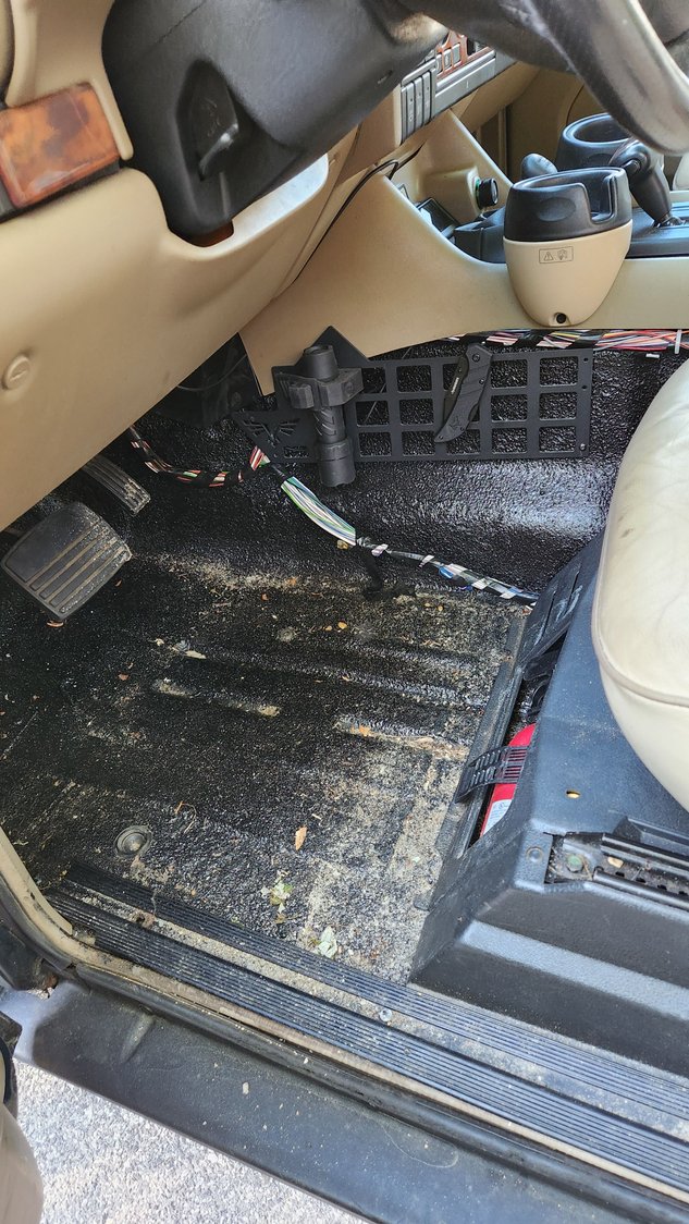

  • Pulled out trunk and front carpets, floorboards were rusted through in several places

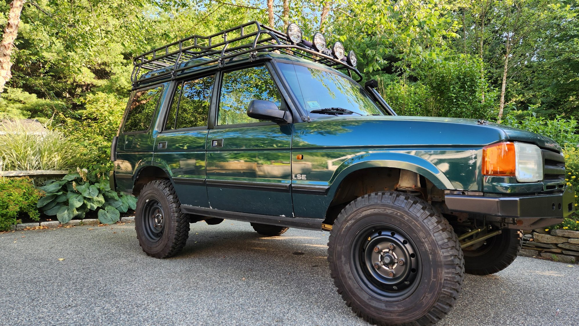

  • Baja roof rack and Hella lights

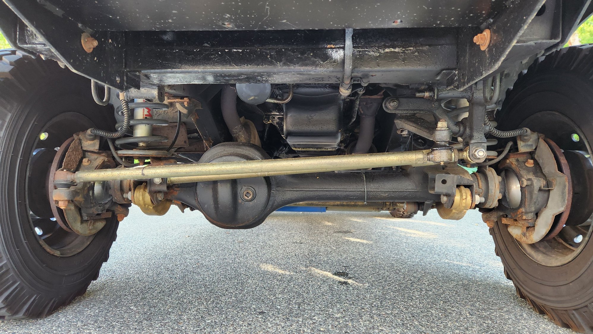

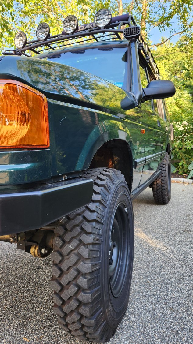

  • Terrafirma 2" lift, caster corrected bars

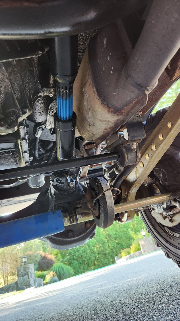

  • Tom Woods front driveshaft
  • Wolf wheels and XZL Tires
  • Alignment

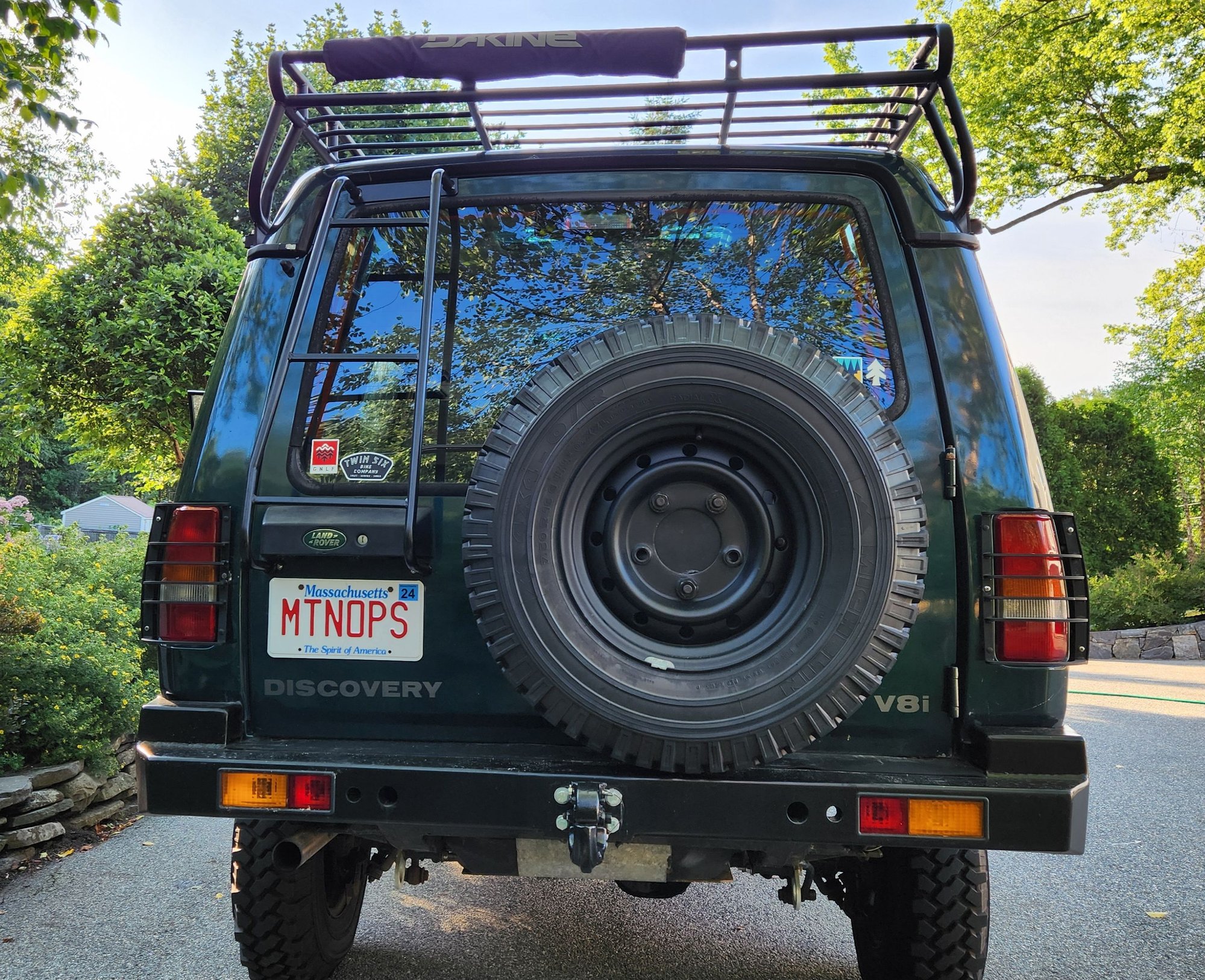

  • Cheap front and rear bumpers (the stock ones were both damaged)
  • Junkyard jump seats
  • Changed all fluids - transfer case and diff fluids definitely for the first time! Unclogged diff breathers
  • Changed brake fluid, new pads
  • New serpentine belt
  • Fuel filter
  • I've been changing the oil every 500 miles or so
  • New MAF sensor

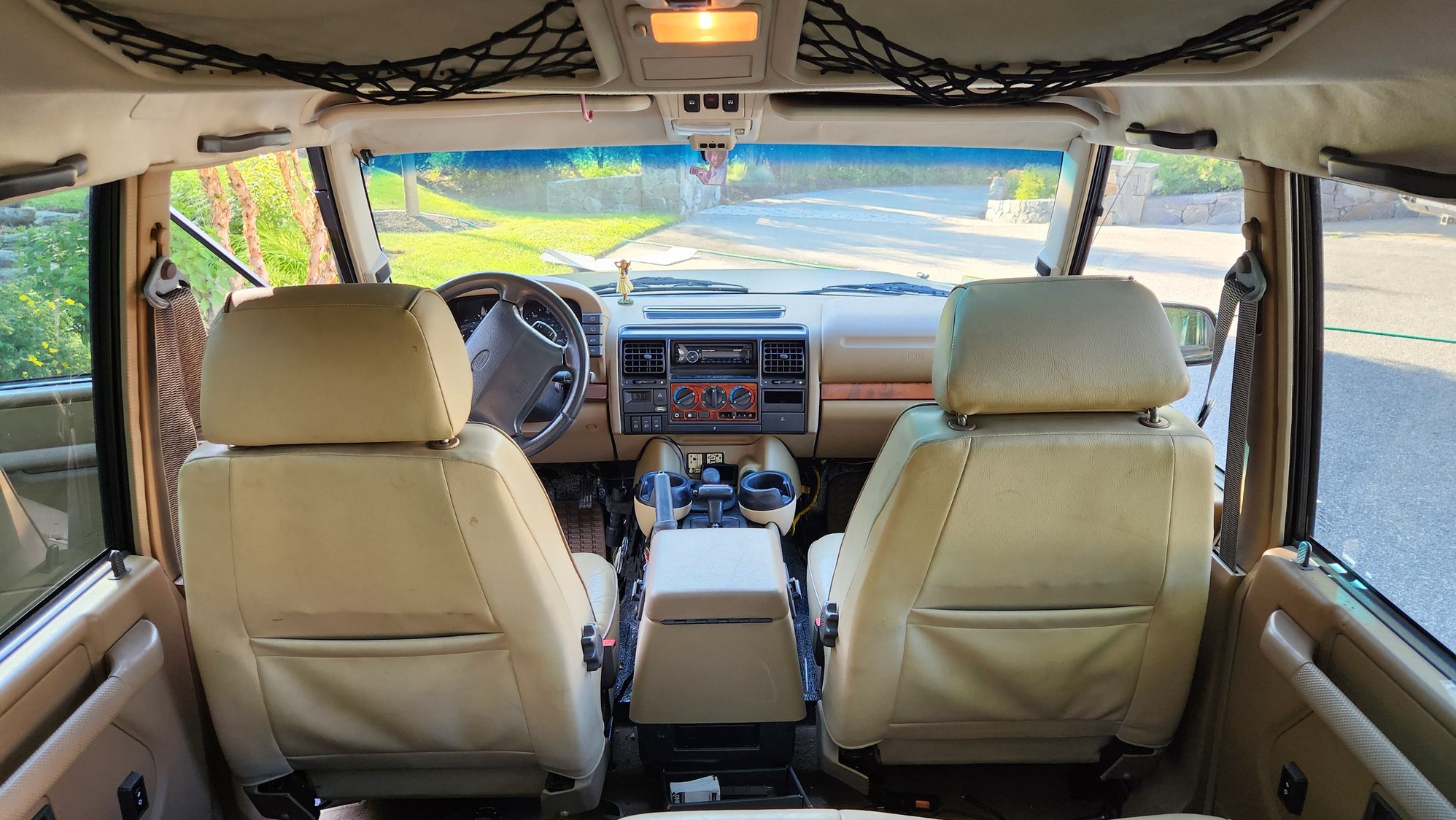

  • Replaced headliner
As you can see there's still a ton of rust to be addressed. Sills are totally rotted, wheels wells are rusted through to the interior in spots, rear body mounts are rusted through (prior owner sprayed in foam around rear bumper/body mount, really increasing the pace of rusting). Rust was so bad in the wheel wells, the ECU just died because of corrosion. Will Tillery helped with a $200 replacement!
I've been working on my vehicles for 20+ years, but have learned so much on this forum. Thanks everyone for the knowledge. And now some pics of the good, the bad, and the ugly!
Michelin XZL Tires

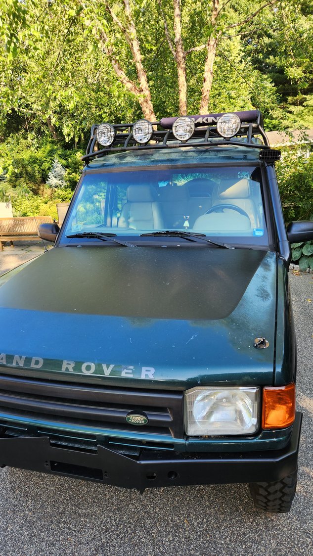

Damaged clear coat/hood decal
Nissen radiator/hoses/water pump

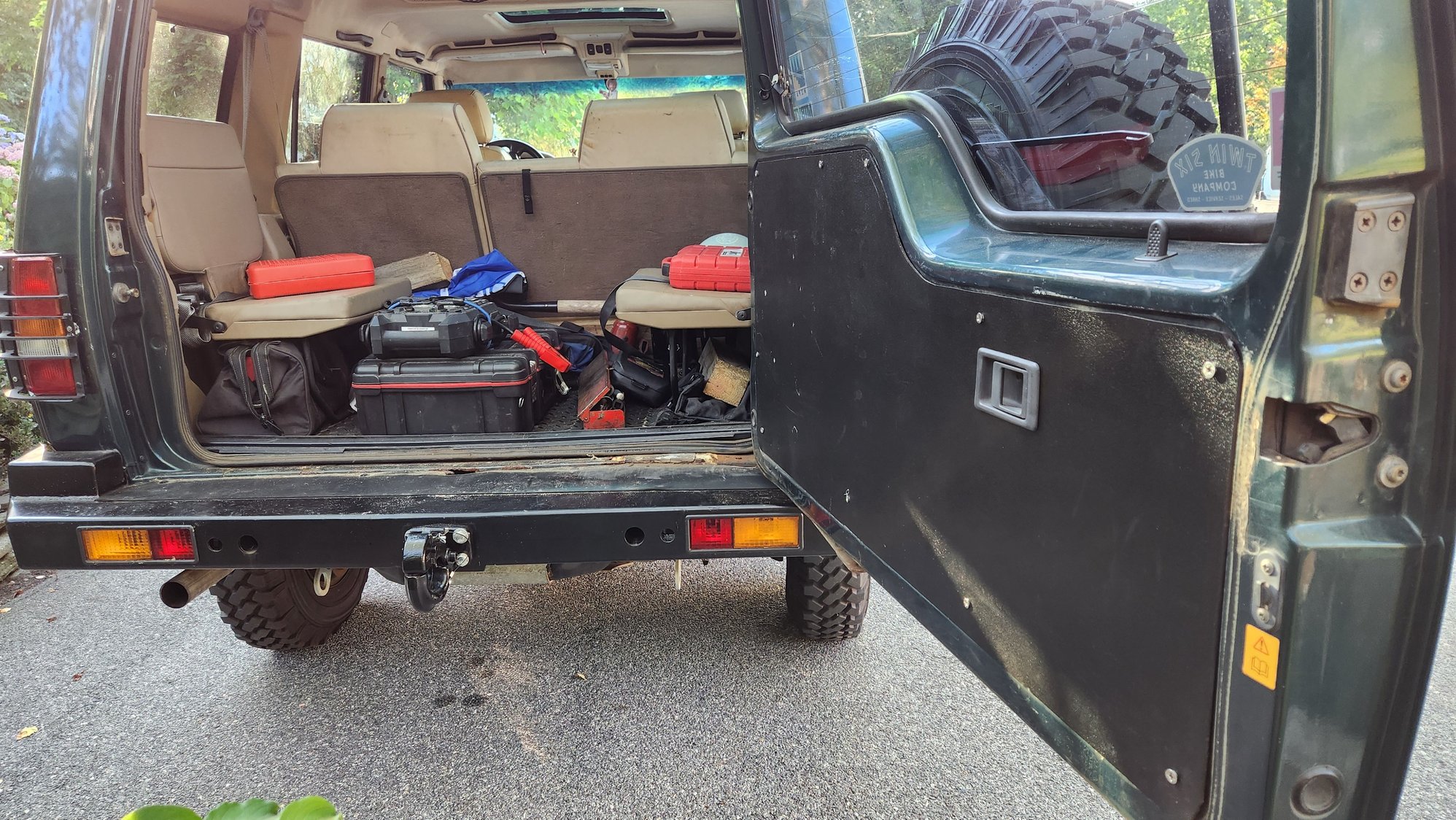

Replaced the rear door panel with a sheet of ABS, the factory panel was wet and drooping beyond repair
Plugs/wires

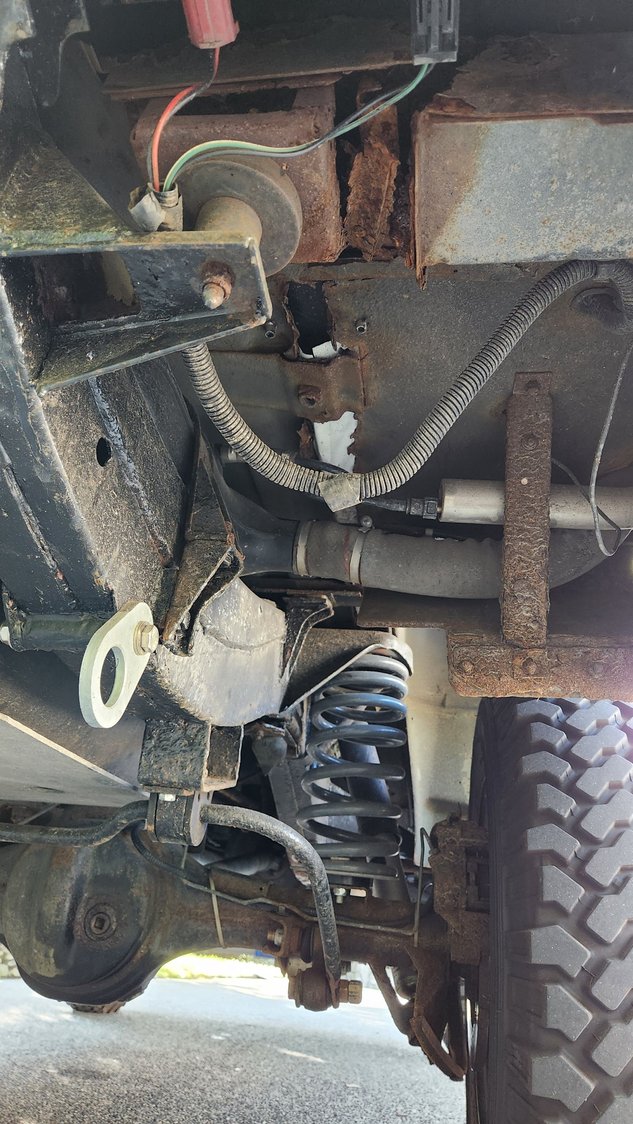

Rotted rear body mount

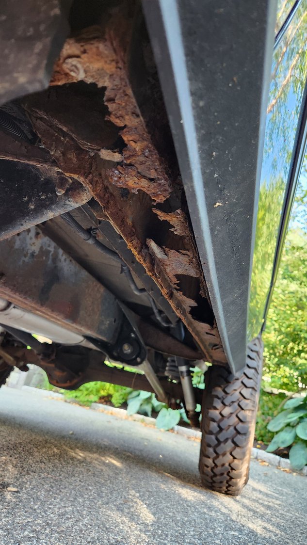

Rotted sill
Repaired/painted floor panels

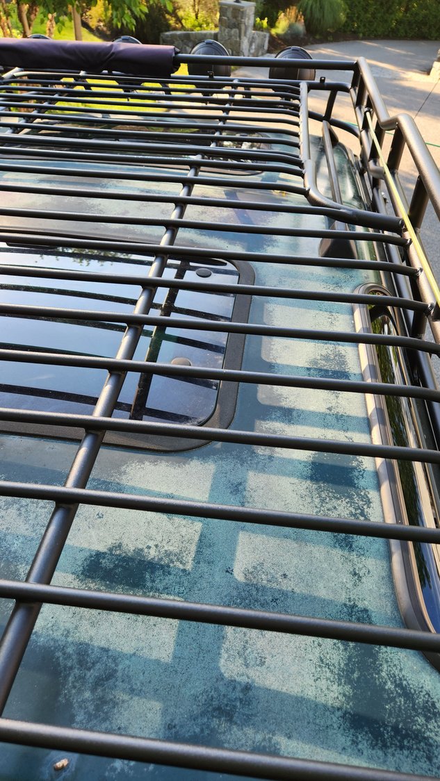

Damaged roof clear coat
New headliner

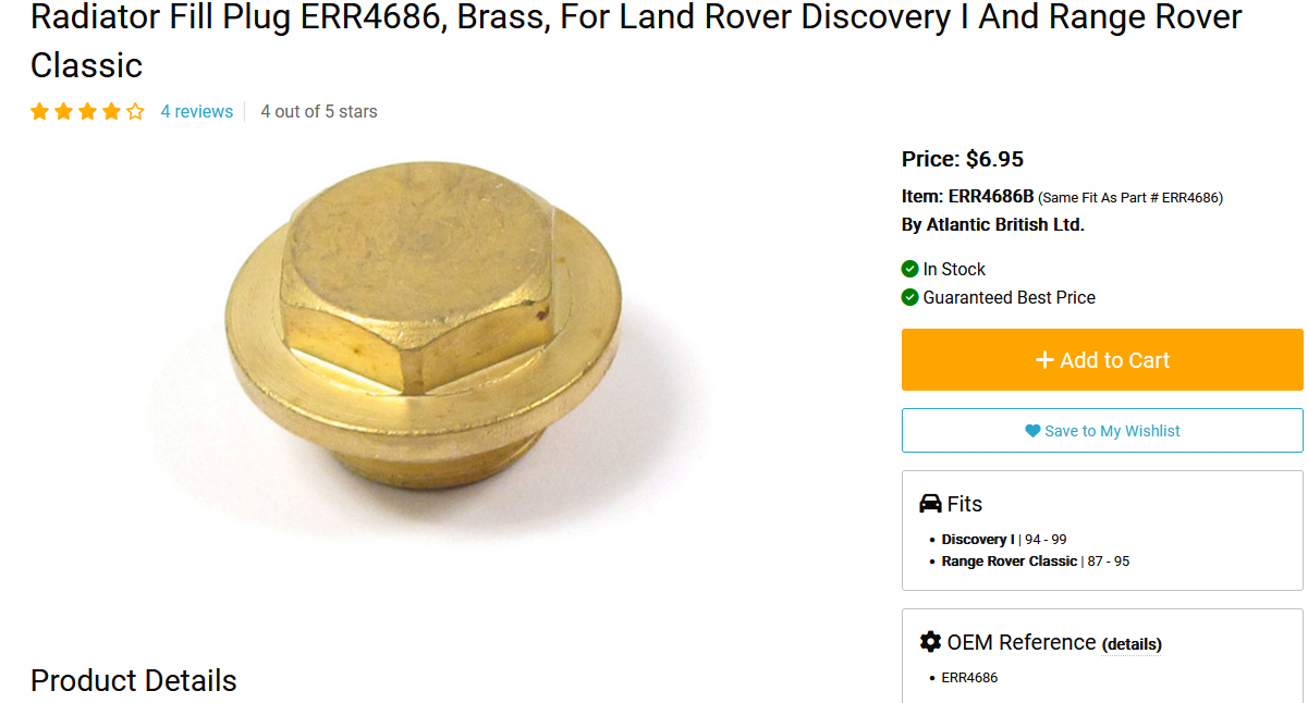

nice Discovery, great work. suggestion, replace the plastic radiator fill plug with this:
https://www.roverparts.com/engine-co...tors/ERR4686B/

I love the rig, but the wheel/tire combo is sexy!!
