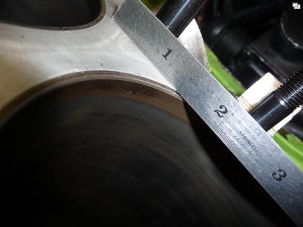

The "tick" that is not there cold, but comes on warmed up, and goes away at faster speeds is usually a cylinder liner that has broken loose due to chronic or intense overheating. It hits the head gasket. As piston speed increases, it can't reverse as fast as the piston, so eventually an rpm is reached where it not longer contacts and ticks, but it is still moving.
One way to fix is pin the liner, search forum for posts about that.
One way is to buy a rebuilt engine block with "top hat" style flanged liners.
Sometimes the tick only happenns at a higher temp. You can remove the thermostat that is there, and install a $10 180F model.
Ticks can also be valve train components, a cracked oil pump, and one guy even found a wrench left inside the engine by a mechanic. You can take a yard stick, hold one side to your ear, and touch various spots on the engine and "hear' what is going on inside, like valve covers, area below water pump, etc.
Some people drive with the tick for a really long time.
Now, if you are having head gasket or cracked block (behind that liner) then usually you will have a sound like water bubbles rushing under the dash. Might be air to be purged from system, might be exhaust gas in coolant, there is a $50 test for that.
You'll want to download the RAVE service manual set.

When I do open this motor up, is there a way to ID the liner that is slipping without taking the heads off too?
Is there a liner number that is most prone to slipping if I wanted to pin just the prone ones?
And also, how would I 'reset' a slipped liner up against the head gasket before I pin it? I wouldn't want to heat it and bang it upwards from under the car....I think. Unless of course there's a known trick out there for this.
Thank you Savanna Buzz!
Old May 14, 2013 | 04:29 PM
Posts: 16,322
From: Savannah Georgia
May not be the liner, could be PS pump, oil pump (cracks), valve train, etc. There have been posts this week about pinning liners.
