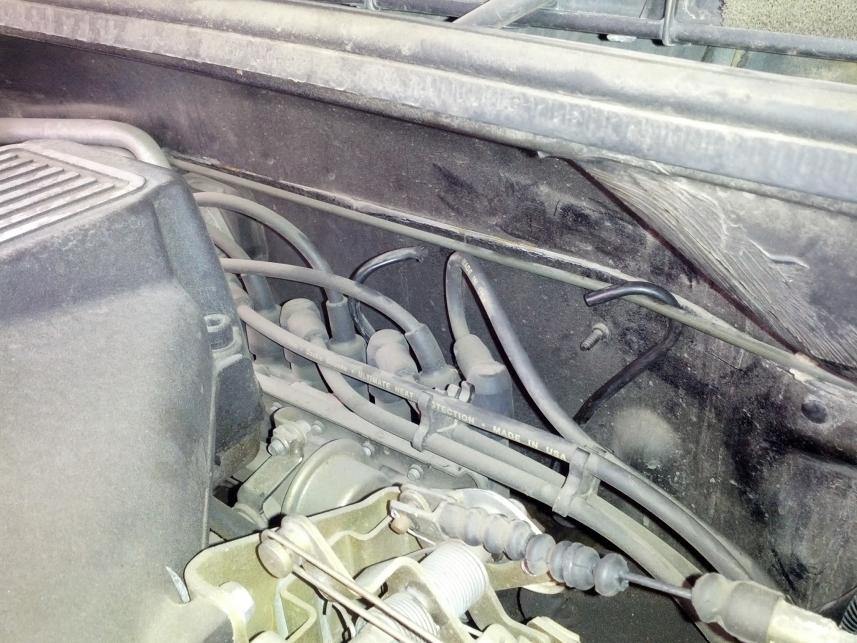

Lastly, have a look at the picture that I have attached. Do you see those two open lines? I tried to trace them back and they go toward the back of the vehicle over the transmission. They are a hardened plastic. I have no idea what they do, but I am nervous as to why they have been severed. Any thoughts?

They're not severed, they are vents for the transmission and transfer case, they have the "shepherd hook" at the top to prevent water from entering when you cross rivers.

Oh! Awesome. That's a load off. Thanks!
