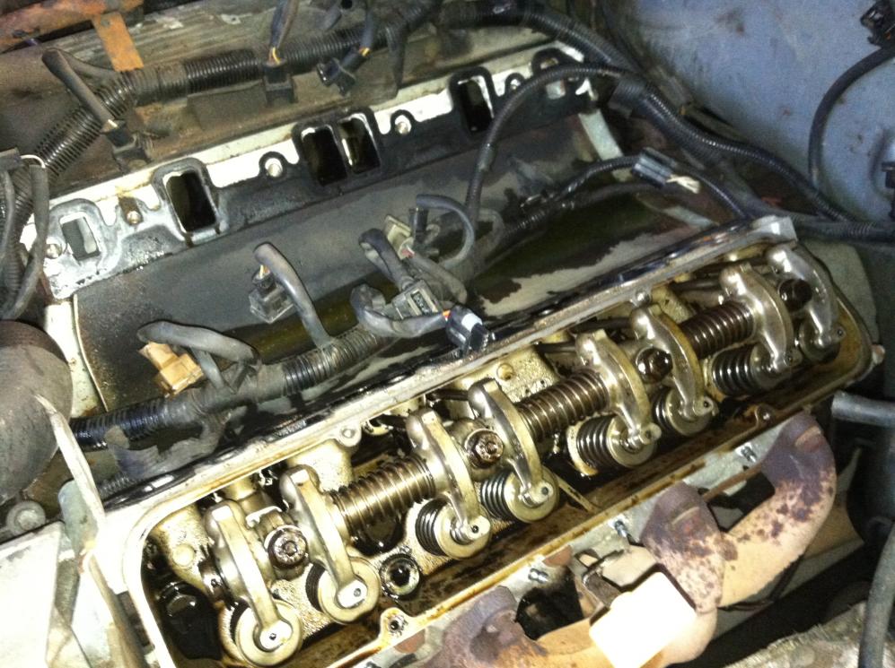

I removed my left side valve cover today. I had definitely heard something rattling around in there when put my ear to a large screwdriver.
besides being dirty I noticed that two of the pushrods are not able to rotate within their ball joint on their respective rockers. Is this normal? One rod from the front most cylinder will not move and one rode from the 2 cyclinder will not move like the others.
The rear most rocker (closest to the firewall) seems to have a lot of slop in it as it can slide about the rocker shaft a bit. Is this normal?

So I just removed the shaft and rockers. I noticed that the two rods I was talking about are much higher seated than all of the others... Like the lifters will not sit flush - will not close?
I'm not sure what to do now. My rods looks straight. The rods that wouldn't "rotate" look like all the others.... Caked to hear with burnt oil...

The pushrods you cannot move are being compressed by the cam. They are pushing valves open. They're fine. The loose ones are at rest, not opening valves.......
As long as you have a torque wrench to reinstall the rocker shaft my next suggestion is to remove the shaft, keep the pushrods right where their bores are and do not drop them into the valley or you'll be removing the entire top end if you don't have a strong small magnet to fetch them back up.
What you'll be looking for is under each rocker there is a socket with a hole in the middle to lube the pushrods. Make sure you see a socket button in each lifter. Once you've checked each rocker then remove one at a time a pushrod. Check it's ball for roundness and then roll it on a flat surface to check for warp. I'm sure you'll find a few that look like mushrooms or at least starting to. Don't worry, just put them back in the same order you remove them.
Let's go back to the rockers. Check the sockets for oil occlusion at the oil ports. An overheat will thicken oil to the point where it clogs oil ports like now. Use a paperclip or thin wire to push into the port.
