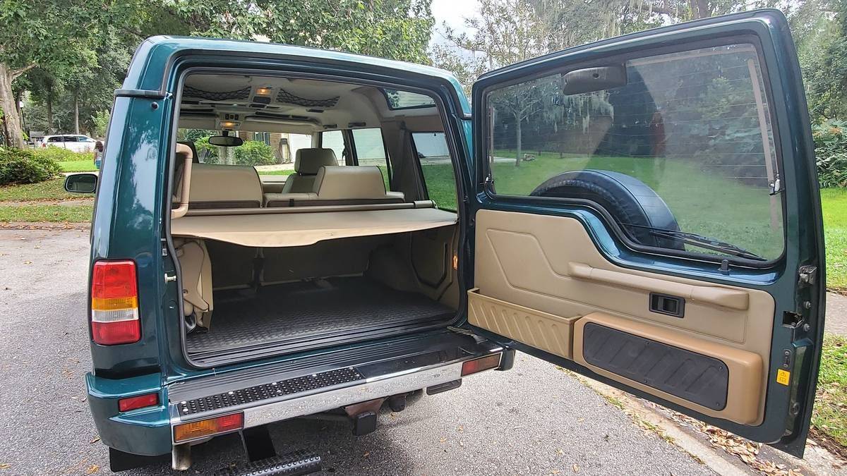

I have also included pictures with this post. Thanks in advance for your help in answering these questions.

Very well cared for & great looking 98 LSE D1 there!

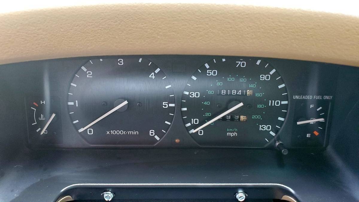

If it runs and drives reasonably well, buy it. The only thing that puts me off a little bit is the evidence of tampering with the dash binnacle. Perhaps that was just a light bulb but many owners pull the ABS light and deactivate the system because they don't want to fix it properly (which is actually fairly easy).
Separately, bring a code reader to make sure that light has not also been pulled.

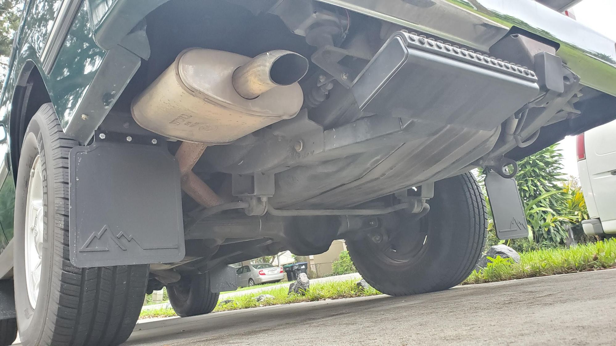

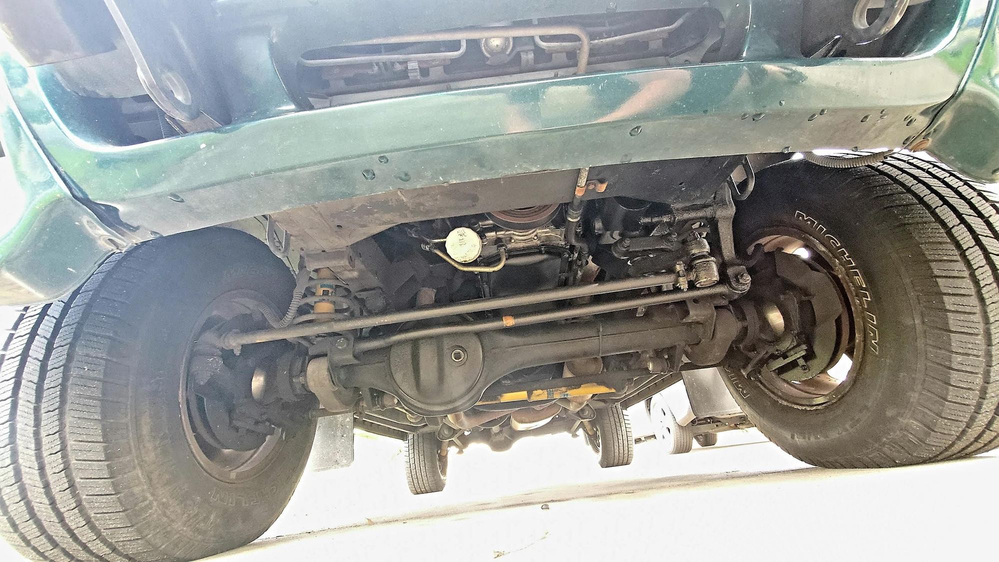

In the photo of the front undercarriage, I see what looks like a leak\seepage, are these expected, should they be of concern?

Just my 2 cents - if I was approaching the vehicle and I saw the owner had spent some nice coin on those michelin tires I would say maybe they kept it up

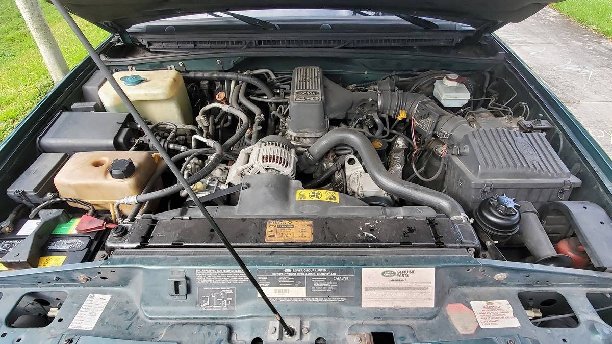

It may need head gaskets, it may not. Using a test kit for exhaust gasses in the coolant MAY help rule it out...but they are notoriously not reliable. I would probably plan to replace the head gaskets in all cases unless it had been done recently. A re-core of the radiator, fan clutch, and thermostat and thorough flush of the cooling system would also be on the list.
Any number of things can go wrong in a 22 yr old vehicle. With regard to Land Rovers.... if it doesn't leak/seep at least a little, it is probably empty!

Holy smokes, that’s a real nice color.
