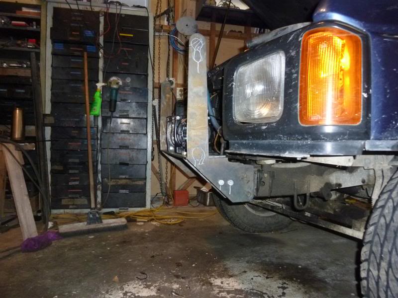

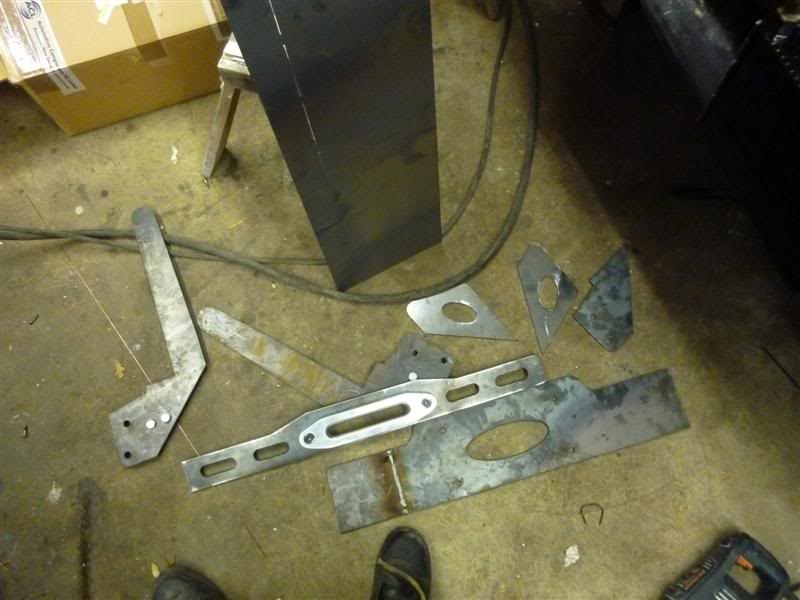

Well i ripped into the new bullbar /winch mount,
so built a bit of kitset for bull bars, winch mounts to 6mm plate on the flat, all plates are 6mm to the chassis directly off the 6mm winch mount, the angle below the winch is 3mm corten steel with 3mm gussets between the 6mm and 3mm, should be strong as hell but relativly light
have managed to keep the winch well back, in fact half of it is in the grill

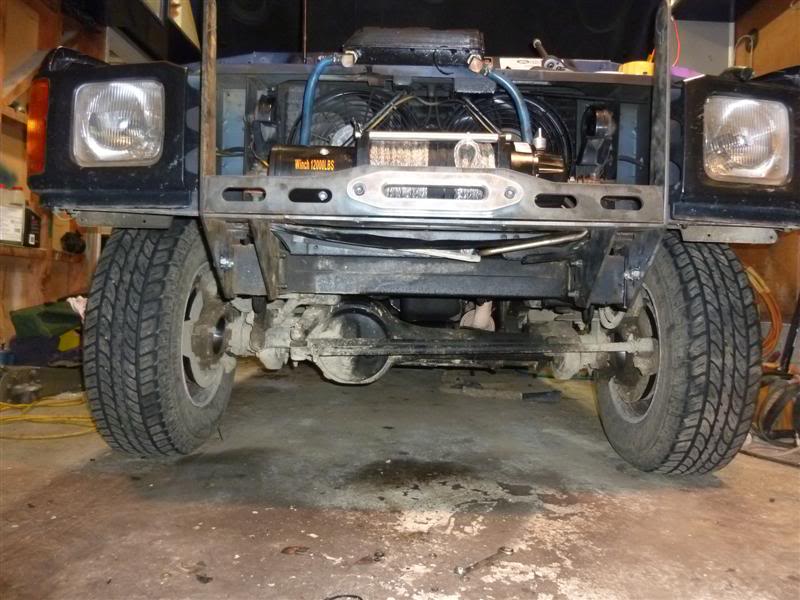

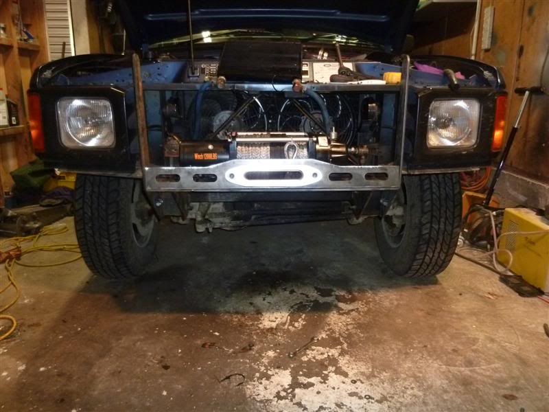

so from the front give good front clearance and approach angle, does not cut into the approach to badly
the uprights are going to get 30 x 3 flat bar wrapped over the towers, a horizontal bar between them, and the the outer section of the bar will be 40mm nb black pipe, with welded elbows for the tight corners, will be a pipe just below the headlight and a second coming from the bottom of the mount plate, and possibly a third small pipe to triangulate the corner, hopefully get it finished this weekend and start on the side bars
