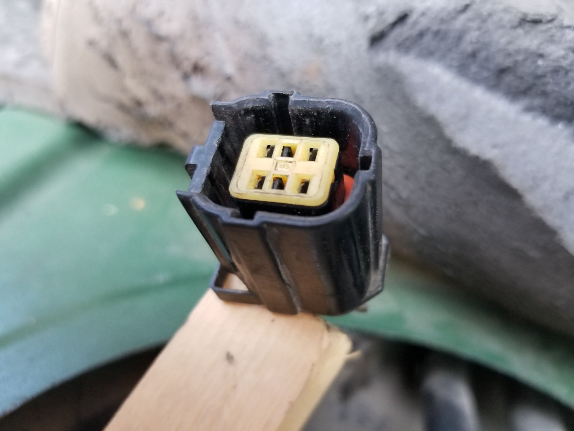

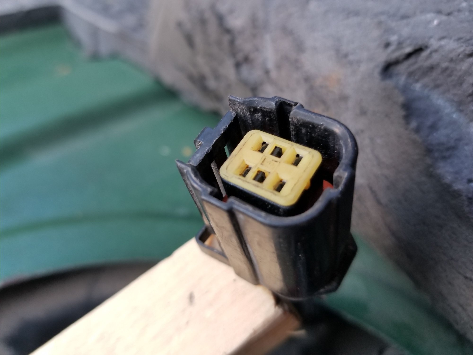

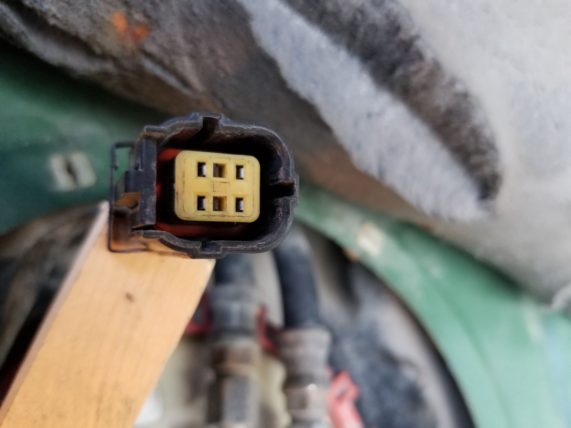

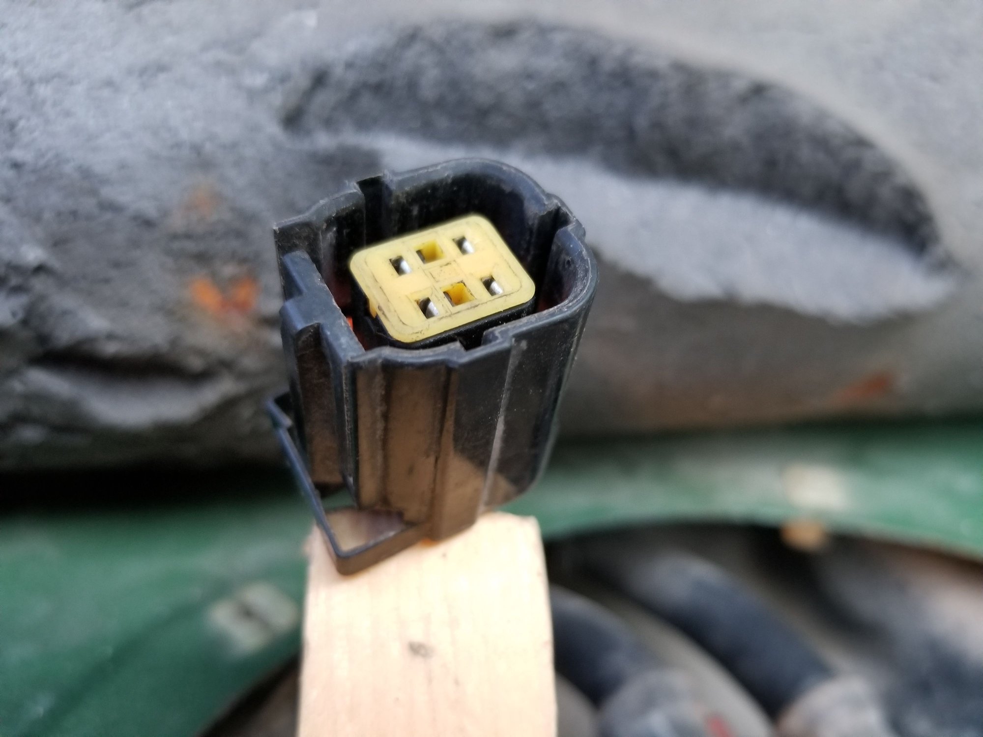

Hold on, you had a 15A fuse that was blown, lets figure out why that happened first. Check your connector at the fuel pump, look for overheated/discolored pins and sockets. I know for a fact that a pump will run for a while with this type of connection until the pins/sockets heat deform and loose contact. I just went through this with a brand new aftermarket fuel pump without a waterproof connector.

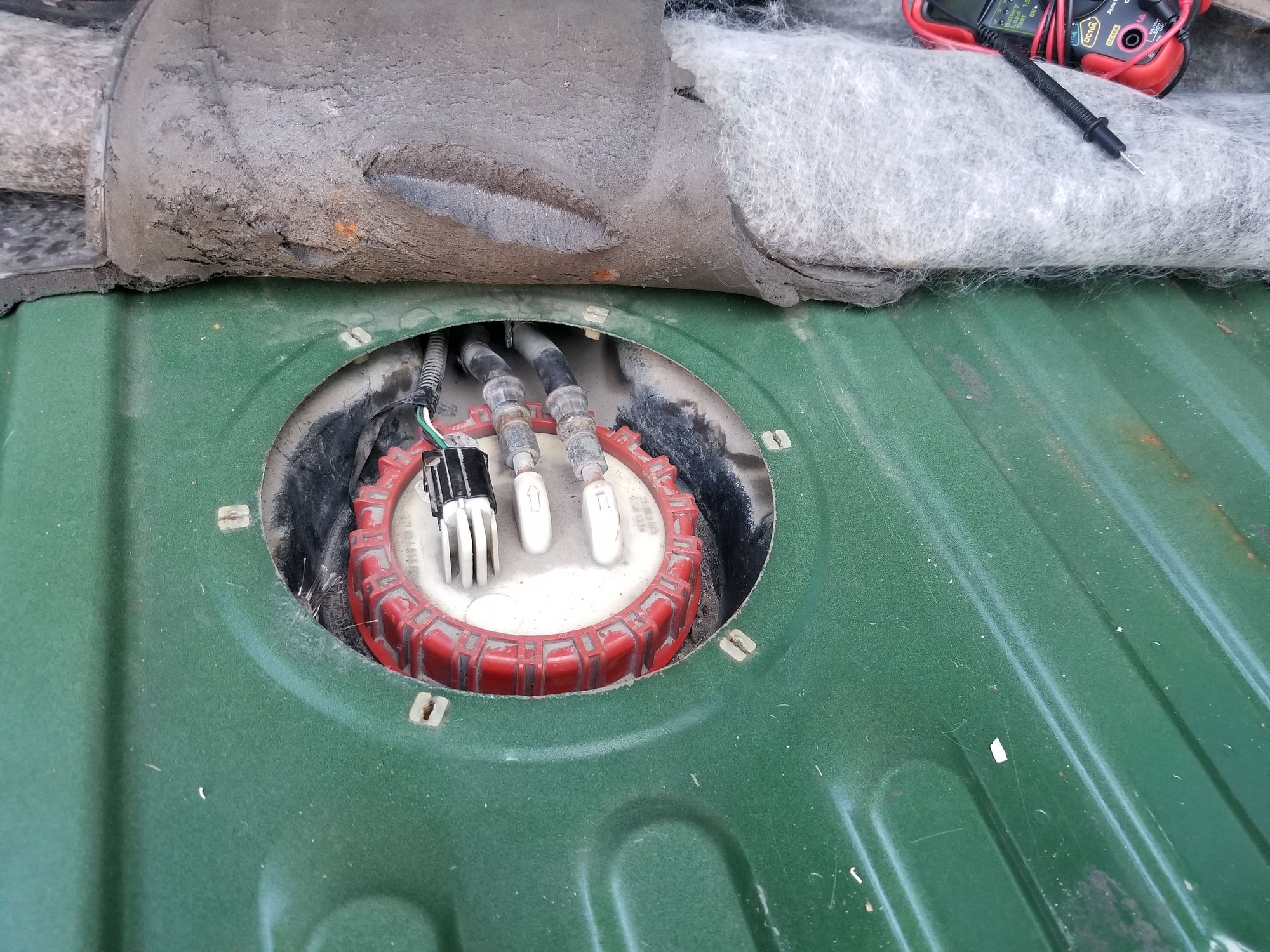

The blown fuse is confusing me. It happened but everything looks to be in electrical order. The pump turns on, the relay comes on and off. I will purchase a fuel pressure gauge today and test the viability of the pump. It may be spinning but not pumping enough, Or, there may e a fuel line blockage? i pulled the pump, it looked good. all the wiring inside the pump housing looks good. replaced the filter. Im wondering if the fuel pump relay is the culprit? Or, the fuel injector relay? i cant tell if it comes back on when the key is turned to start, but i know it's on in pos. 2 and times out after 2-3 seconds. will also get a can of starter fluid and see if i can get it to spin with fuel to burn.
I think you're talking about the external connector? kind of hard to tell from the photos, but there is still shiny metal on all the connectors. Def no signs of overheating to a 15A level.

Yep, looks like new. I'd give each of the sockets a dab of dielectric grease as good measure. I'd suspect the fuel pump relay or its socket next, RH footwell. The 15A fuse does send pump voltage through it.

After renting a fuel pressure gauge, testing every relay under the passenger kick panel and pulling the fuel pump again, and testing it on water in a jar with the pressure gauge, I had a revelation. The pump is good, the electrics are good, but no pressure at the fuel pump.
Turns out the PO replaced the fuel pump with an AC delco 381. He did not clamp the original hose down to the pump spout- I put a hose clamp on and, vrooom, vroom, vroom, we are running g again.
