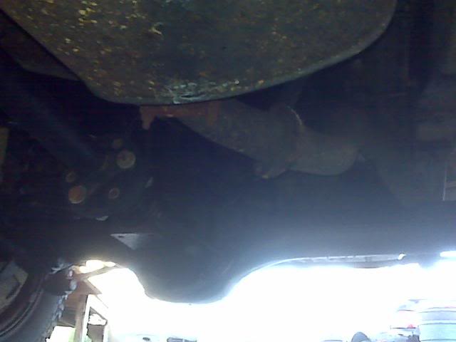

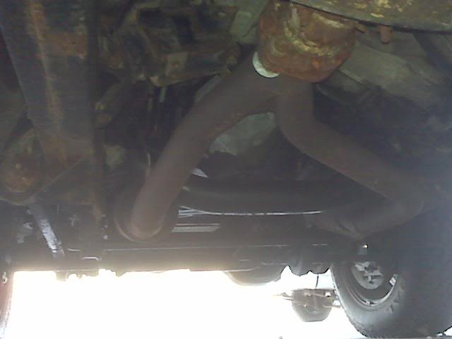

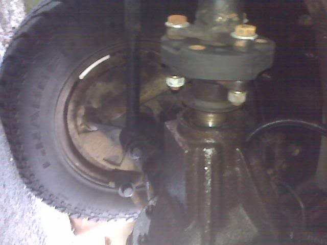

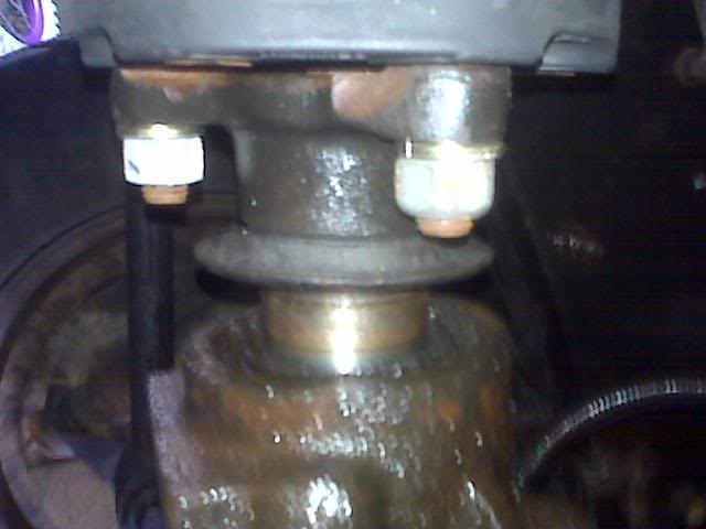

As mentioned in my other posts, Im getting a 96 Disco in a few weeks. Has around 180K+ Exterior body appears to be in overall good condition with a few nicks here and there and a few needed replacements and one small rust hole on the panel that holds the bumper on. Nothing I cannot handle. As for the mechanical, the Disco is currently not safe for operation as the engine has a leak (seller has not yet specified) and most of all the rear axle needs servicing. From what I gather the rear bearing is broken and needs to be replaced (Ill likely replace both just to be on the safe side) but in the pictures shown, I'm not exactly sure
A.) what I'm looking at in regards to damage (axle work is beyond my expertise)
b.) what the overal condition is of the entire rear axle.
c.) should I save up the $$$ and buy a replacement rear axle (new or used?)
d.) aside from the bearings, what other parts I should invest in to make the axle stable as the Queen intended.
Take a look at the pics and let me know what you think.

Wow that pinion bearing is trashed. You might be able to find a complete 3rd member (diff) for cheap. The DI and DII both take the same unit if that helps you out. Its a fairly easy unit to replace as a whole, remove axles, remove driveshaft, remove 3rd member, assemble in oposite order. If you have never messed with setting up a differential its best to take it to a driveline shop, but the way that pinion sticks out I'll bet the gears are trashed along with the bearings. The last used 3rd members I remember seeing for sale where around $150-200 plus shipping if that gives you an idea on price and Youre looking at a 3-4 hour job unless you run into broken/stuck bolts.
You mite also be lucky and the pinion nut came loose, but if it was driven very long like that im sure theres internall wear in it.
I would also replace the Rotoflex since youll have the driveshaft out to repair the diff, and I would also service the wheel bearings and seals since the axles will be out also.

Yeah, a used diff is the way to go.
Drain the diff.
Remove the propshaft.
Remove the input flange if you need to. 3-Bolt Flange Removal
Remove diff securing nuts
Remove the drive member bolts and slide the axles out about 6", and pull the diff out. You don't even need to jack it up.
However, it would probably be wise to also replace the hub bearings at the same time.

That truck looks to be in bad condition, I would suggest you follow my sticky at the top of the D1 section and do it all before going and playing.
As for the bearings, plan on replacing both the front and rear wheel bearings/seal and whatever else you find wrong, also service the swivels in the front, might want to consider using a heavier gear oil like the 75W/140 to help slow down your warn gears.

SWEET JESUS!!! Everyone look more closely at that ROTOflex!
That is the absolute worst way anyone could have installed it. ONLY 3 bolts ... flange to flange with roto in the middle acting as a spacer and not a coupling. Driving it like that is a sure invitation for failure.
I suggest having this rig carefully inspected by a specialty land rover mechanic... that may only be the tip of the iceberg. Any time I see repairs like that it tells me everything i need to know about the person who worked on it and it makes me look hard for other "repairs".
