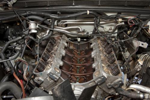

That crazy setup was about the only way I could figure to get it out without removing the exhaust and trans oil cooler lines. The others were pretty bad too. Even with the engine dropped lower on its mounts there's barely any room to get tools in there.
Oh yeah not stopping there at all. Lots of things I want to do while the engine is away.

Been preparing it to be moved by hand tomorrow to the machine shop. Removed starter, engine mounts, drive plate, ring gear, timing chain, and camshaft. I don't think it'll be too heavy at all now.
I tried removing the hub aligner but those Allen bolts are ridiculous. I thought the head bolts were bad, but even my 200 ft-lb impact wrench couldn't remove them.

Probably partly because I was tired and not looking forward to making a big mess of fluids again. Also it looked like it'd be "somewhat" easier, but maybe not enough to justify removing yet more stuff. Maybe I should have, maybe I yet will
Hub aligner is in the RAVE under something like "Drive Plate/Ring Gear Assembly Removal". Can't remember if it's in workshop or overhaul. Basically it sits on the end of the crankshaft where the drive plate is centered and connected to it. They must have loctited it.
Ohwell, it's out of my hands now. A buddy and I carried it out to the pickup and took it to the machine shop. It was pretty heavy even with nearly everything removed.

Now that the engine is away I've turned my attention to other areas. I spent all evening scraping crud from the engine bay. I literally filled a bucket with it. Then I'm going over it with degreaser and cloth. Now where there was a thick layer of gunk there's nice shiny paint. I'll take pics at some point.

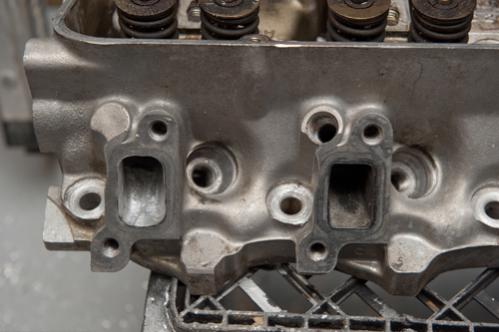

I started a thread like this on a different Landy forum. I have pulled the heads on my 4.6L to replace the head gaskets and while I was waiting for the UPS to deliver, I ported and polished the intake, heads, and exhaust manifolds. When put back together with a fresh tune up, this truck runs like a champ!
Eric: when I saw this I thought of you. Port and polish while it is apart? It is from a thread on mods.
