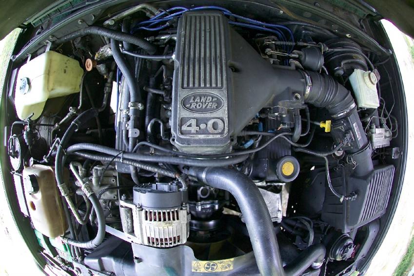

All of the above - but throw a pressure gauge (tire gauge will work) on the fuel test valve on right side fuel rail. At ignition position 2 the pump should run for a couple of seconds, 32-34 PSI. If ya got fuel then check for spark. Test port is left of -Rover in pix, and inertia crash switch is just right of the washer fluid jug on the fire wall.
