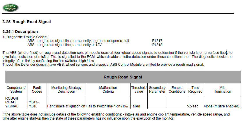

I am working with a Grandson on a 1996 Discovery with both an ABS light and a CEL P1317 code. Both have been on since purchase a few months ago but it is now time to get the annual inspection which it is not going to pass. The P1317 clears but comes back after a drive. Checked resistance of the wheel sensors and they are just over 1k ohm.
We have read forum posts extensively and have explored the RAVE and electrical manuals. Other than seating the sensors, checking the sensor resistance and verifying that wiring harness is connected there doesn’t seem to be much in the way of repair suggestions associated with the OBII code. I must comment that both the RAVE and electrical manuals leave a lot to be desired compared to the Ford and Jaguar manuals that I have.
Right rear sensor got seated a little better this morning and the P1317 was reset and the CEL has been off for two 10 mile trips but it appears on the reader that it is ‘pending’ in the ECM. ABS is still on and has never gone off.
Here comes the questions:
Does anyone know the drive cycle criteria for that code?
Forum posts indicate both that the blink codes for the 1995 model year can and cannot be forced in the ’96 OBDII equipped cars. Which is correct? The blink codes appear to tell you more information than just the P1317.

Is the ABS light on because of the P1317 or for some other unknown reason? Lots of discussion on pulling fuses to extinguish the ABS light. I would prefer to fix what is broke rather than just turning out the light. What list of things cause the ABS light to stay on?
Any other suggestions on these issues.

From the GEMS OBD manual it looks like a 'lack of handshake'. I'd say the ECU is not seeing the ABS control modulator.
What did the blink code indicate?
