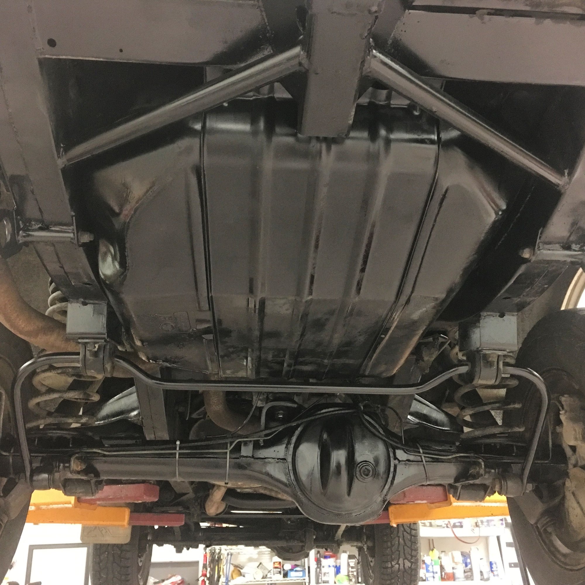

Too funny! I just got back from Bozeman, MT after rescuing this '97 SD r380 from an uncertain future. Like yours, the underside is completely clean. I also have some no-op stuff to address after I dig into some fairly obnoxious oil leaks. I also had a fairly white knuckle trip home., 700 miles back to Seattle.
I run shell rotella 15w40 diesel oil in mine. (Also 200k miles) I'm on day 4 of degreasing the engine. Every day it's getting a little cleaner on mine, the pcv valve was clogged, literally every seal on the engine was puking oil. I may pull the engine to reseal it if replacing the pcv valve doesn't massively reduce the leaking.
