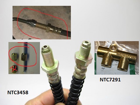

Any pictures of that junction? The rear hard line going to the soft line? Maybe something was repaired along the life of this thing and I'm missing a piece?

Just the rear, I verified the engine side are bubble, and am replacing from the ABS mod back. I just can't figure out how every picture of the replacement rubber hose I see is male bubble on the frame side... I HAVE to be missing something.

"I just can't figure out how every picture of the replacement rubber hose I see is male bubble on the frame side" That part of the hose is correct. The only thing you are missing is a HARD LINE with a Double Inverted Flare and a M10x1.0 FEMALE Tube Nut.
Like this> NUT BRAKE PIPE FEMALE 10mm, RND954, FM10 - Rovers North - Classic Land Rover Parts
YES. That is it, thank you. I was searching every rover site and auto parts site and couldn't find any pictures like that. The rear hose is correct too. I'll have to give them a call Monday morning. my hard line from AB is with the correct fitting but bubble flare, theyll also be getting a call.

thanks for the extra pics dude.. it helps to know i'm not crazy like AB made me out to be.
just got off the phone with roversnorth, i have two genuine LR rear brake hoses and a junction set to ship monday. the guy on the phone went back to the warehouse and verified the ends on the hose for me and they are correct. he said he used to stock the proline/allmakes rear hoses but no longer does... and he thinks the reason they no longer do is probably bc of the issue i told him i was having. i'm gonna "rent" a brake line flaring tool from the parts store, cut and re-flare my hard line, and return the AB hoses.
