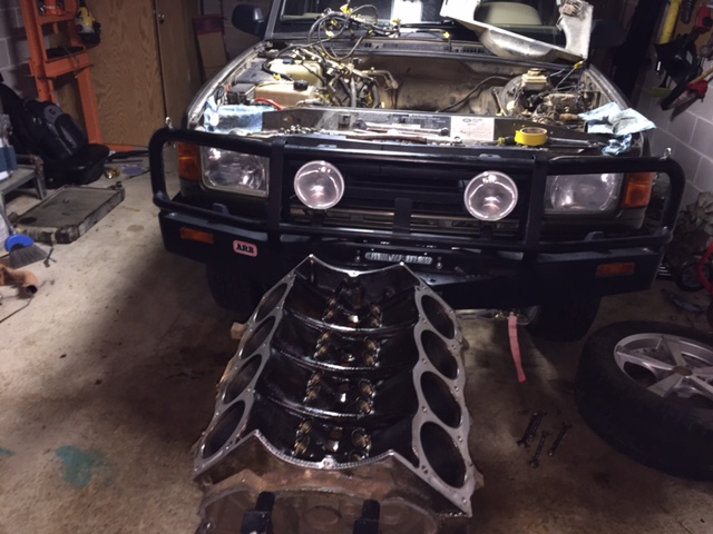

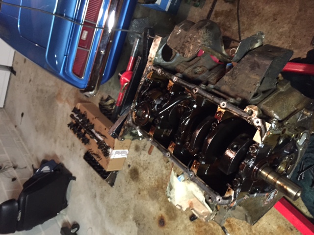

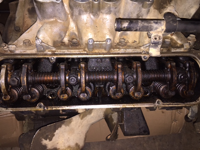

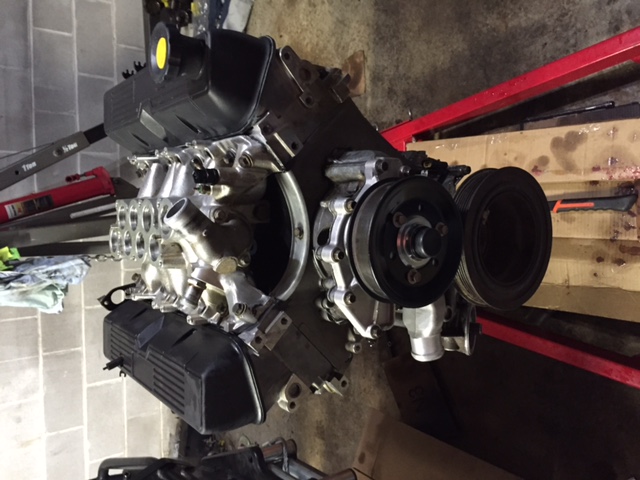

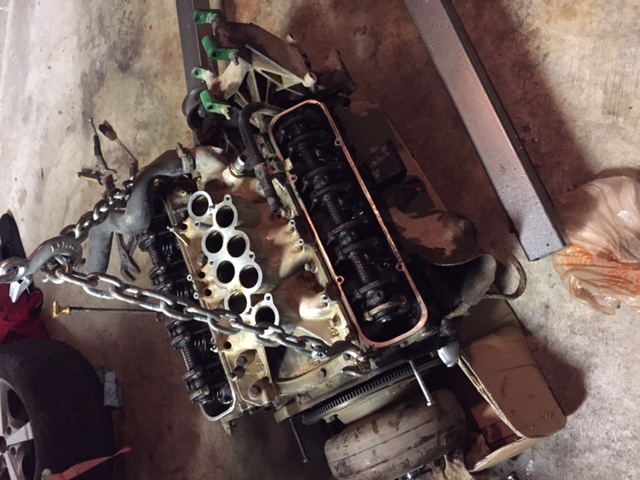

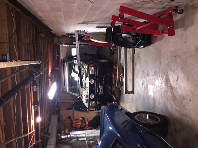

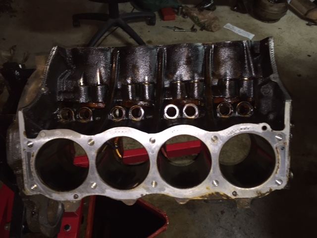

Ha, well went the easier route and am rebuilding the 4.0, and stroking it to 4.6. Head gaskets actually looked fine, and there were no steam cleaned pistons. Engine sludge wasn't too bad for 125k either. Didn't find where the intermittent leak was coming from, but glad to rebuild and stroke it now when I have the time. Here's a list of parts I'm either replacing or adding:
Used 4.6 crank/rods/pistons with new piston rings and rod bolts
New cam, main, and big end rod bearings
New OEM 4.6 camshaft and lifters
All new Gaskets (Felpro)
New oil pump gears
Bosch gen 2 pink top reconditioned fuel injectors
Deleted cats
New water pump
Machine shop work:
Clean and check block and install cam bearings
Hone cylinders
Valve job with new seals
Polish crank
Check rods (still waiting to see if they need regrinding)
Radiator cleaned (rodded if needed)
And yes, I screwed up and pulled the torque converter as well. Was tired and wondering why the flex plate had 10 bolts (doh!). After starting to lift it out, I realized I unbolted the flywheel ring gear instead. Oh well, I have a new oil pump input shaft seal to install before trying to get that converter back in and seated correctly.
Attached Thumbnails Another Vortec swap thread...-rv81.jpg   Another Vortec swap thread...-rv82.jpg   Another Vortec swap thread...-rv83.jpg   Another Vortec swap thread...-rv84.jpg   Another Vortec swap thread...-rv85.jpg
