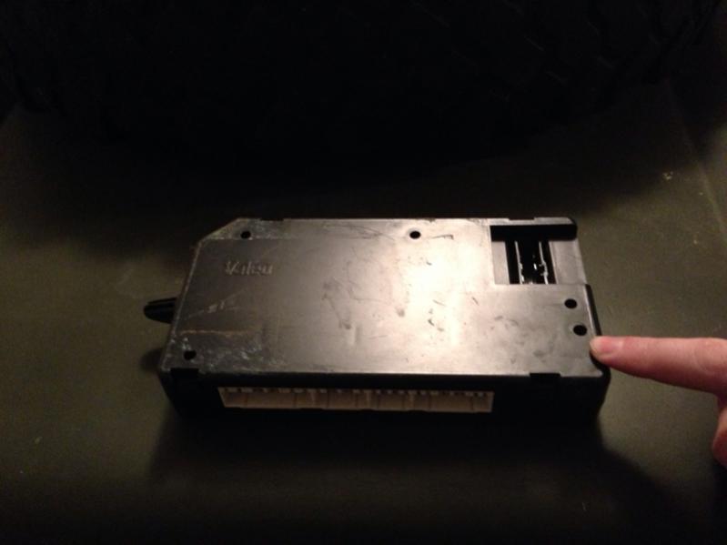

I am trying to replace the keyless entry module on my 2000 Land Rover Discovery. I have the glove box out and the lower panel as well. Where and what does this look like so I can replace it? Need an answer pretty quick as I have the car taken apart.Thanks
You're in the wrong section. This is D1. You should start your own post, not piggy back on another.
Anyway, it's a black box that says Valeo on it.
There is a bolt that goes through where my finger is.
You'll need a special scan tool to sync everything up if you're replacing this part.

I don't see anything like the picture of the box Jafir. No box marked Valeo. Could the anti theft box be anywhere else? The box I bought is supposed to be a direct replacement but nothing looks like it and its a small box. Can you tell me what it may be attached too? Is it somewhere behind the glove box? I appreciate any help you can give.
On a d2 there are about 3-4 computer boxes behind the glove box. If you remove the card board cover under the box you should be able to see all of the electrical harnesses plugged into them.
I don't recall the exact order, but there will be a black metal box with wabco on it. That's the ABS computer. A black plastic box with Valeo. That's the Body Control unit. A silver box mounted to the the body with Bosch on the label. That's the ECU. There could be an ACE computer too, but I've never owned an ace equipped d2 so I don't know what the computer looks like.
Also, i doubt the box you've got will replace the BCU. This box does way too much, from rolling the windows up and down to telling the transmission what gear you're in. It's not just security. There is a security code sent from the BCU to the ECU that will keep the engine from running if not synchronized.
