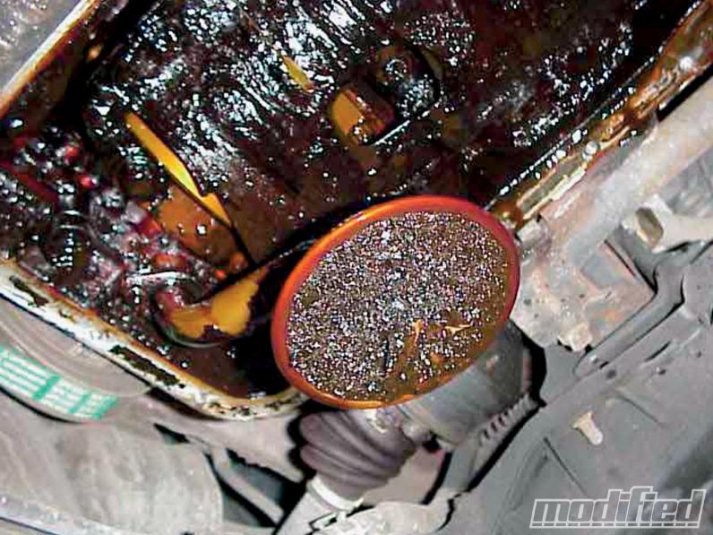

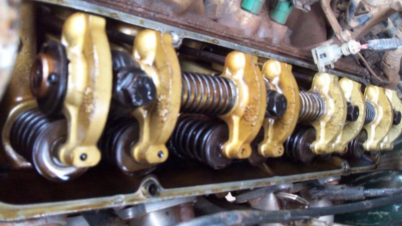

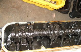

Change filter (first). The 10W vs 15W is not making the difference, the oil heats up and is 40W. Try this filter, Purolator L40316. It is a jumbo filter, holds more oil, and has lower loss media inside. It has been shown to increase oil PSI in write ups by working pro shop mechanics. Changing oil every 5000 miles and filter is a good idea of course. Your oil light should go out in just a few seconds at start up, if not, you could also have a restricted oil cooler, or pickup screen is fuzzed up, pickup tube O-ring shot (sucking wind), etc. These impact the suction side of the pump system. If you don't have time for a pressure test you don't have time to drop oil pan.
Pix shows rocker arms at 190K with Castrol and Rotella, good oil change schedule; and some that "skipped it" this month.
BTW, I have had the pleasure of working for a Civil PE for the last ten years (geotech) who is a Boilermaker, and they turn out some smart dudes. Soak up all you can.
