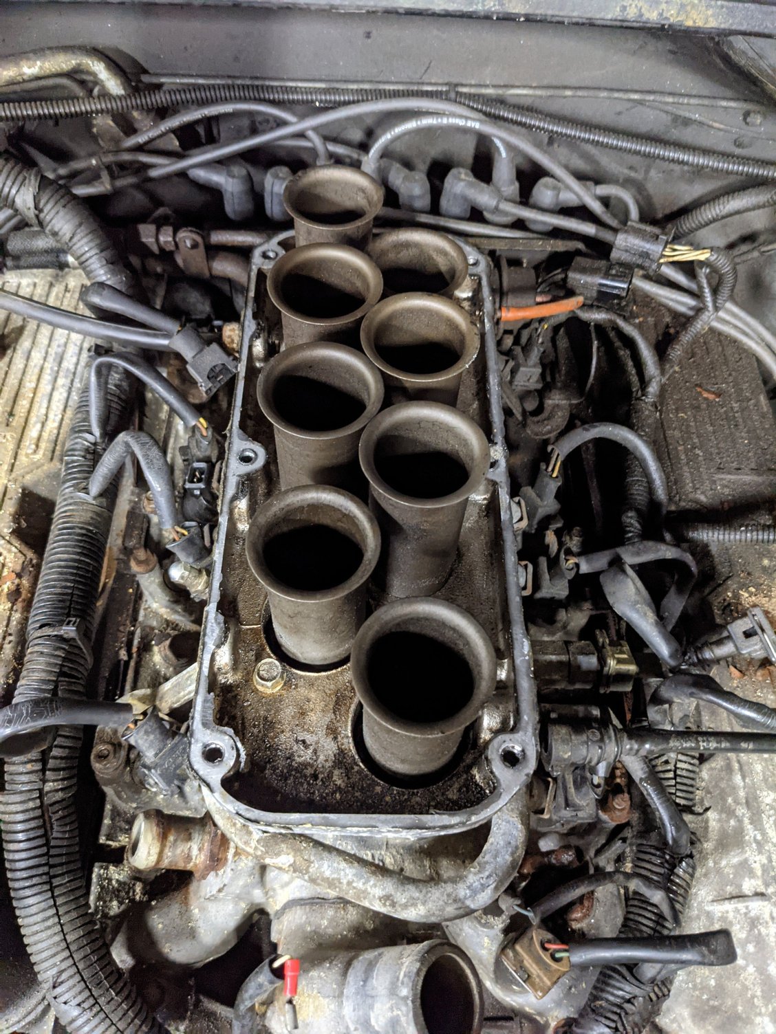

I know it's been discussed at length but I am getting ready to do the head gaskets on the 4.6 in the 99 D1.
I am going with the Victor Reinz gaskets, new hoses, thermostat, kingsborne wires, and plugs. The big thing I'm still back and forth on is stretch bolts or ARP Studs.
I am really leaning towards the studs I like them better from an ease of use stand point and familiarity with that style of set up. I of course have read the horror stories people have posted as well. In my experience they are a solid option especially when you do the prep work with chasing the threads in the block, cleaning them out etc.
So what is your experience?
