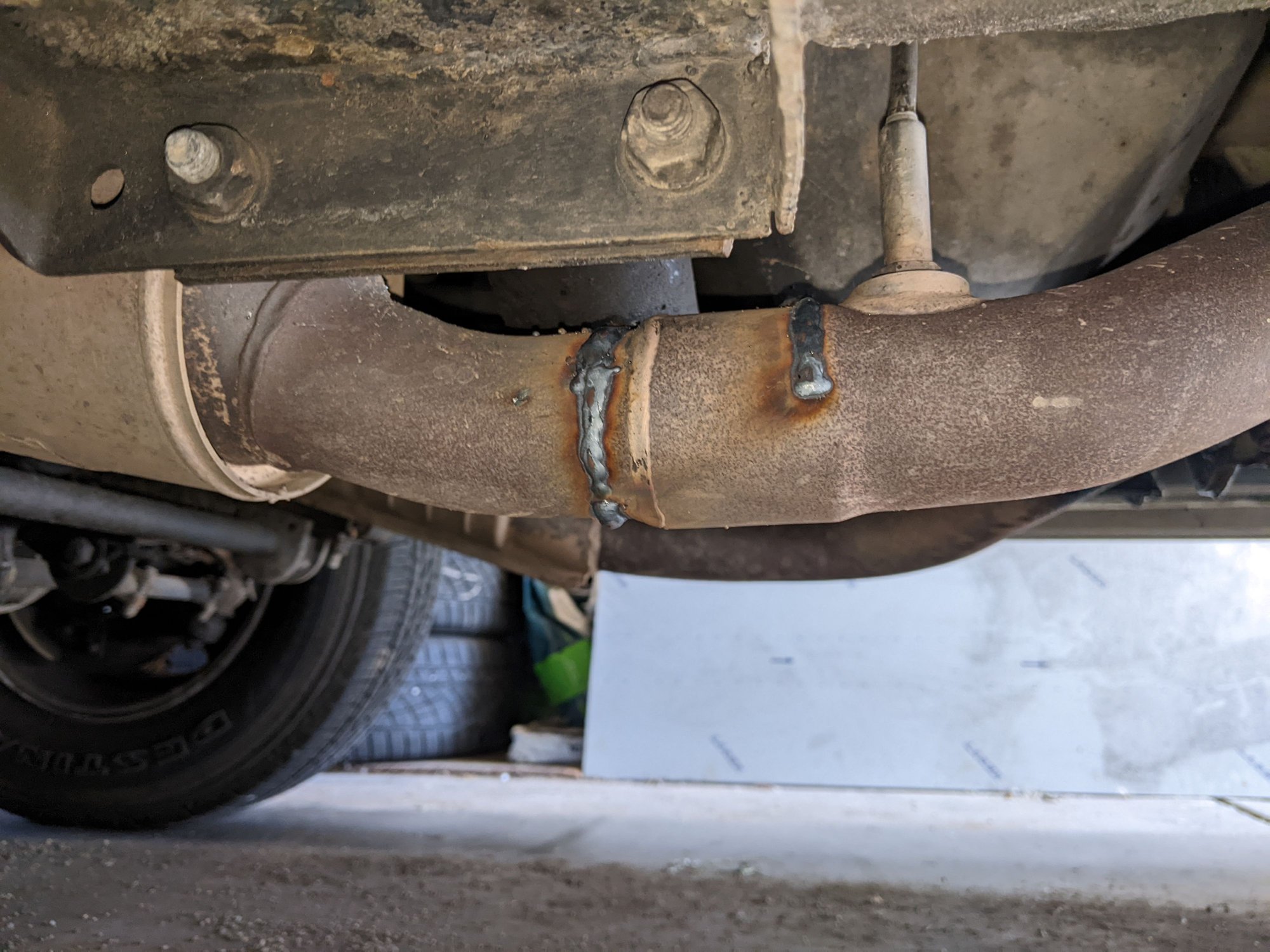

Someone attempted to steal one of my catalytic converters last night. We stopped at Yard House prior to attending a concert at Red Rocks and the attempt was made in the parking lot. Upon starting old Indy, it was apparent something was amiss from the exhaust noise.
This will have to be a complete replacement. Any ideas where to find one?

Could this potentially be welded back together? If so, any leads on good welders in the Northern Colorado area are appreciated.

i would think any exhaust shop could weld that back together.

Cat theft is absolutely insane in Calirado. The fb forum here is full of postings like this. And because lawmakers quietly passed CARB laws you'll spend about $2500 for a new y-pipe. Welding is the way to go in this case.

If you need to drive, auto parts stores have sleeves you could clamp over to get you by, or patches to wrap on that harden with heat. I'm sure the muffler shops know the best way to deal with it. Sorry to say I bet they see a lot of this with the high price for platinum and the low price for meth.

I have an appointment at Boulder Muffler next week to have it welded. They get great reviews and there are multiple comments from reviewers that had this same issue and they successfully welded the exhaust back together.

Easy weld job.
Did you get it taken care of?

It's going in for the repair on Thursday.

Old Indy has been repaired and is nice and quiet again.
