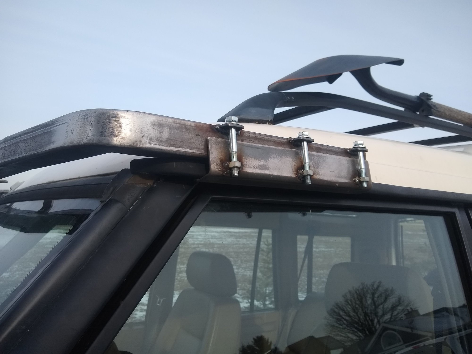

Old Jan 3, 2021 | 12:20 PM
WeekendWarriors87's Avatar
Joined: Aug 2018
Posts: 171
Likes: 16
From: Canada
You might be able to make something that will work. Here is a light bar I have been making for mine because I didnt want to spend the cash on a roof rack I didnt need. But I certainly wouldnt mount anything to just one side. You could probably get away with making your own bars in the style of the Thule cross bars.
