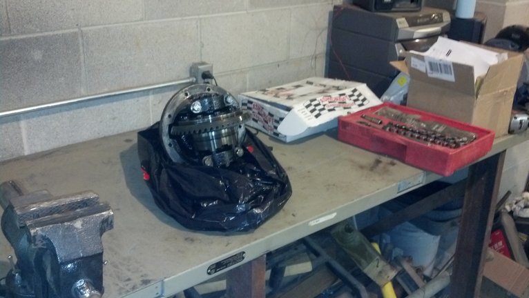

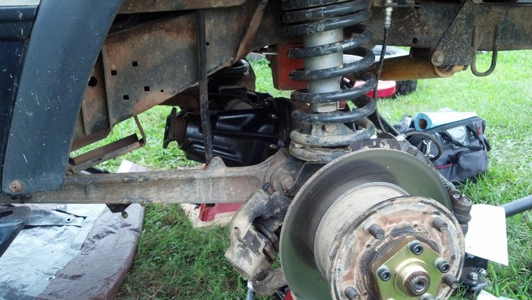

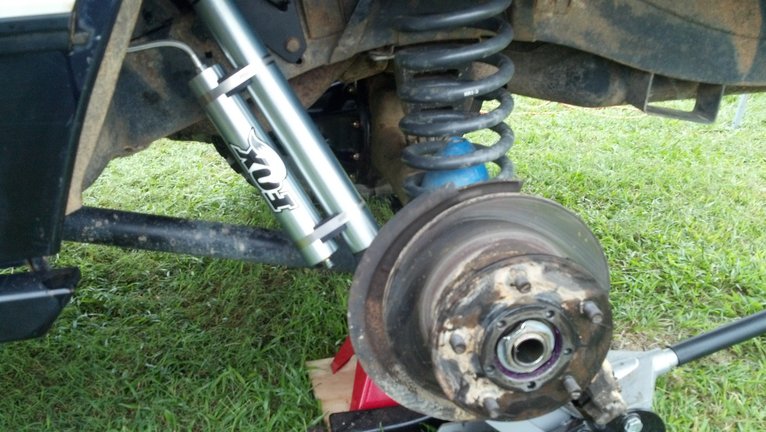

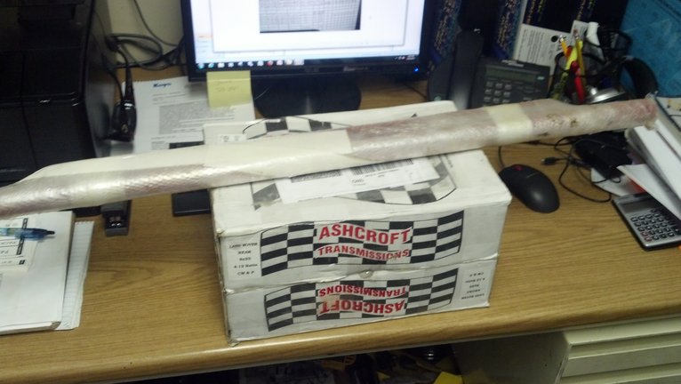

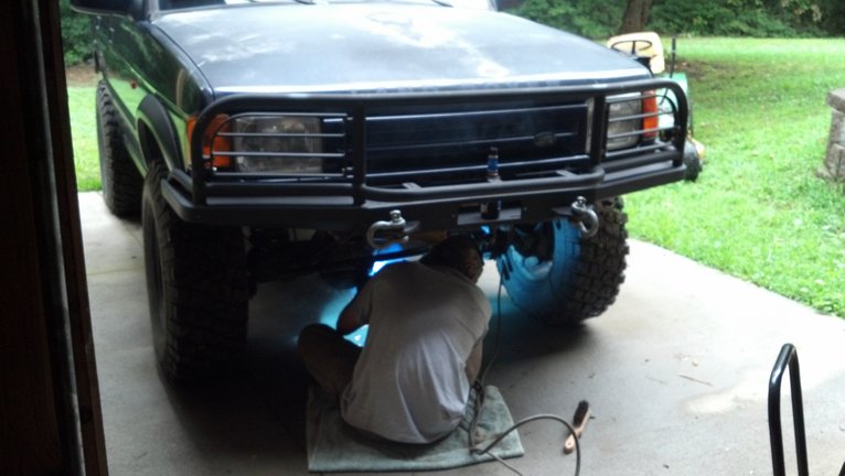

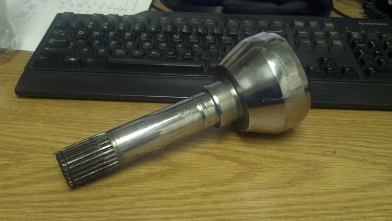

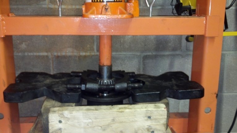

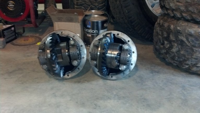

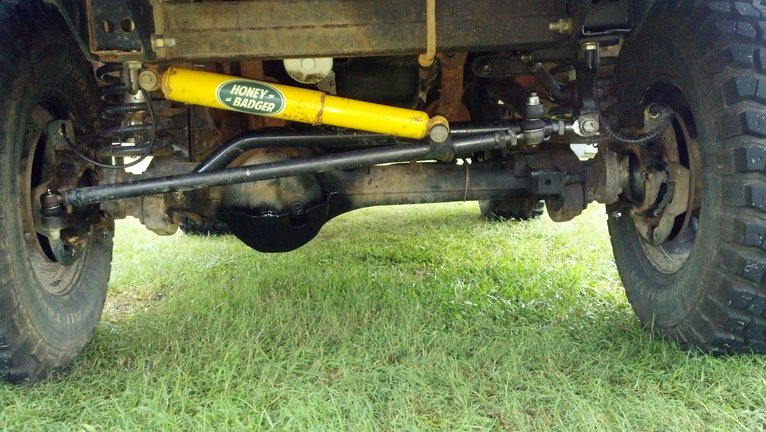

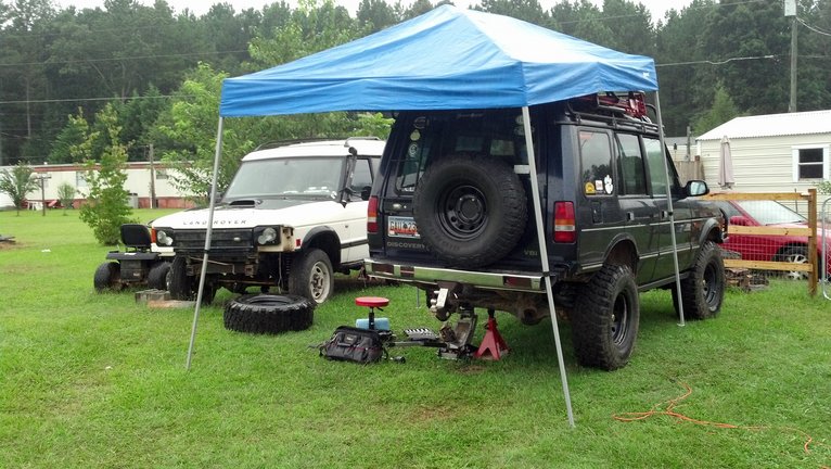

Well this weekend has been a big one for the Rover. Through a couple of parts trucks I acquired a Detroit and a TrueTrac, axles and gears. Along with the gears I installed RoverTracks front axles and CVs and Ashcroft rear axles. I also picked up some Fox 2.0 12" remote reservoirs valved in 90/100. I modified my RTE upper mounts to gain an extra inch. Starting Thursday I pulled my rear diff. Friday I rebuilt them with the help of a buddy with Ashcroft 4.12s and all new Timken bearings. Saturday I replaced all the wheel bearings and buttoned up the rear and pulled the front apart. Today I finished up the front and threw on an RTE weld on diff guard. All of this other than the diff rebuild was done in off and on again rain under a pop up tent with a tarp in the yard. Needless to say I am worn out but thrilled with the results. Never thought I'd have the Disco where it is now!
