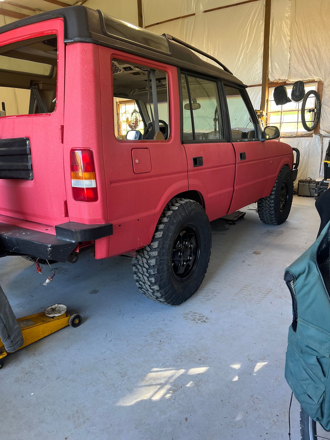

Needing some advice here. The drivers side floor pans have been an ABSOLUTE pain to continue and finish off getting welded in. I did move the vehicle just down the road to get gas a couple months back. I had a bit of the floor pans still out. I could see this rod just below my feet jumping and moving, felt like a flat spot in the tires, but it was what I believe was maybe a panhard bar? Just below my feet. Moving up and down.
I am $4200 total into this project. Since it’s my first go at welding and the angles are horribly painful to weld at, the floor is pretty botched lol. But, I am going to fill in the small gaps with some bondo, sand and paint it, and then put vinyl flooring in since it’ll be an offroad vehicle. After I moved her, she got angry and sprung about 45 leaks in my garage. The next thing I need to do is find a guide on removing the dash. The one in the “workshop” manual here seems like a horribly long process. Anyone have any ideas?
Thanks guys. I will post updates soon. I’d like to get one half of the vehicle floors and seats done so I can start slowly driving it around town too, so I’m going to cut vinyl into the right shape to fit the floorboard. Any recommendations on cheap, accessible vinyl would be awesome. And properly removing the dash. The RAVE manual just can’t be the easiest way haha.
Also, what are the widest readily available fender flares? Those need to go on next so I can move it without tearing off the fenders and start figuring out if there are any major mechanical issues. But right now I can’t move it unless it’s in a straight line because the tires are too big.
