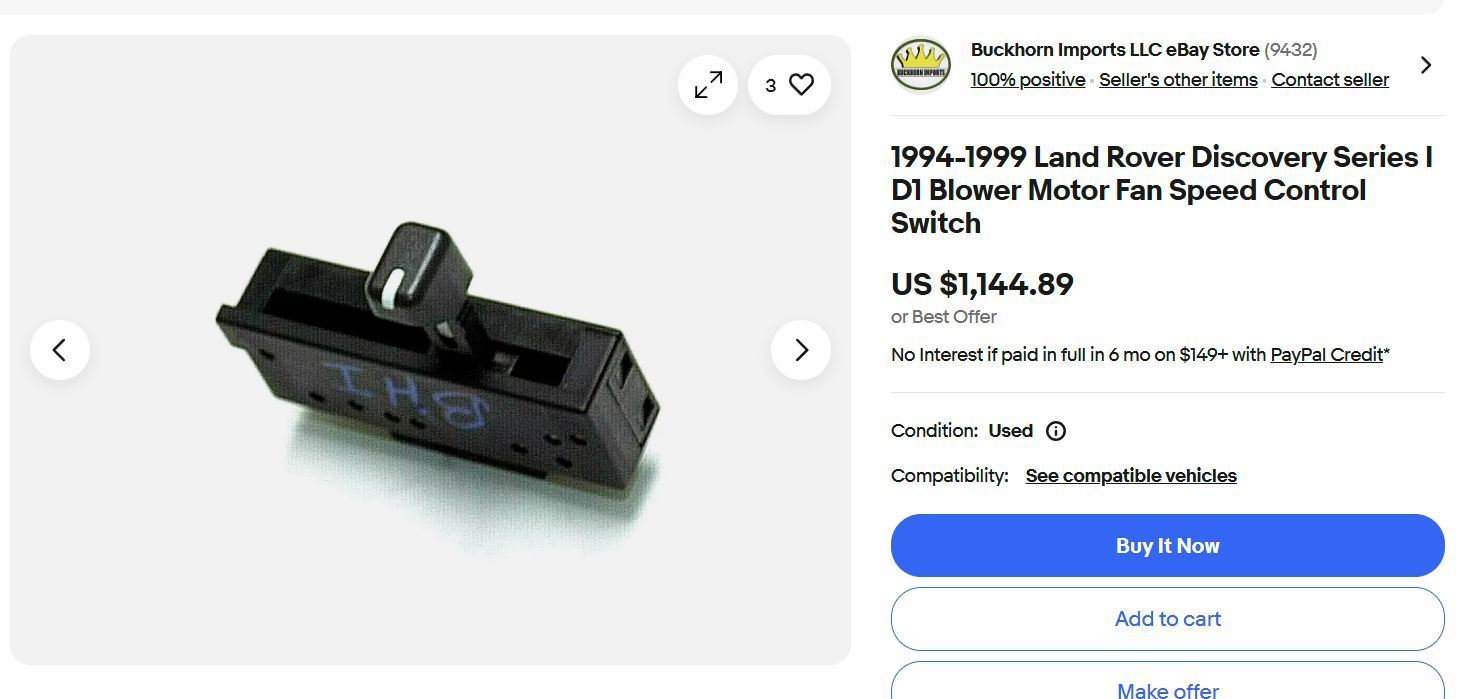

the HVAC fan switch is what your soaking not the wire connector attached to the wiring harness. the switch will need to be removed from the HVAC housing first - comes out the back. And yes your will carefully disassemble the switch to get to the inners b/c soaking them will not be enough, you will likely need to scrub too- - attached is a pic of the switch... (and the person is clearly very high if they want that much $$ for it)

These must be specially made from some of that rare "unobtanium" I used to get them for about $20 used and clean them myself. You do have to be careful to keep track of the springs inside.
i guarantee you there are millions off other cars that fit. Like those Lamborghini flashers that were made by ford you could buy for $15 a set on eBay or pay for the ones that had ford and Lamborghini on them in fine print for $8500

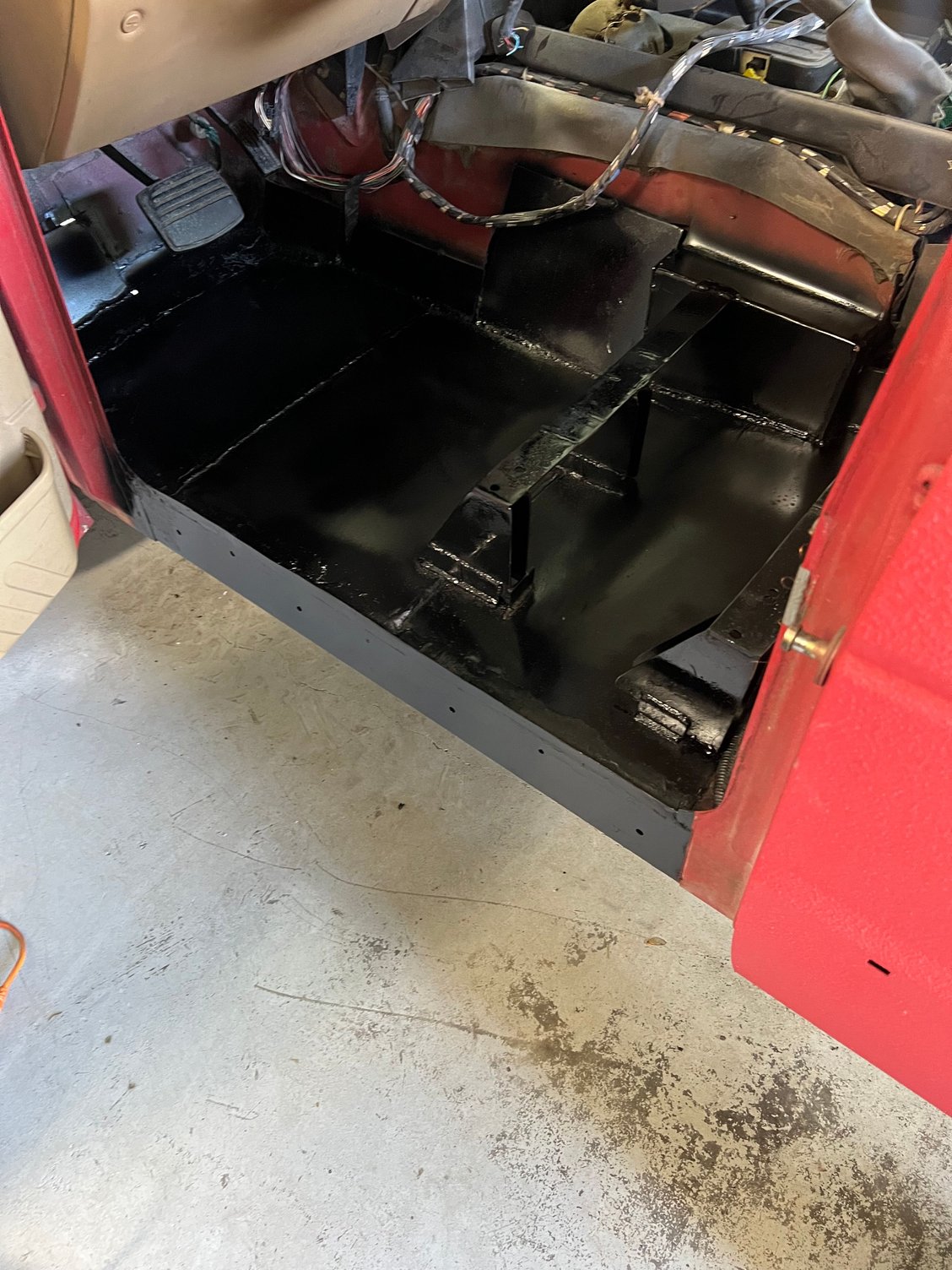

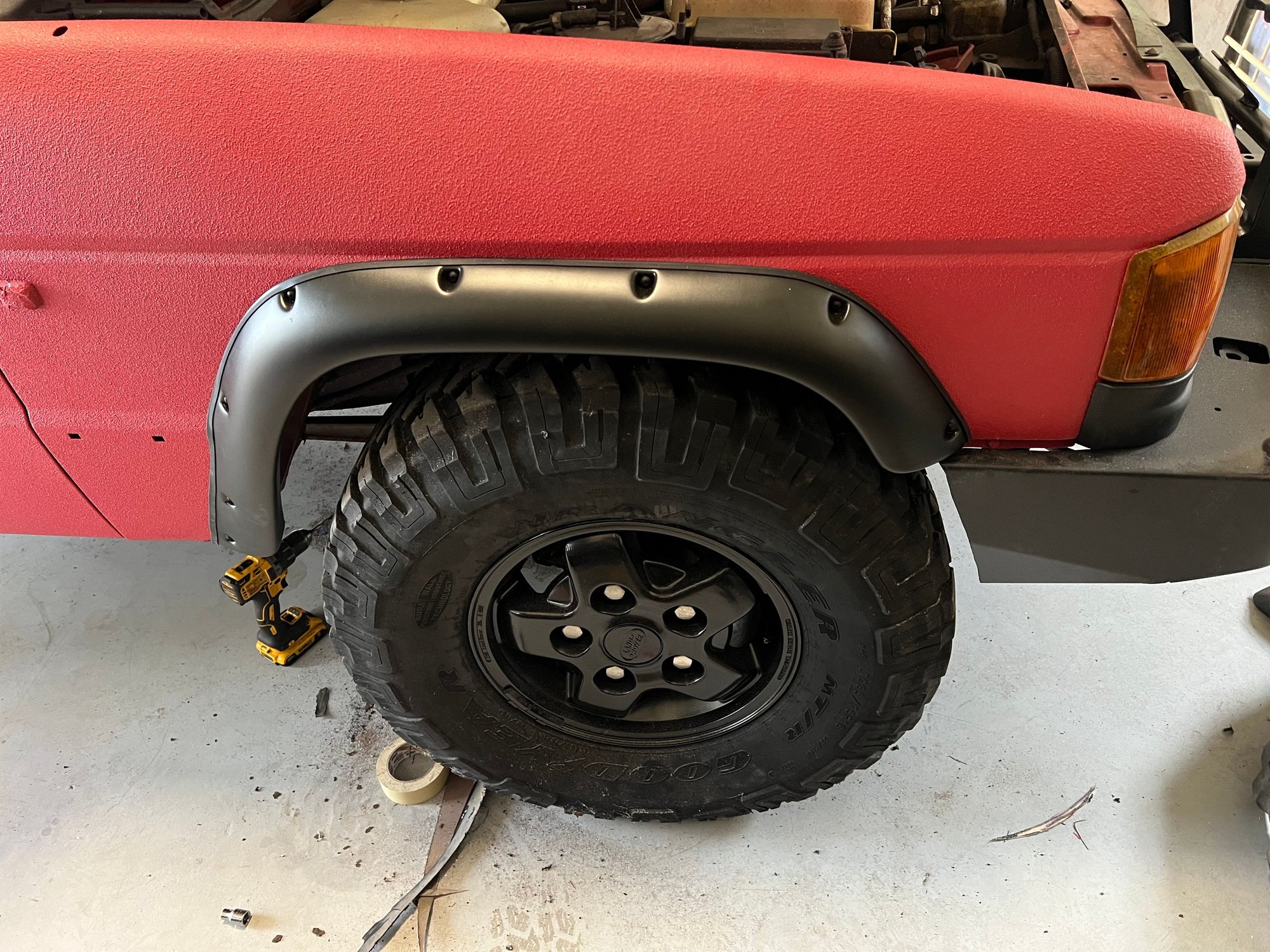

Rear seats in.
Fear hatch floor fixed.
Front fender flares on.
Bouncing down the road problem identified. It’s the strut bushings. They are literally gone. Attached in the video.
