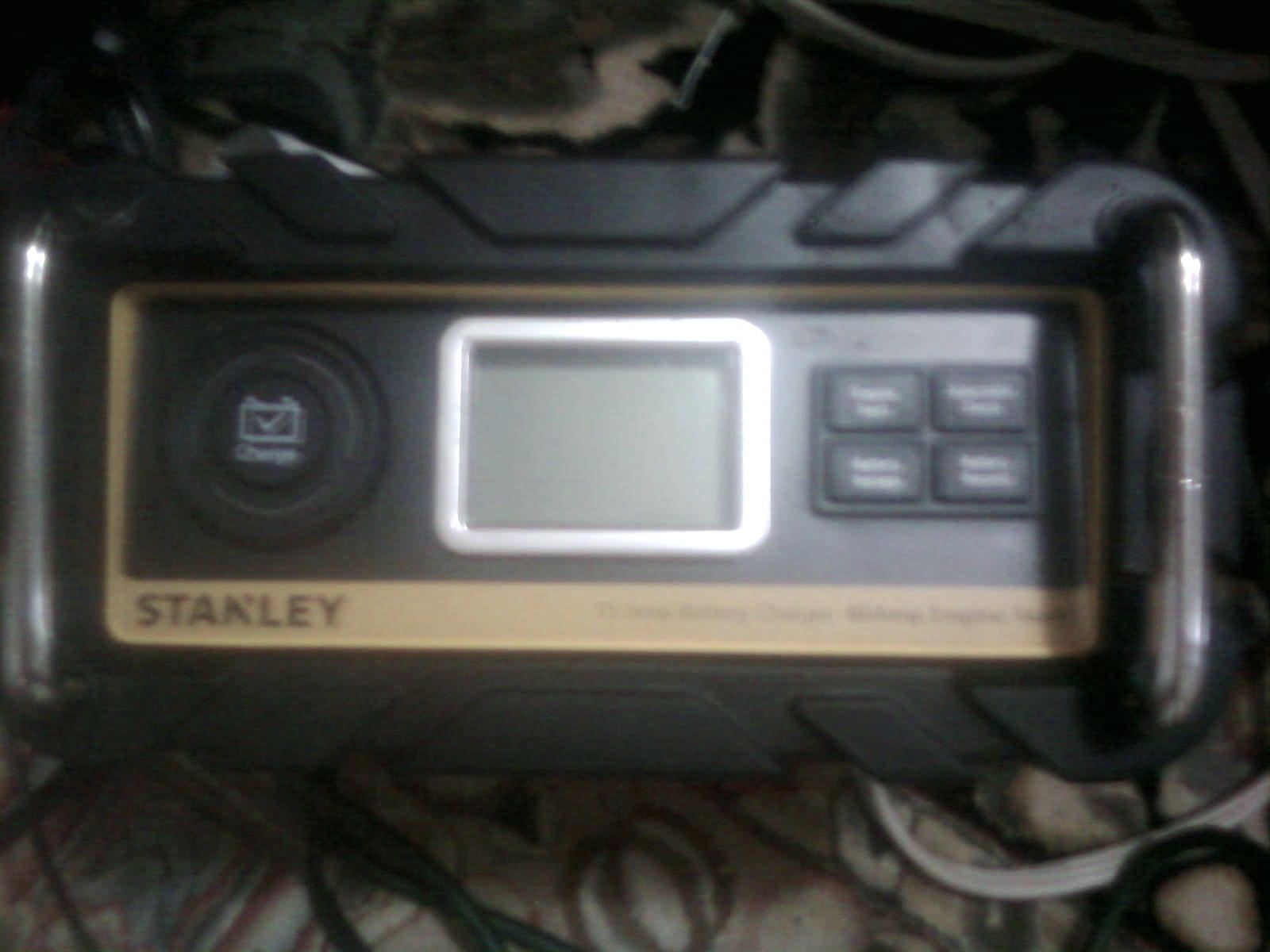

The truck is fine. Battery now reads full after 2 mile treks to 30 mile treks. I have read it this morning when truck is on and then off.
On readings are Battery 14.5-14.6
Alternator 13.8-14.6
Off Reading are Battery 14.6
Alternator 4.9
Does this make sense? I have shown pic of Stanley reader to assist you. Thanks rover guys.
