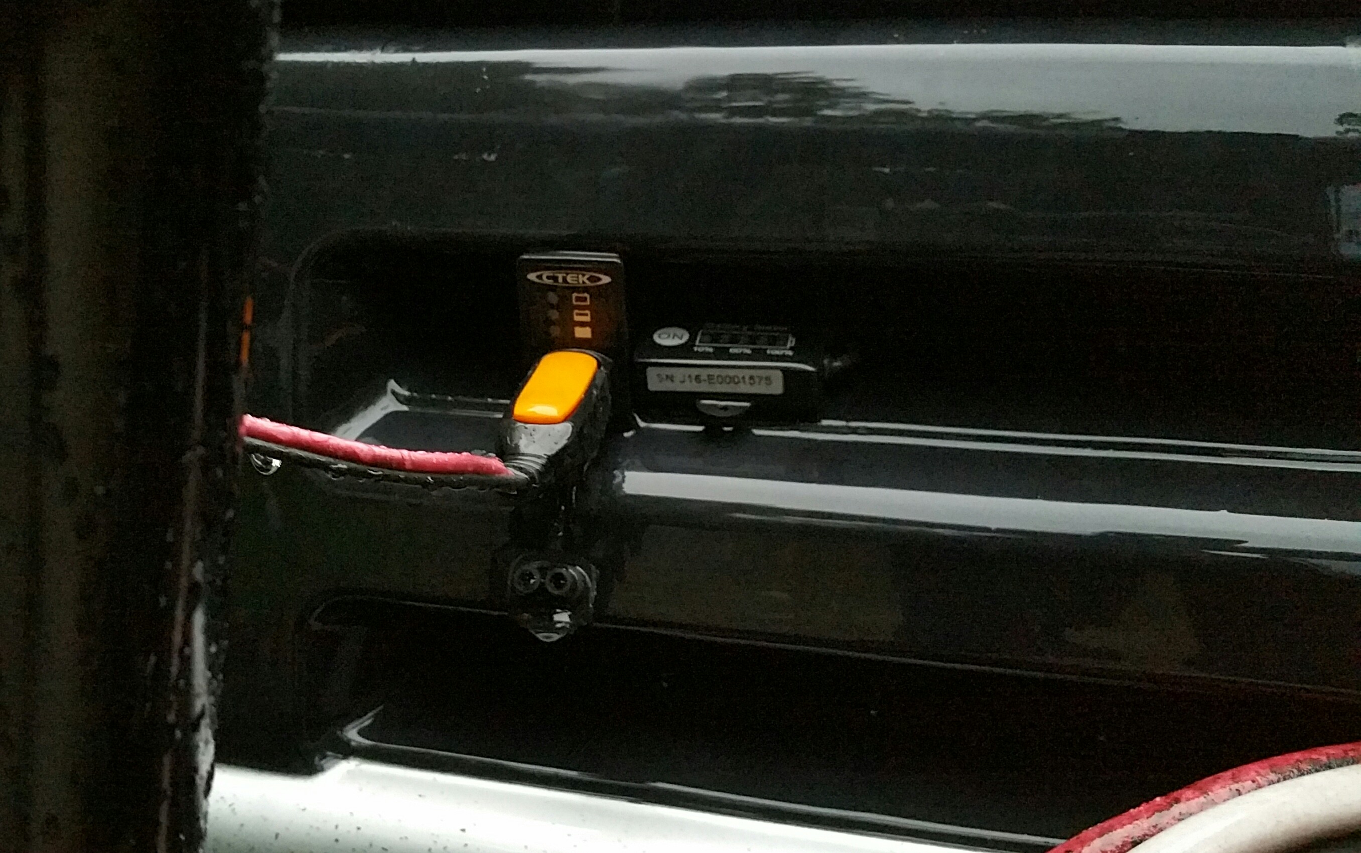

I use a CTEK Comfort Indicator Panel that is connected directly to the battery and mounted in the grill for quick access. The LEDs alert you on the battery level.

Nice having the charge indicator. Does it stay illuminated all the time? I guess if you have the +/- ends attached to the battery and the panel end coming out of your bumper it would be illuminated all the time?
