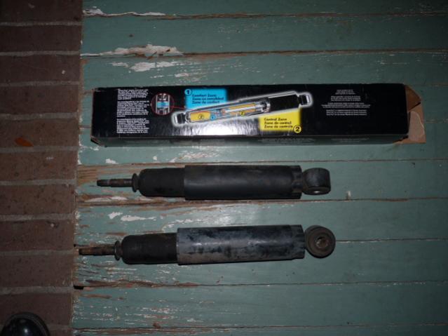

With all your plans, the stock rear shocks will soon be out of there. Here is a photo of ones I swapped out last night (97, 172K, original I guess). Note how much shorter they are than the box the new ones came in. With the shipping retaining strap off, the new ones seemed almost a foot longer. My 97 Disco weighs 800 pounds more than my F250, so I guess these shocks can get quite a work out. The ride quality improved quite a bit.
