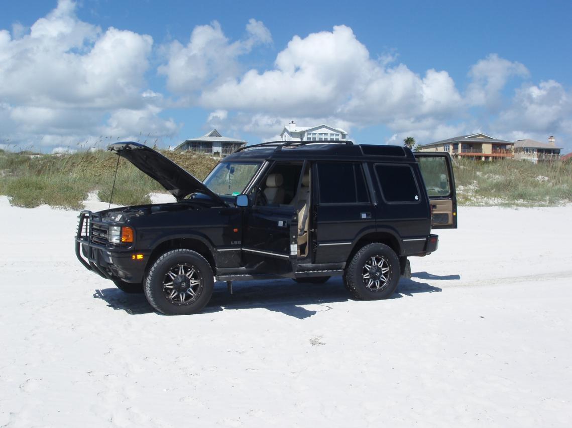

and here she sits...

Looks like a nice truck........ Sucks to have a black truck in that FL heat though heh
in the pic it appears to be on top of the sand, just letting it move in idle didnt help ya any?

just to the right of where I sit is the drive zone, the sand is like powder. Growing up this was my beach but we were allowed to drive both directions and closer to water in the hard pack. now its one way, up high close to the dunes and to answer your question, no. it would not idle thru it. I've driven this beach in Isuzu troopers, jeep cj's, Suzuki sidekicks, and F150 4x4 supercrew and never had I have one just refuse to go thur it. The disco would immediately start to dig in and bury. I thought for sure the "all wheel drive would be more than enough to go thru it but boy was I wrong.
