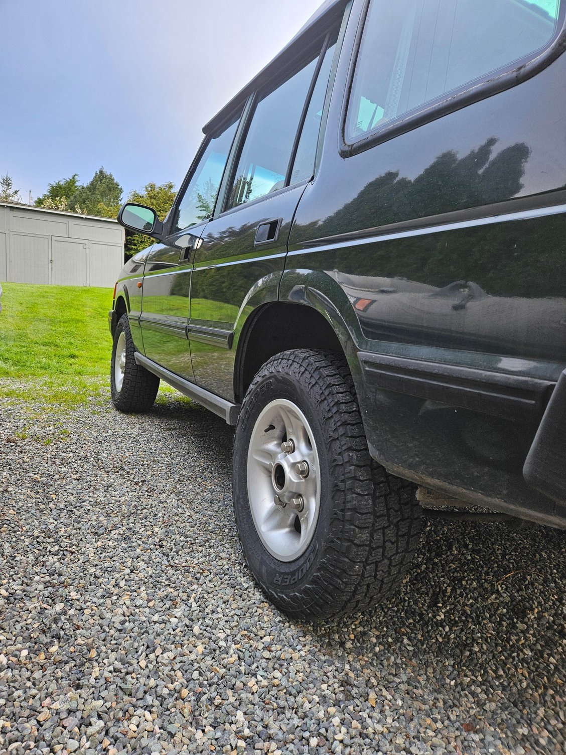

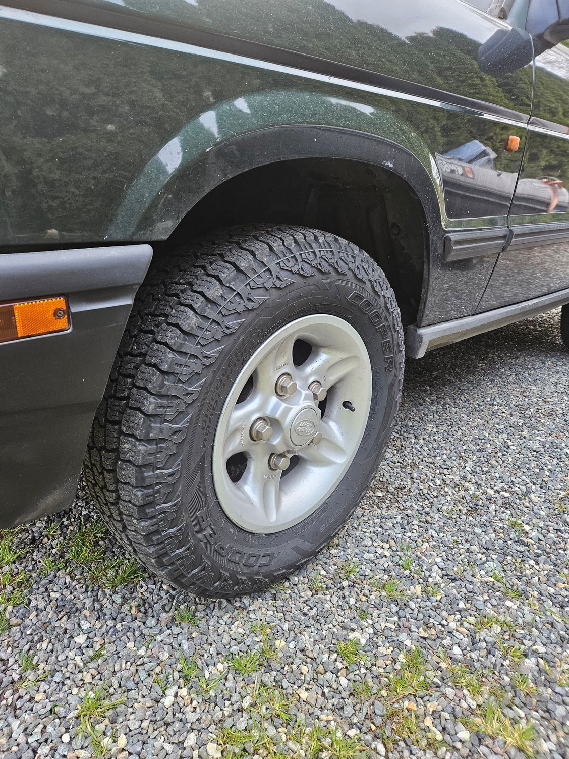

I bought the Cooper Discoverer road and trail 235/70R16 we will see how they work
Post up some photos
Old Apr 13, 2026 | 10:05 AM
denverdisco1's Avatar
Joined: Sep 2013
Posts: 63
Likes: 7
From: Anacortes Washington
I have not had them offroad yet, I did launch my boat at low tide is some slippery mud and it pulled out fine just in AWD. Looking forward to getting out on the dirt.
Old Apr 20, 2026 | 09:02 PM
stillruns's Avatar
Joined: Mar 2016
Posts: 1,995
Likes: 403
From: Bham
Great looking tire!
