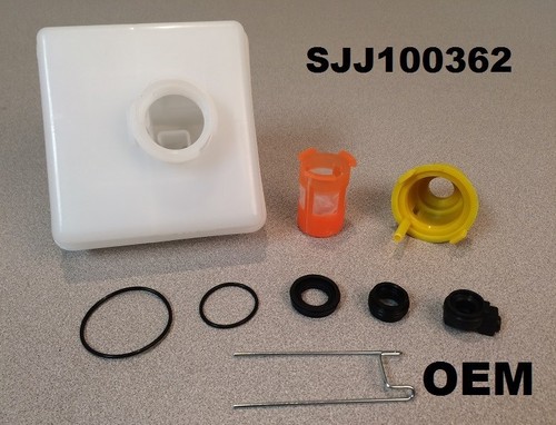

I am thinking the master cylinder is the culprit and leaking on the ground (or should I say snow)
Inspect beneath the reservoir for leaks. The reservoir seals are known to leak after the years and leak faster in cold weather. I needed to replace mine last year. Rebuild kits are relatively inexpensive and often no need to use all the included parts. https://www.ebay.com/itm/LAND-ROVER-....c100677.m4598

Decided to go with a complete Master Cylinder. I only want to do this once, and it is supposed to be somewhat warmer next week. only in the lower 40's...

Got the master cylinder. The cost for a complete Master Cylinder was only about $25 more than the rebuild kit for the seals. I figured running it dry a few times probably wasn't good for the internals, and the fact that it is getting a bit long in the tooth, could be the best way to go. Now waiting for a bit warmer weather, say above 30 degrees to install it.
